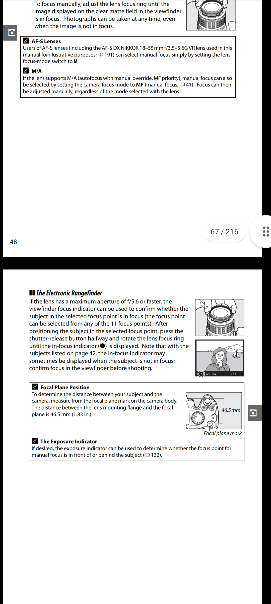

Page 12 of manual down load here https://downloadcenter.nikonimglib.com/en/products/18/D3000.html

Maybe one more option if your lens is not AF-S (still a supper fine lens). You could manual focus using the indicator in the camera. This will get you going for a bit. I checked your manual to be sure this would be a valid option.
Maybe the Ken Rockwell suggestion was all you needed.
