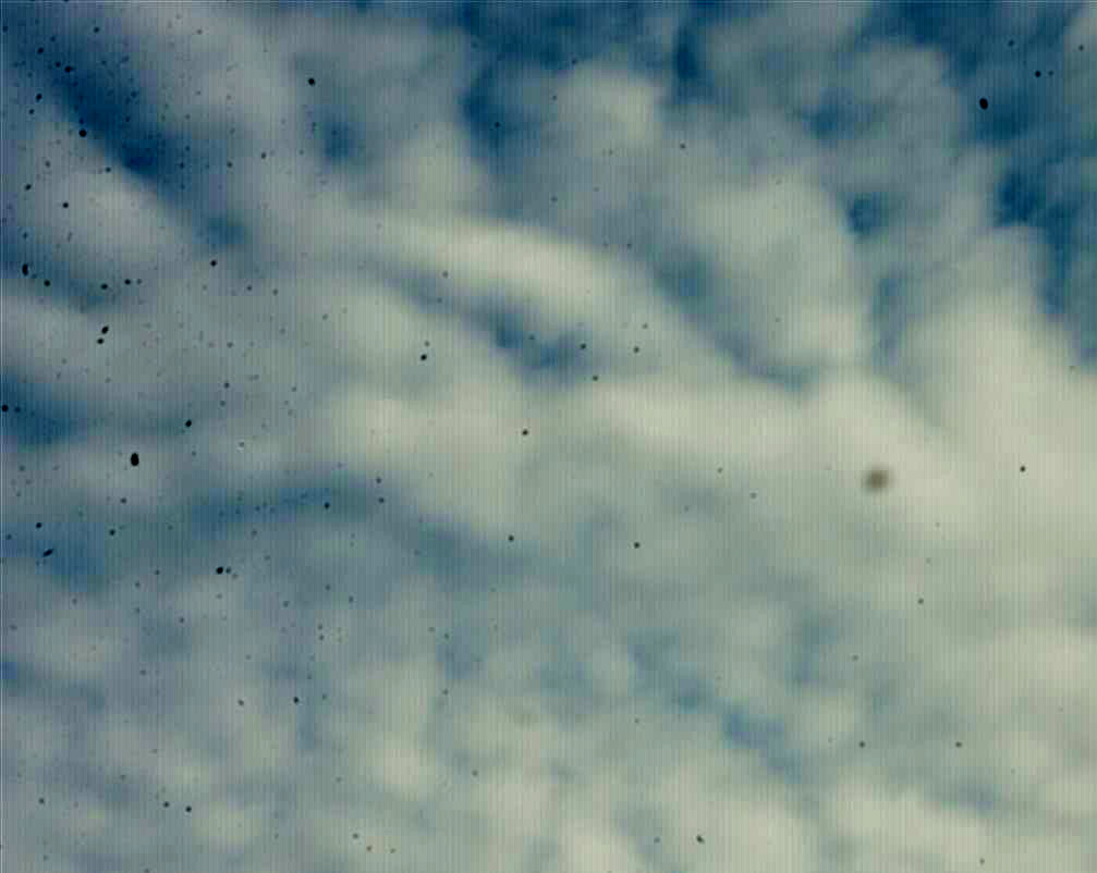

Hello people,
So I just bought Nikon D3 a few days back, sadly I didn't thiught it will be so defected! First of all it has only 25k actuations, but the body and rubbers are some in rough some in decent shape, kind'a weird for 25k shutter count... Anyway the sensor or something is causing high issie, very hard banding, almost like a notebook linear stuff or something! Last day I did upgrade firmware of it to 2.03 and then formatted my cards and the lines were gone for a day, I did like 200 photos and all was great, then I went to sleep, woke up and thought I'll test it again and woah it shows the lines again! I have no idea what happened through night, I checked everything what I could to check on my own hands and nothing seems to fix the problem anymore... I hope to get some help here, maybe somebody encountered such problem? I'll add a picture of how the linear pattern looks (zoom on it and You'll see)
https://ibb.co/b7V5oa
mikew_RIP
Welcome to the forum,first thing is you need a sensor clean,this is 25% of the image with levels adjusted to make it clear what your talking about,are you sure it went away and it wasn't just you taking different subjects,i know nothing about the D3 sensor so i will just put this on for others to see.
I had to do extreme adj to get this

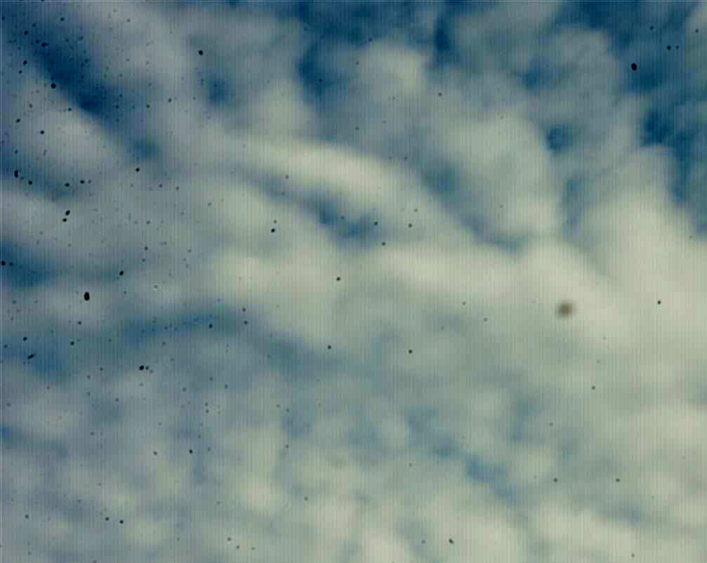

Sitkus
Hey Mike,
Thanks! Also yeah I know I need a clean hehe, however I took it today to a local photography gear repair service, they said first they look for this problem and if they can fix it only then they would clean the sensor, otherwise it's pointless to clean if I won't be able to get this camera fixed...
Yes I'm 200% sure the issue was gone for one day, I took pictures of sky ant white boards as well, to make sure it was true, I was very happy that I fixed it, but not for long... And before I fixed it I was getting those 'lines' only at high F numbers, on F 2.8 or something there was none, after the issue re-appeared I'm getting same lines at no matter what F number I'm shooting, and this is even more weird...
Thanks for the adjusted picture, I think it is even better seen now, also You took up the dusts, so thanks for that too!
I'm writing here in hope to get some help from people who had same issue or who thinks they know what it could be, so I could warn the repair-guy on what might be possibly solution. So thanks a lot for any help!! :)

Hey Mike!
Thanks for the help as always, however those issues written there seems not like mine, those are made out of noise I guess and mine is presenting always, no matter shadiw areas or bright areas, it's like adding a pattern of lines in photoshop with low opacity hah...
