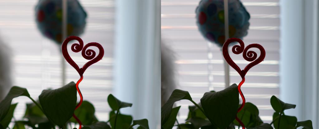

Ok....after writing that I just did another series of tests as I was going to test fewer focus points. Since it is daylight now I had opportunity to test samples against bright backgrounds (livingroom window with daylight) and it actually was working fine (!!!). Then I thought ok it is a low light issue. So I went into the kitchen with the lights out and shot a few dimly lit objects at high ISO (so camera shake isn't a factor), and I was shooting f/1.4 and it was locking onto very small objects in the frame without problem. :confused-new: I tried different ISOs just to be sure. I would be watching where the focus points fall on the viewfinder, and it locks on precisely....regardless of whether I shoot 1.4 or 2.8. Man, my camera is possessed or something? I'll have to try shooting again this evening. But I was shooting at like 6400 ISO with 1/8th second exposures in the kitchen and it was still locking on where I saw it locking on. When I was on my first shoot with the lens on Thursday I kept it at f/2.8 of course so I have no idea what happened between when I first reported this and today. But I'll keep an eye on it. But my goodness, when it works, what it can do with selecting part of a subject, no matter how small, and rendering it within such a narrow depth of field....wow.

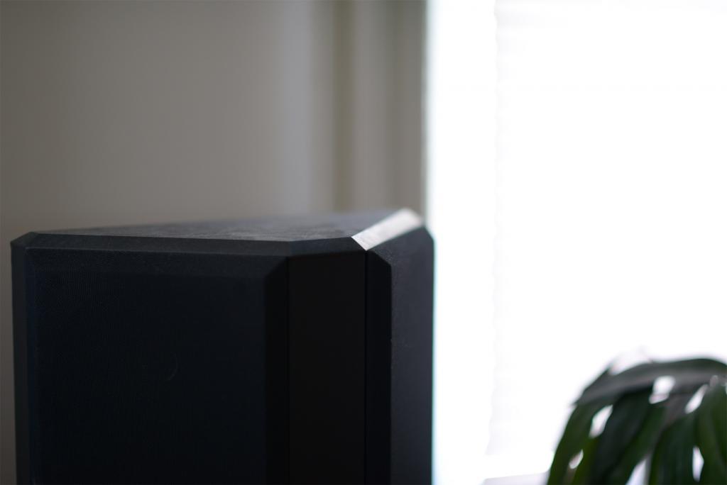

Ok here are examples of test shots I completed a moment ago.
In this image the corner of the speaker was selected and boom!

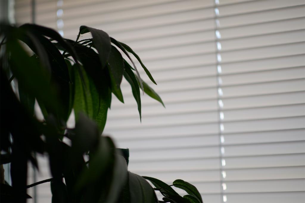

So I tried something more complex like these leaves. The center leaf was selected.

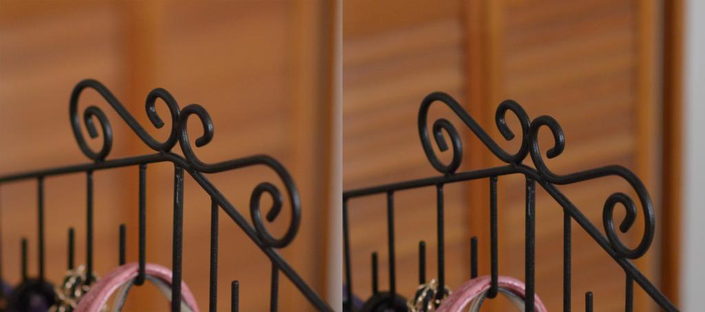

Here's a comparison with f/1.4 on the left and f/2.8 on the right. And although softer at f/1.4 as to be expected, it is still in focus. (the comparisons belows are crops of the original images)
So then I thought ok I should go in dimmer light conditions, but again, no problem. Again f/1.4 on the left and f/2.8 on the right.

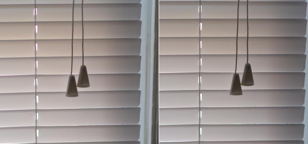

And back to brighter light. f/1.4 left, f/2.8 right.
Huh. No problem.

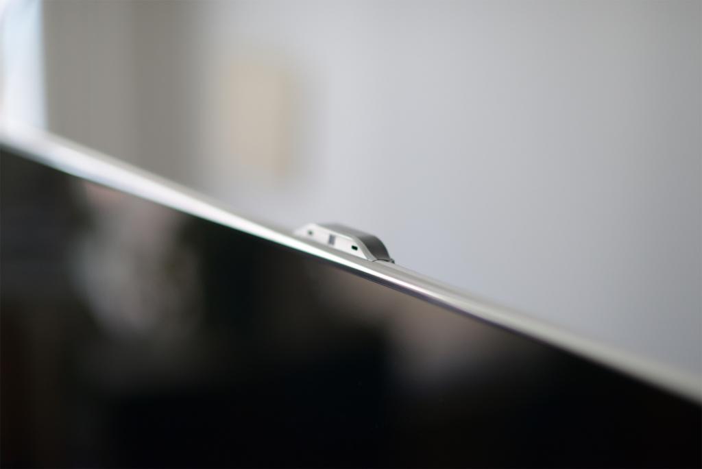

Here's an illustration at f/1.4 that blew me away. The focus indicator fell exactly on the front section of the little raised camera of my TV, exactly as I saw it in the viewfinder, and there it is in the photo. I think this photo illustrates just how demanding it is for the autofocus system to deal with a lens like this. I can't imagine the Canon f/1.2 lens. Wow.
So now all I can do is keep testing and see if it comes up again.
The only possibility that comes to mind at this point is that the camera itself had to "learn" the lens.

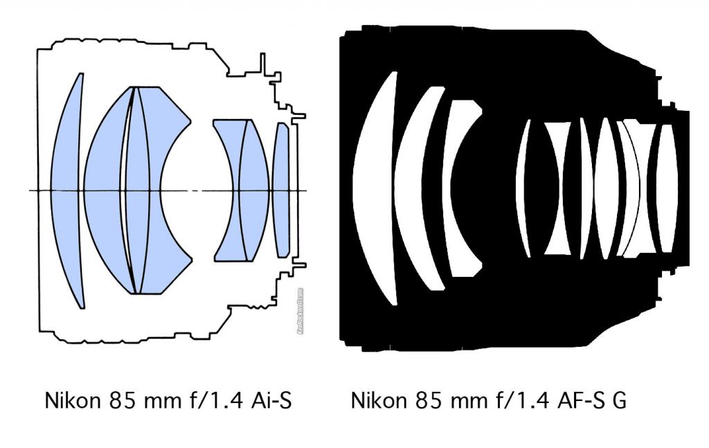

I can't speak for this particular lens but I will show you what a manual focus 85mm f/1.4 AIS Nikkor does on a D700. It is so sharp you have to wear leather gloves to keep from cutting yourself! I am pretty sure Nikon did not change the optical formula of this superlative lens when they went from AIS to AF
That is a beautiful photo illustrating the capability of the AIS lens and how it stands up even today.
I was curious about what exactly did change, if anything, in the optical formula, so I did some digging and made a cutaway comparison of the AIS lens on the left and the G lens on the right (and actually scaled them based on the size of the bayonet mount). The AIS lens has 7 elements in 5 groups, the G lens has 10 elements in 9 groups.

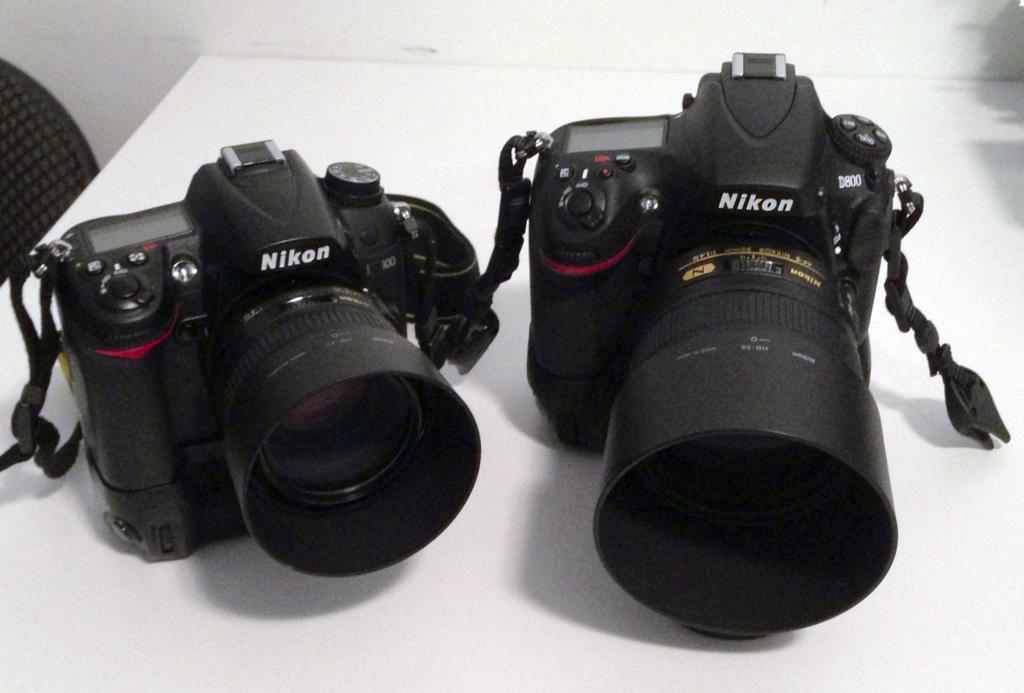

Equipment family photo taken with iphone....both setups achieving basically the same capability in terms of reach and light gathering power...50 mm 1.4 G on left with the D7000, 85 mm 1.4 G on the right with the D800.
