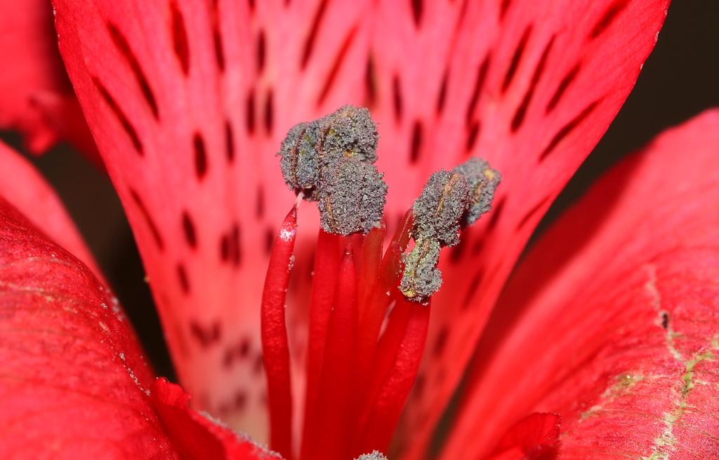

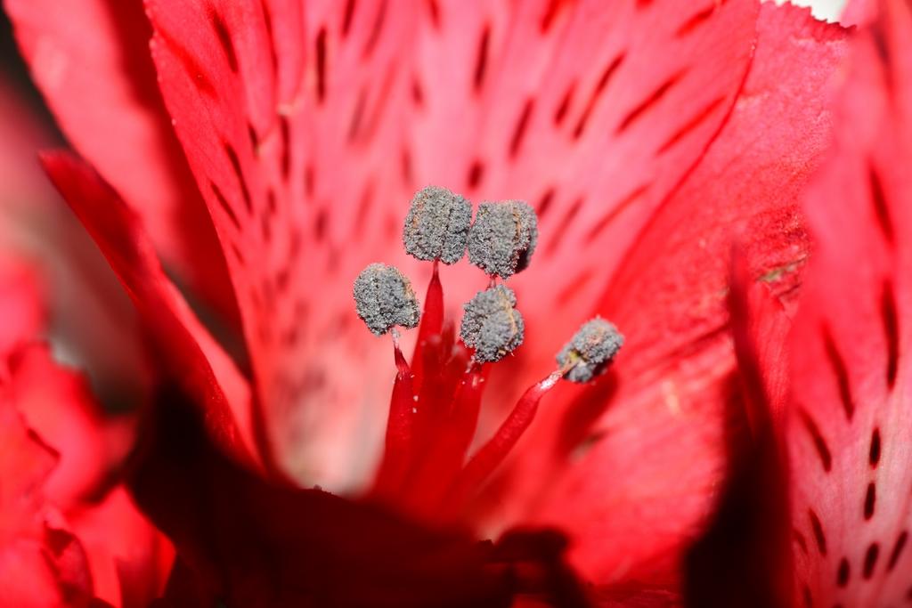

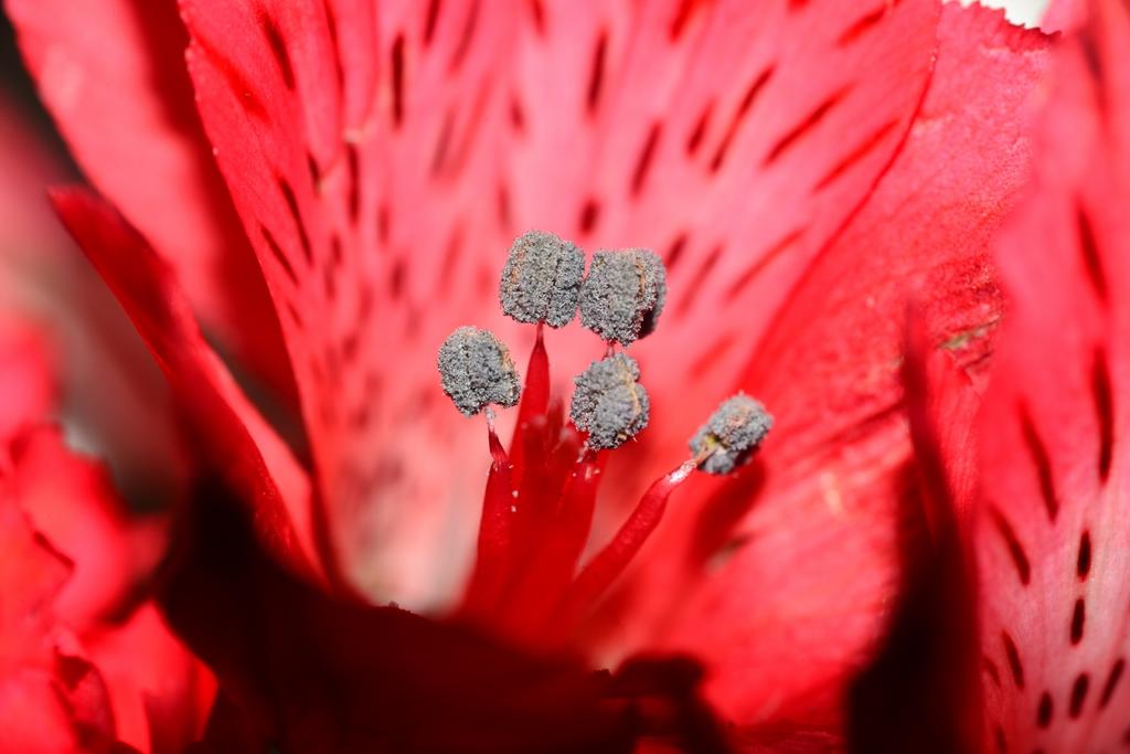

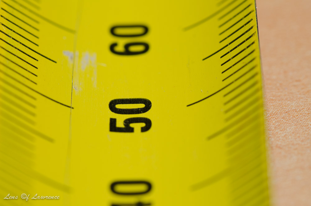

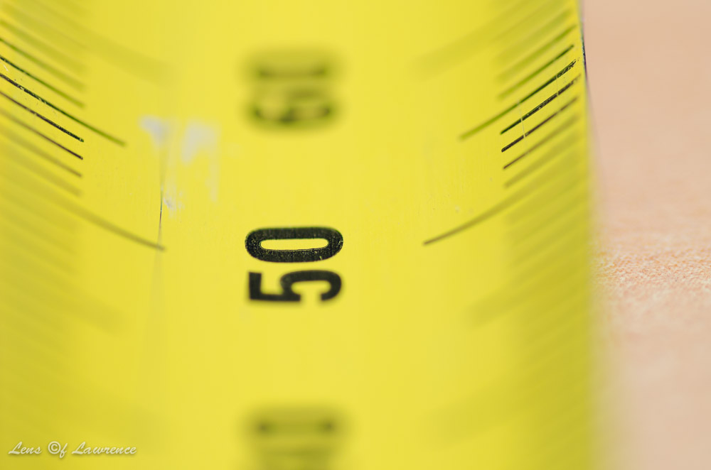

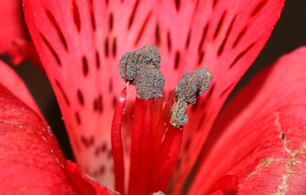

Here you go Lawrence. I took 2 shots of my wife's flower. The first up close the second back a foot or so. Notice multiple parts in first are blurry, due to dof narrow. the second was cropped to simulate the closeness of the first. View attachment 141256View attachment 141255

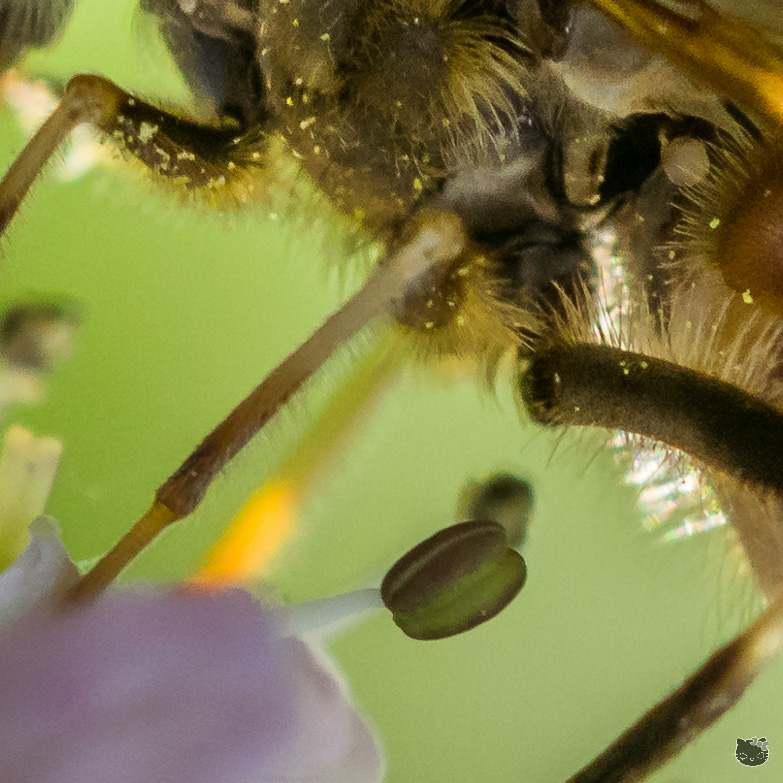

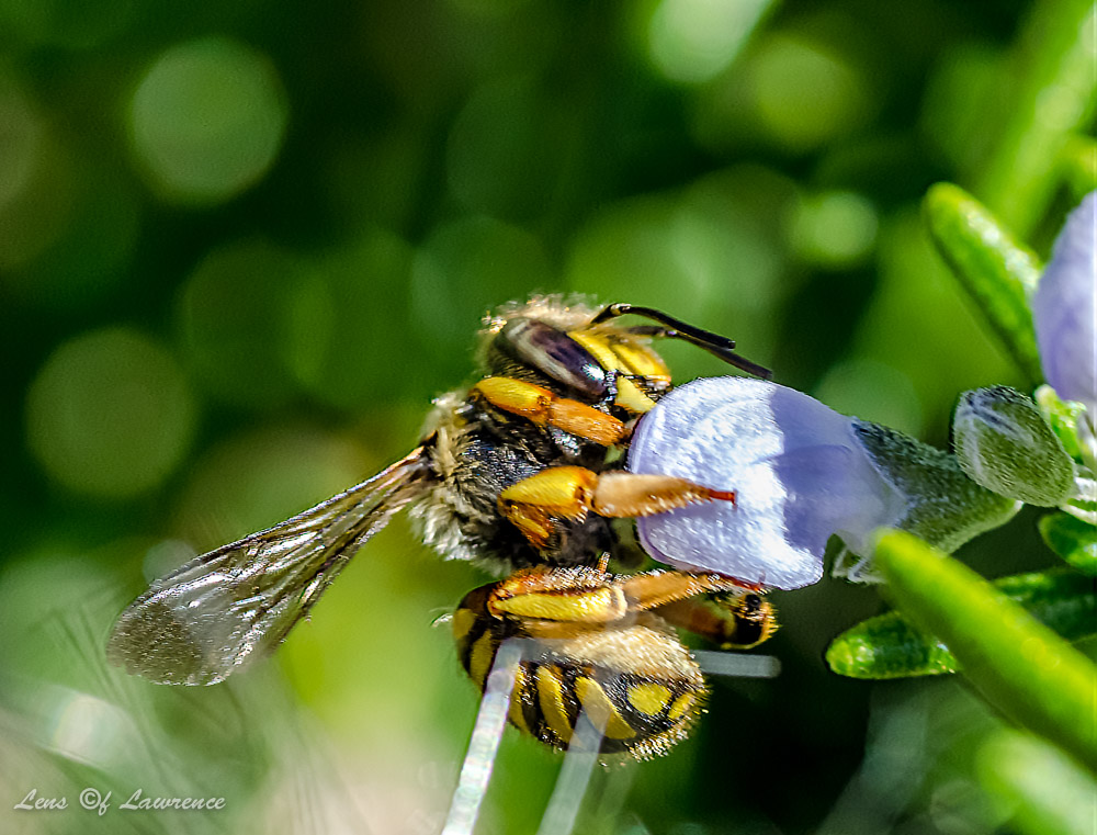

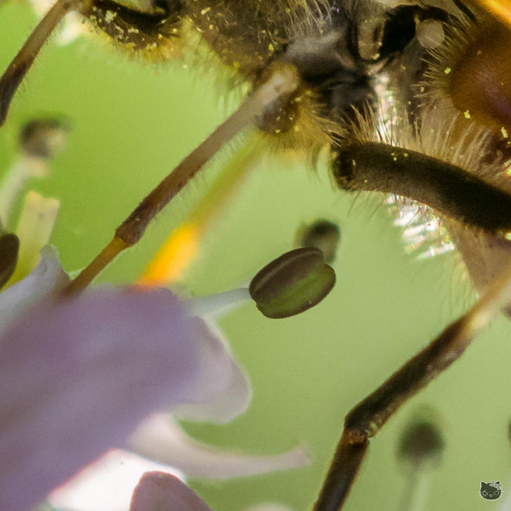

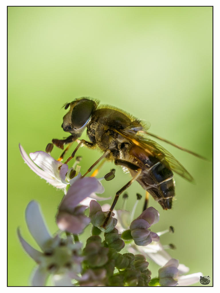

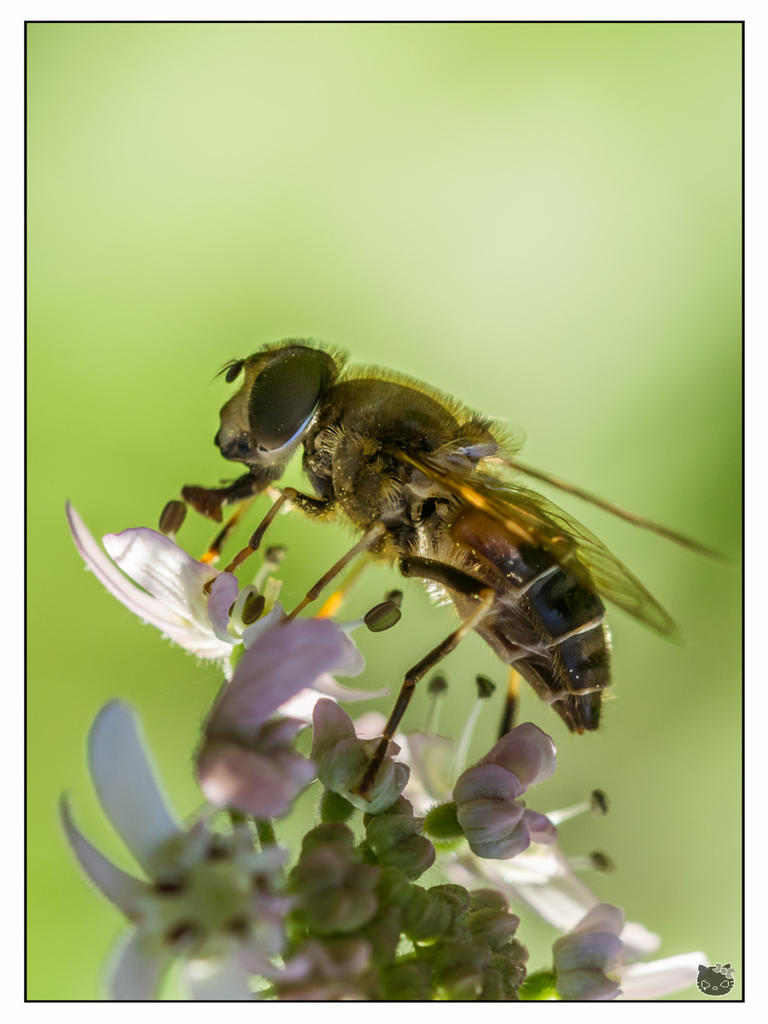

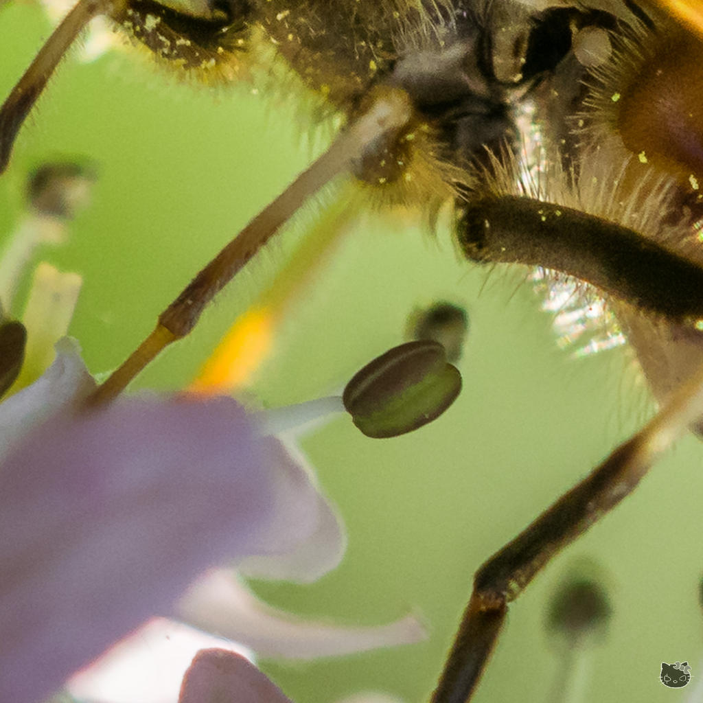

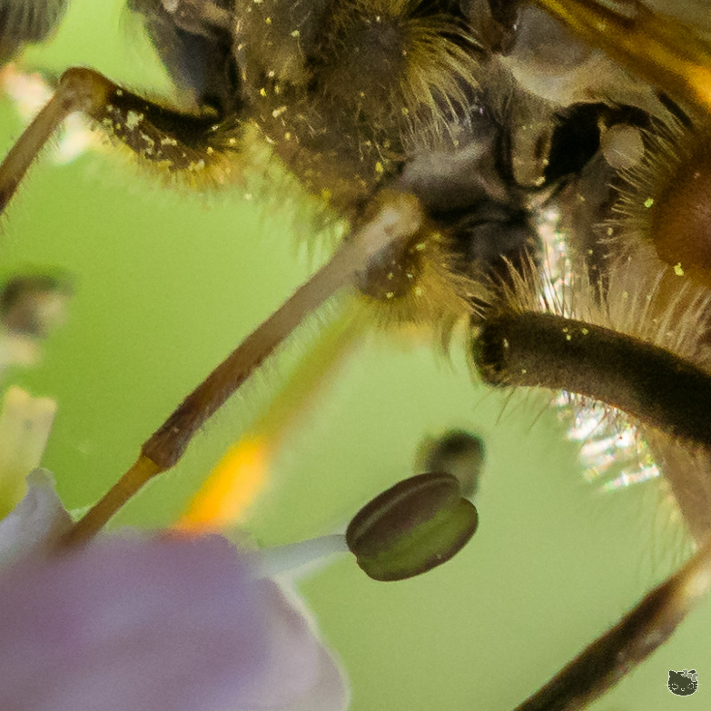

Here's an example. The shot is far from perfect and went the way of the Dodo long ago but it's what I had available on this PC.
The first is 3k*4k and I took a detail at 100% out of it. The second I doubled up in PS using bicubic smooth. I simulate crop/doubling. The shot is now 6k*8k. I didn't bother resharpening or adjusting anything else; I simply and quickly scaled it up.
Doubled:
There are limits to blowing up a shot and there are improvements to what I do here but it's just to show the initial size isn't always that important.
Edit: The detail shots are placed next to the wrong full. That well I noticed the difference myself at first sight. ;)
