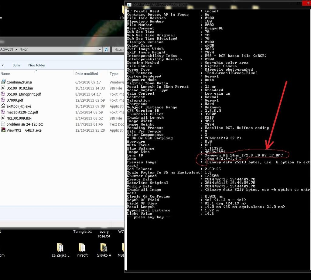

DraganDL
Use ExifTool - probably most comprehensive utility of it's kind (freeware). You just "drag'n'drop" your photo file to the "exiftool.exe"...
  • complete EXIF.txt
