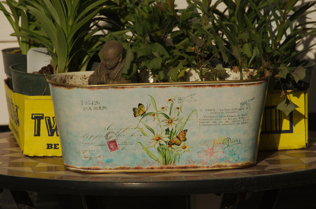

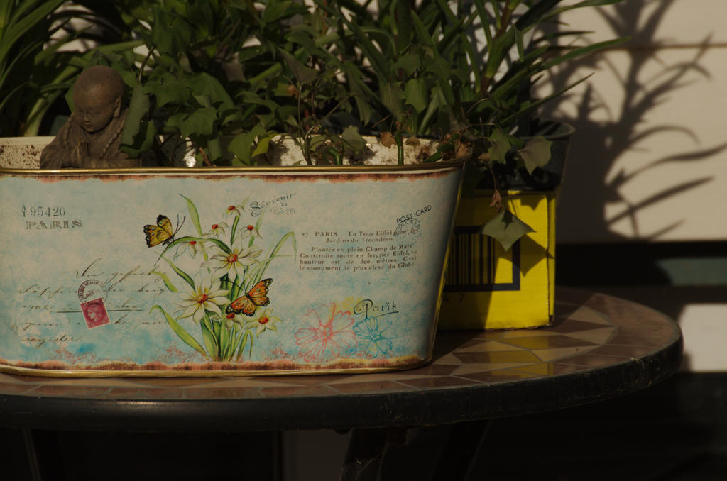

These two are done without the TC

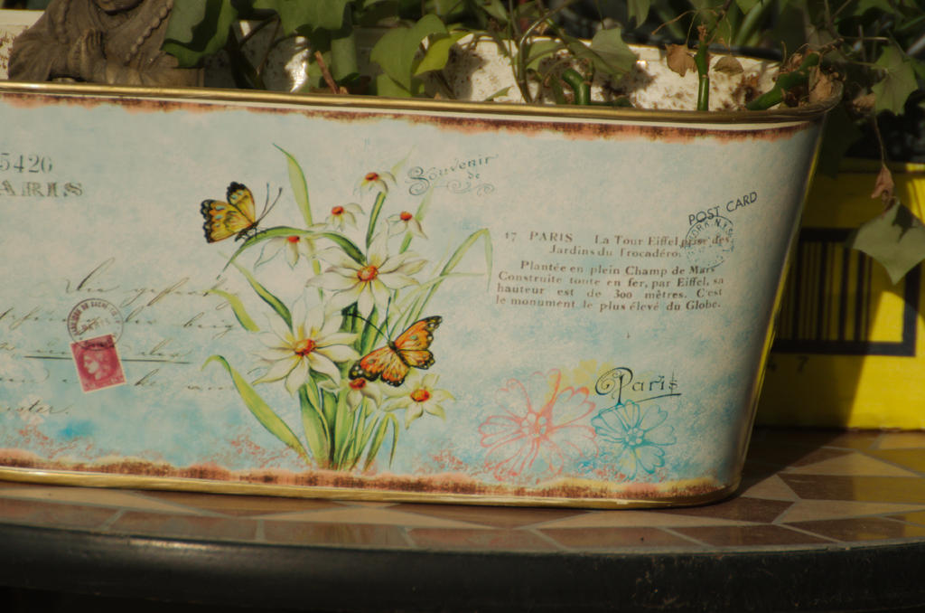

Shooting from the same spot - both done hand held I shot these with the TC attached.
View attachment 215060View attachment 215061
The files were converted from RAW to JPG with no post processing.
These were shot at the max zoom (300 & 420 with the TC attached) at F 8 & F 10.
You can draw your own conclusions about shooting a stationary item, in good sun. (sorry WB was left on cloudy - the sun came out for the shot and I missed resetting the WB).
I could live with the IQ if I really needed the extra reach.

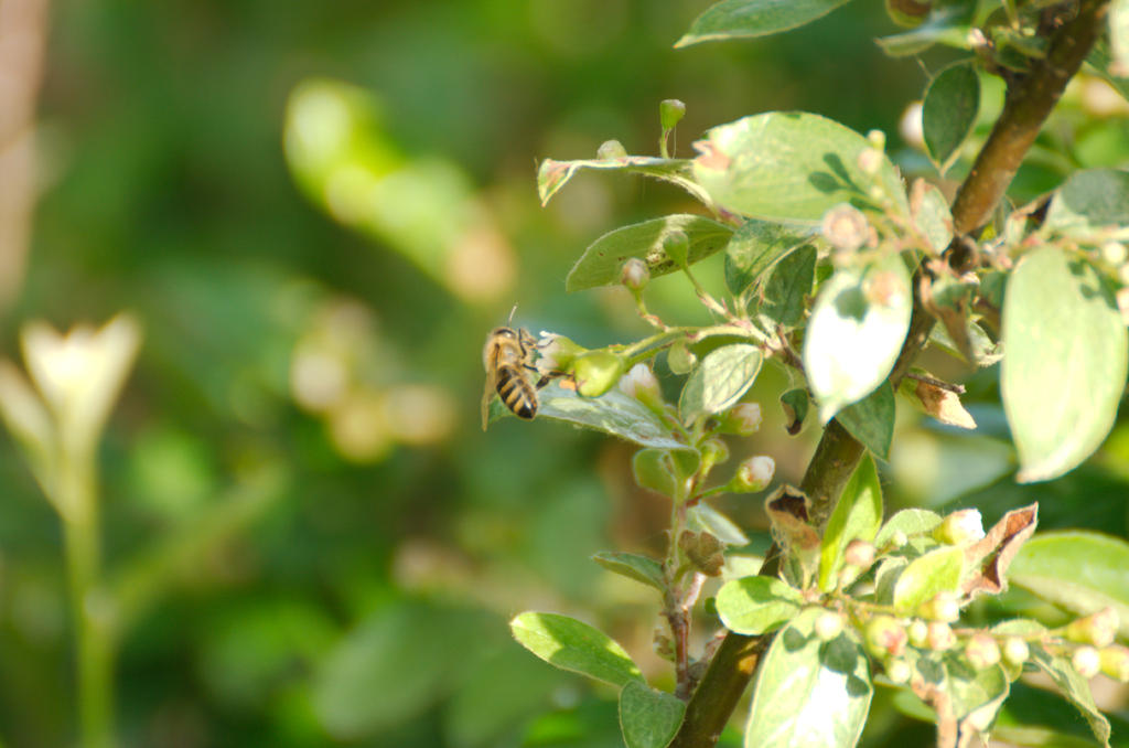

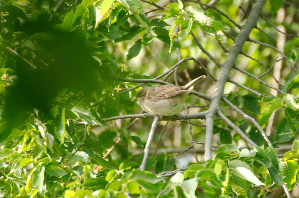

BUT when I tried some birds and bees (pardon the pun) I was disappointed. These two are the best - and I shot a couple of dozen shots that I thought the focus point was dead on the bird or bee.
View attachment 215063View attachment 215064
Now I'm used to shooting bees with a dedicated macro (105 2.8 and others, with extension tubes, and a magnifying lens - often on my D610) maybe I'm spoiled but I'm not happy with that bee shot. And I'm really spoiled with my 200-500mm when it comes to birds. But I expect better.
I will not be putting the TC on my D5100 with the 70-300mm I would rate that pairing as a "D" grade. Maybe, good light, and stationary object, but na.
