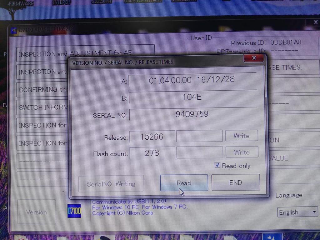

Update on this case... and its kind of freaky :dread:
The guy asked for my serial number so he can embedded back into the software. I gave him the SN but I switched a digit, as a trap of sorts: If my camera comes with the old/original serial number, then it means that he just put the old hardware back, or if it comes with the new/wrong serial number that I gave him, then he can switch SN and shutter counters numbers at will.
He sent me this picture (that's the "wrong" serial number I gave him, and the shutter counter is the one I told him my camera used to have)
So I guess he CAN change those numbers at will using that software.
So people.. be careful when buying old/used equipment. It may not be as new as Camerashuttercount.com says it is.
So the embedded serial number is now one digit off from the serial number shown on the outside of the body?

As long as the information is not hard code (ROM etc), it can be changed. You only need the correct software. The shutter count has to be controlled by software as it advances with each shot. So it would be pretty easy to change.
What is more is disturbing is that a lot of crooks (and not so crooks) have access to software that will change the parameters.

The serial number on the body is illegible. Maybe I'm mistaken but it's only printed on a label at the bottom of the camera and the digits started to fade way before this happened. So, when this TECH GUY got the camera, there was no serial number on the body.
The original Serial number is 9407950, I gave him a wrong one: 9409759 which is the one he set on my camera, just to be sure that he can write any random number as a SN.
