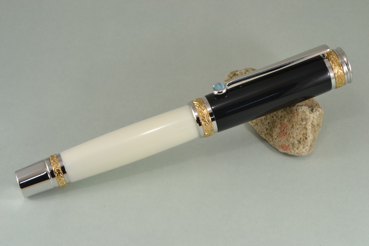

OK, a few more. I cleaned the contacts on the lens, didn't seem to make much difference.
The aperture is set at f16 for all photos (if I can trust what it is saying )
They are all using the circular polariser, I taped it onto the end of the lens, so thats where it stayed.

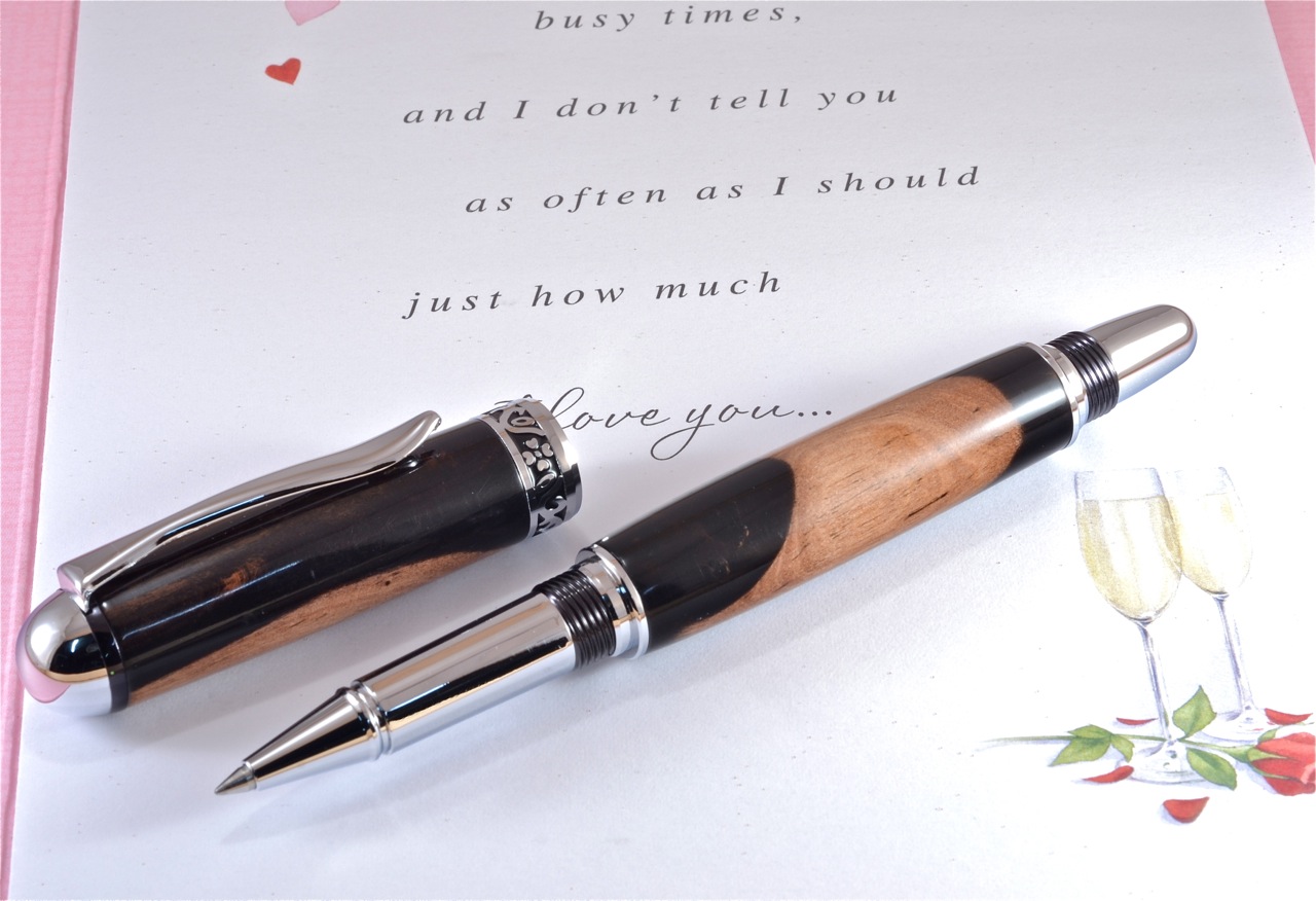

The first 2 are using a white plastic garbage bag for a tent.
The pens are a ballpoint dressed in Mackay Cedar, and a Rollerball dressed in Australian Ebony.

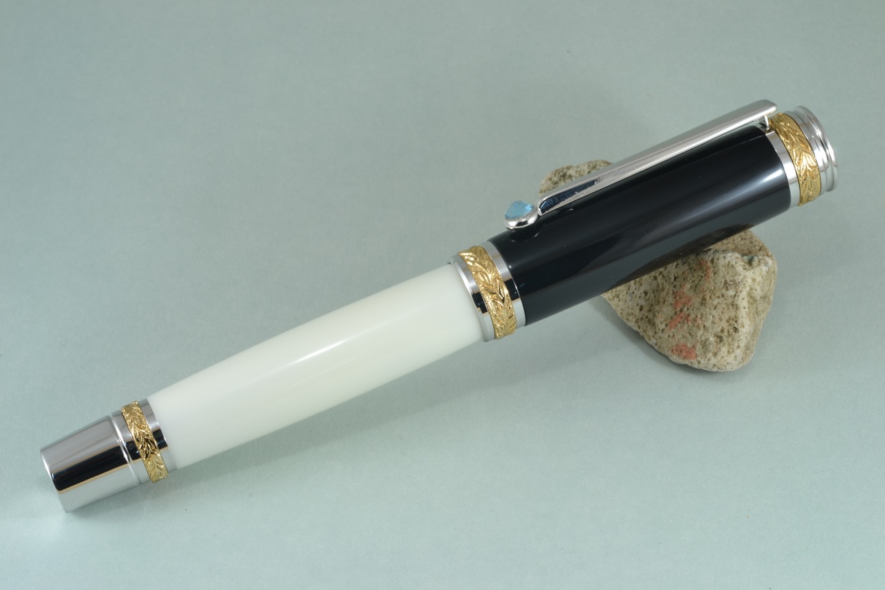

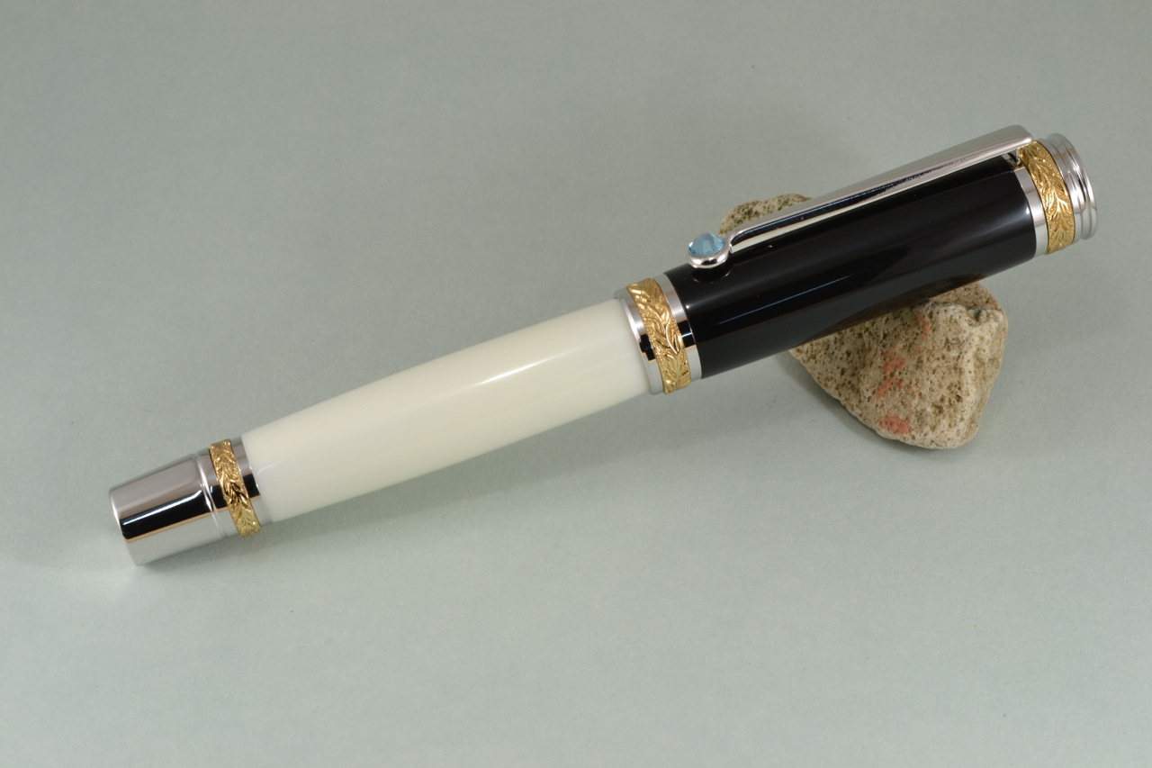

The next 2 are with the original light tent.
The pens are the Australian Ebony Rollerball, and a Gold Rollerball dressed in Red Beech.
Please let me know what you think.

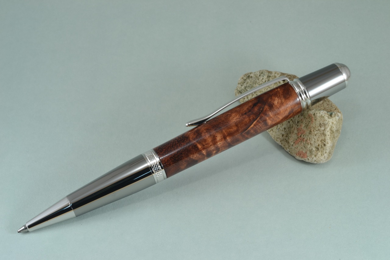

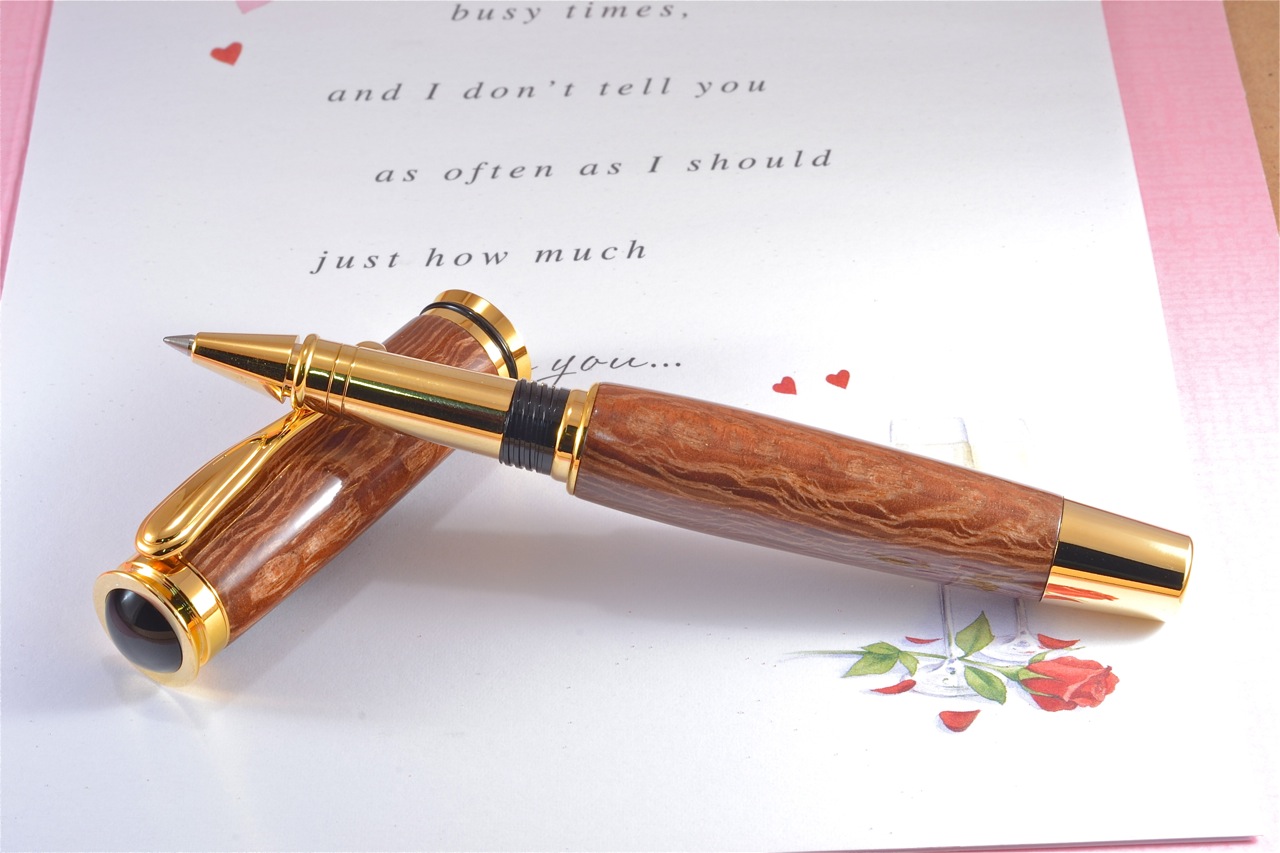

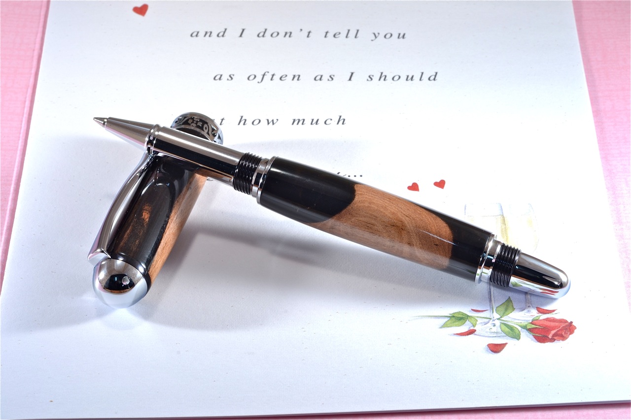

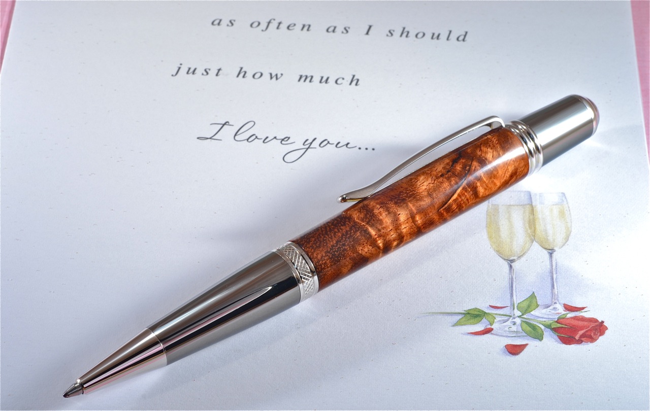

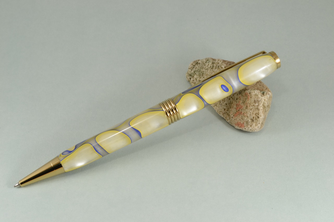

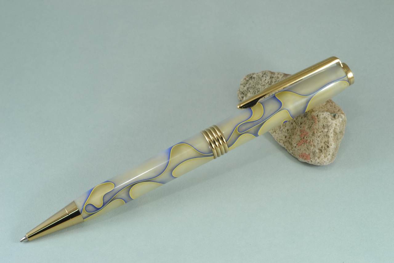

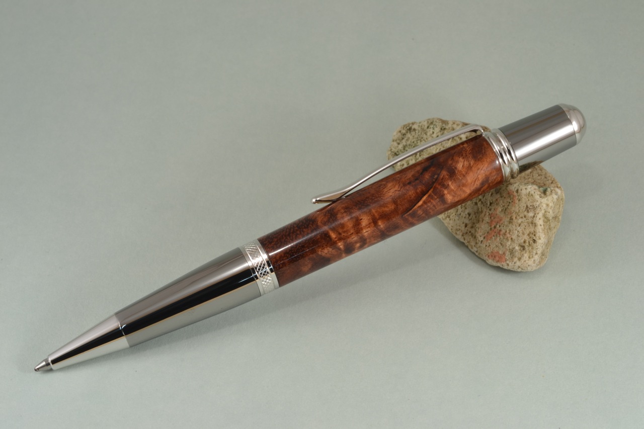

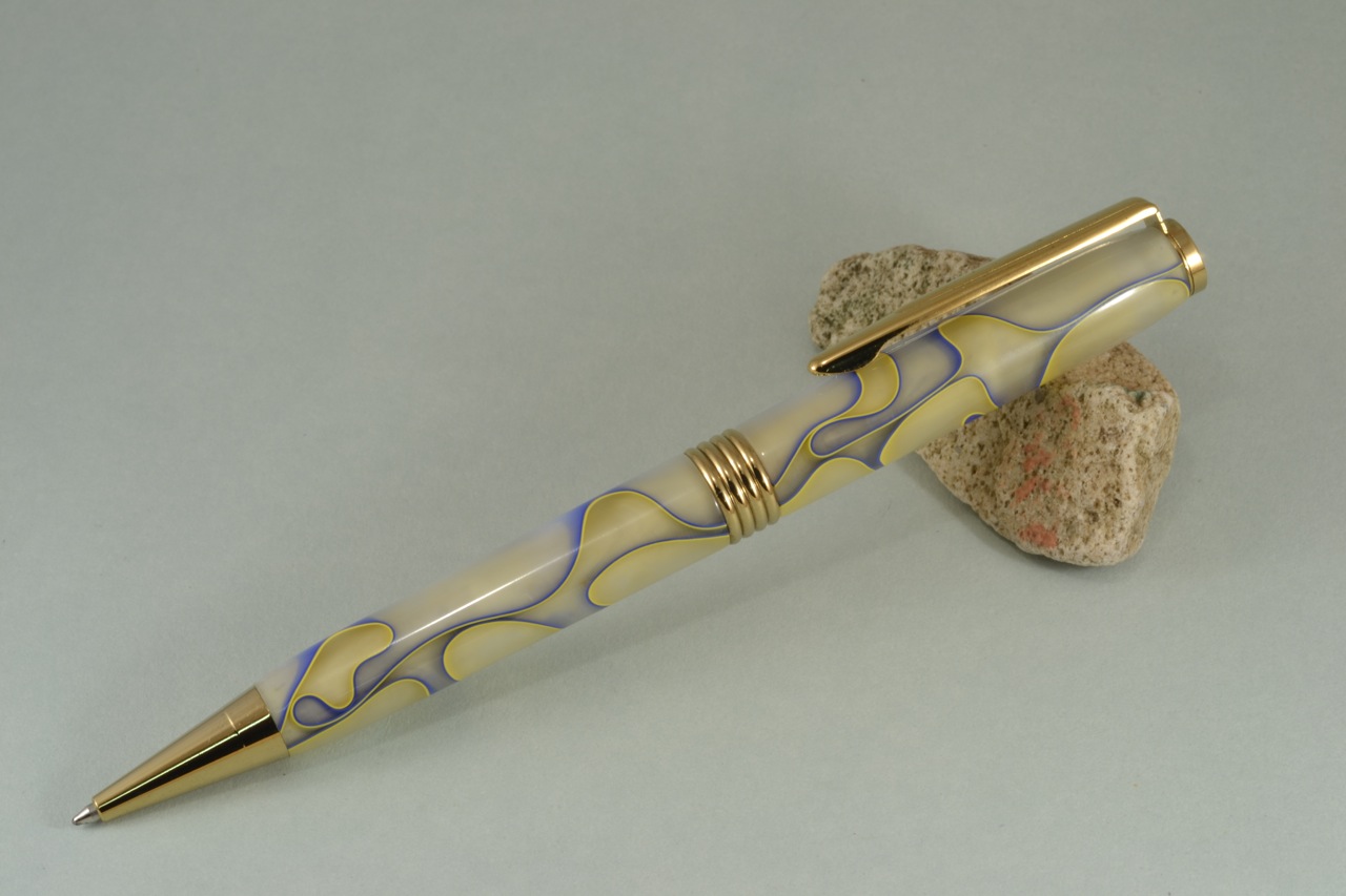

Righto, done some changes today.
1- moved the top light towards the front of the box.
2- moved the RH light up about an inch.
3- lined the box with aluminium foil.
Here are some test pics.... they are all straight out of the camera, untouched. ( except to resize so they will upload here )
All are 100 ISO , white balance was the same for all, using the reading I took yesterday.
First 3 are using the kit lens, 18-55mm @55mm with UV filter. F16.
Next 3 are 55mm macro lens with UV filter. f16.
Next lot are 55mm macro lens with circular polarizer. f16
Edit ::: just noticed the first pic in the first series has the pen rolled slightly compared to the other 2 series, so it looks a bit different.

I like the first pen in the first series and I like the other 2 in the last series. Great job on the pens.

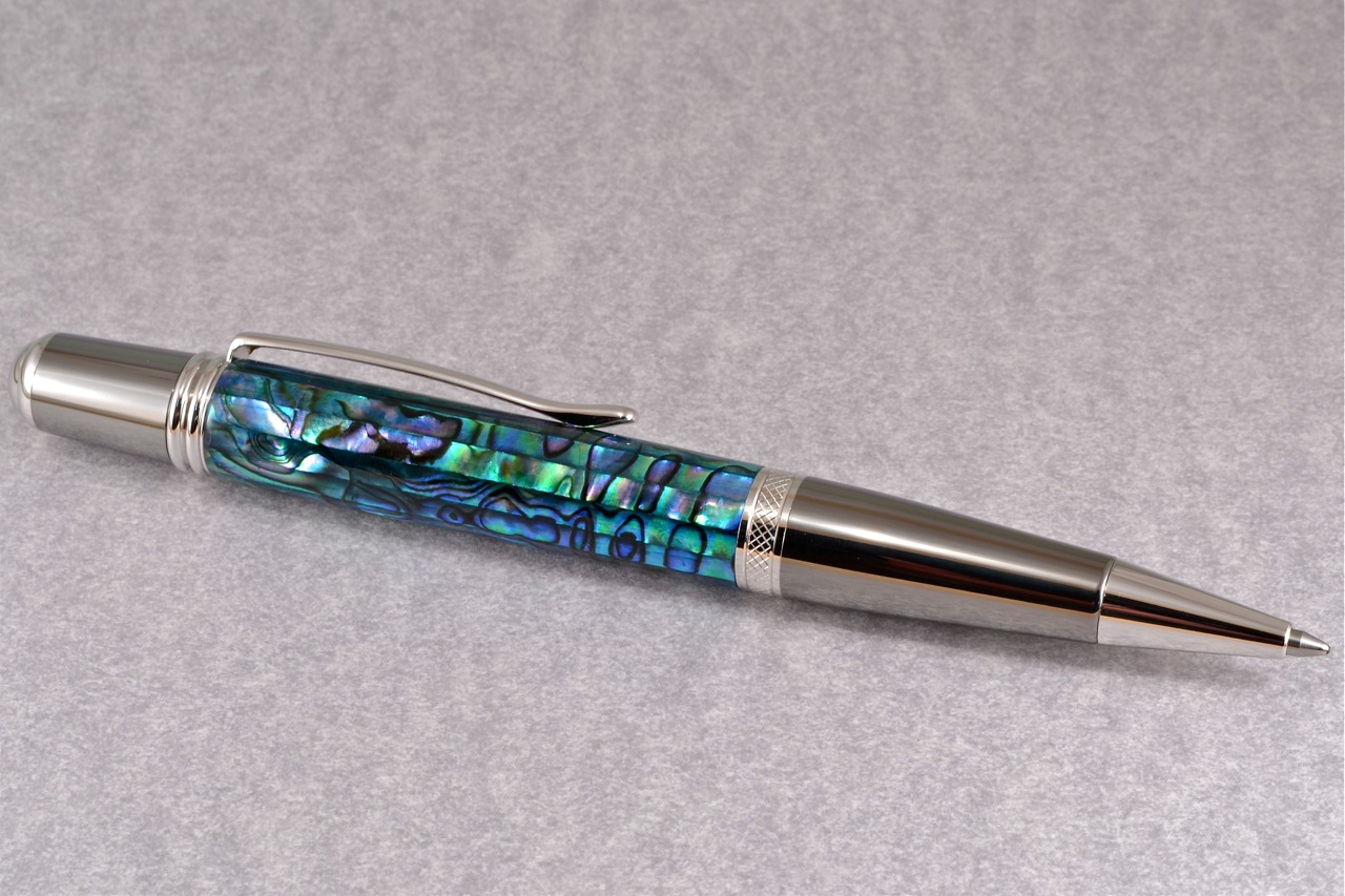

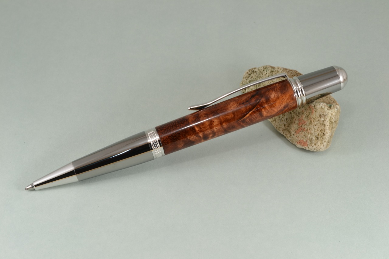

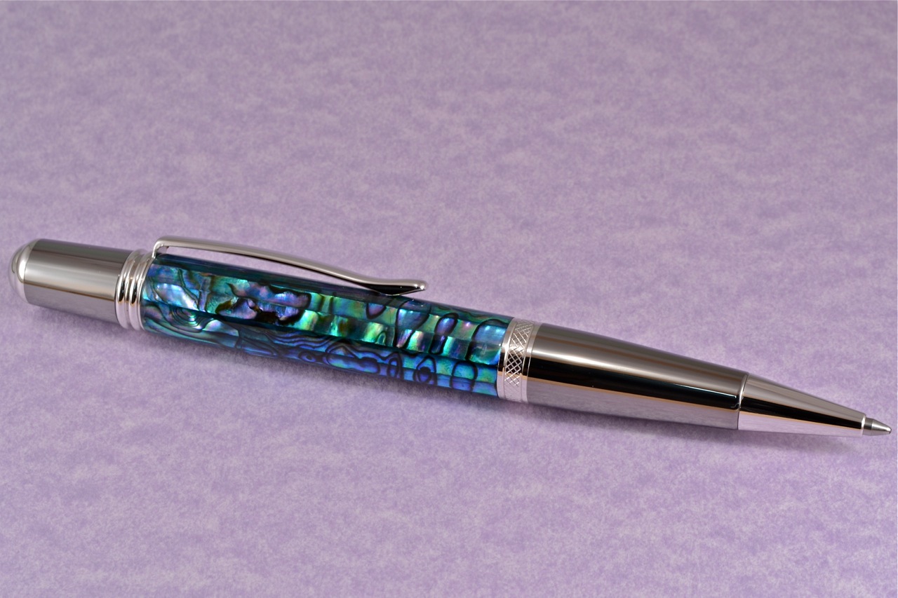

I went into town yesterday and picked up a range of about 20 different colour and texture paper to use as backgrounds.

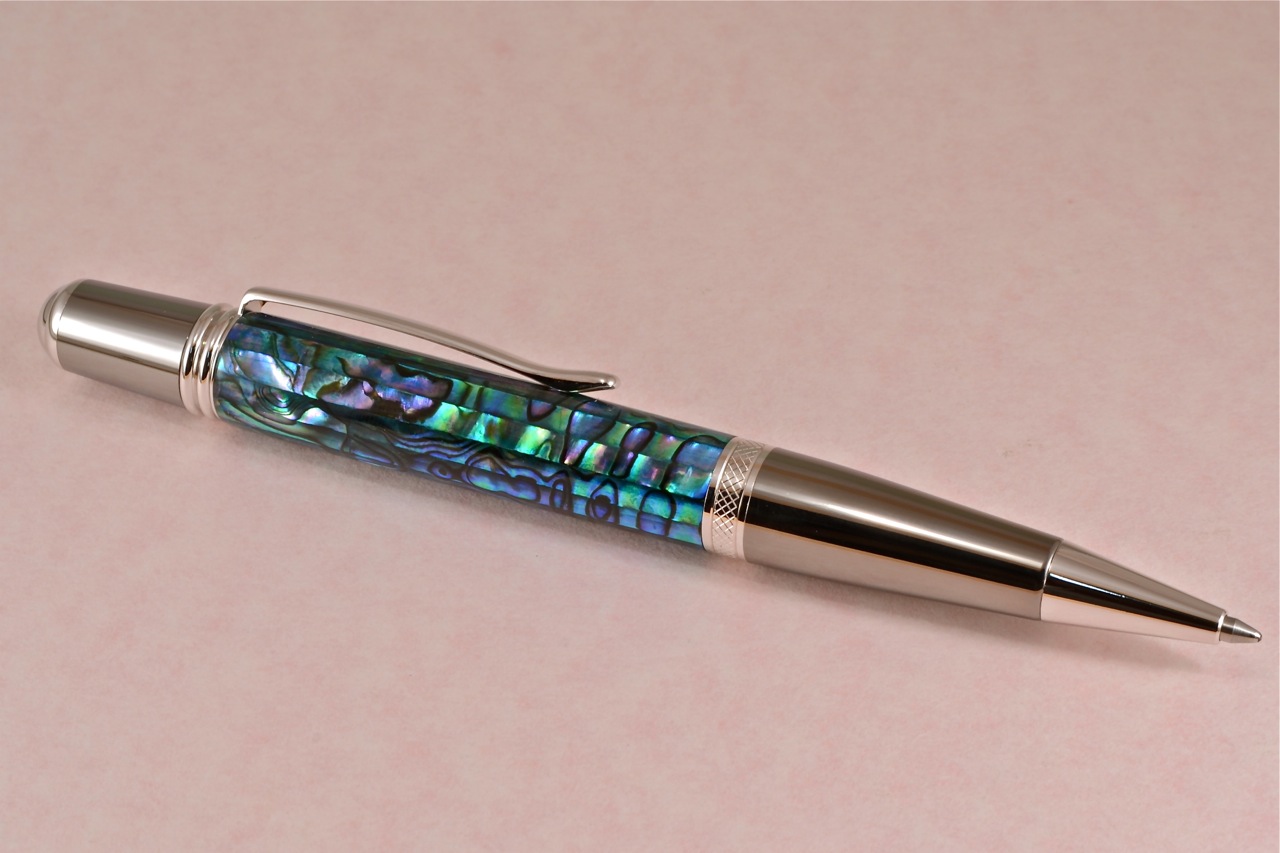

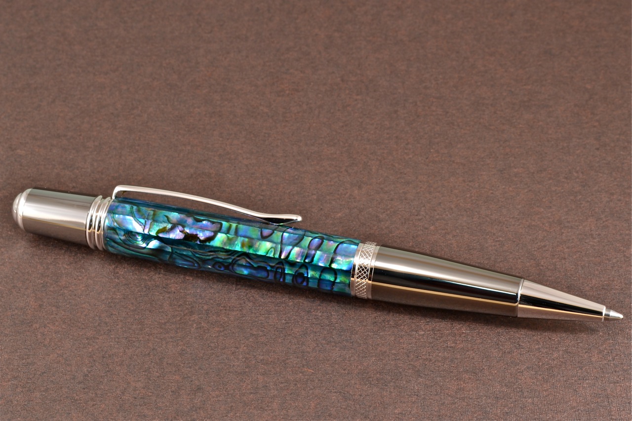

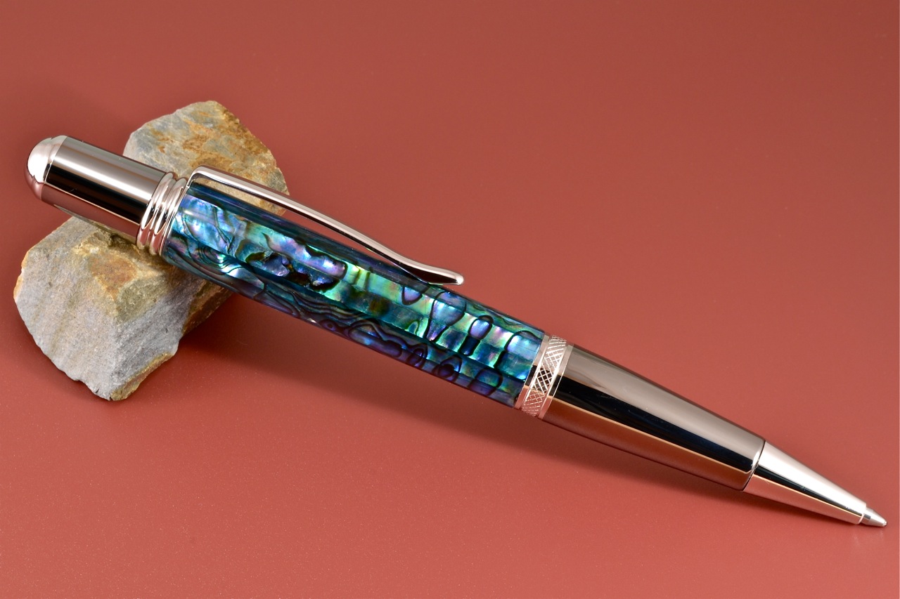

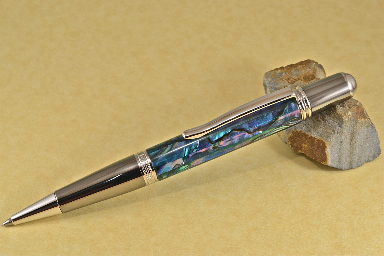

Here is a ballpoint I completed today, it features Paua Abalone shell which has been cut into strips and glued to a brass tube, and then cast in clear resin.
I have then turned it to size on the lathe and polished the surface of the resin.
I took a lot of shots with different backgrounds, but narrowed it down to these ones. Thinking about it now, I should have taken one on plain white paper also.
I dont know about anyone else, but I like how on the first one there is a reflection line along the barrel of the pen, the ones laying down are missing this. I may have had the first one positioned further back in the lightbox, but I am not sure.
Click on the pics to enlarge...
Tami Jo
I like the shots with the dark background, it really showcases the beauty of the pen. At least for the lighter pen coloration's.
Ironwood
Thanks TJ, I have found most people have a similar view to you.
I have found getting something to use as the background with just the right amount of darkness a bit difficult. It shows up the dust spots well too !!
I enjoy the purple back ground with this pen it brings out the little bit of purple in the coloring.
My Wife says that is her favourite amongst that group as well Misti. But purple is her favourite colour, so that may have a bit to do with it.
But I agree, it does compliment the Paua colours.

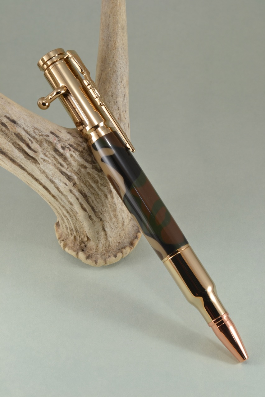

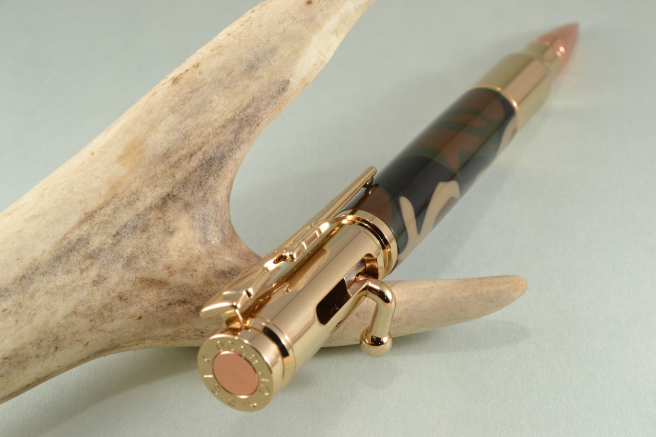

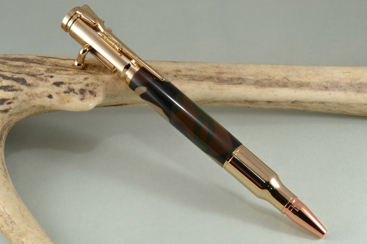

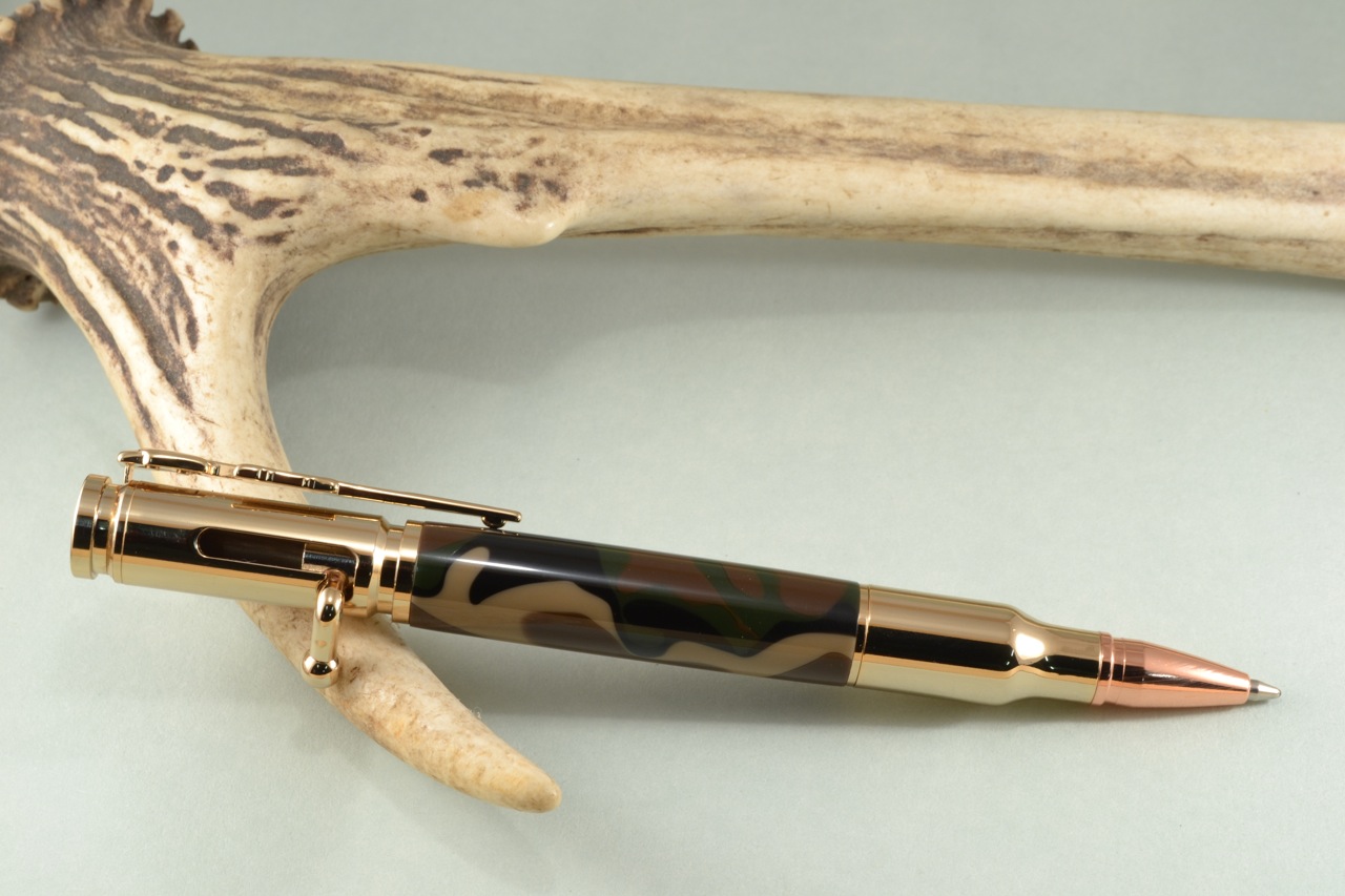

Here is a Bolt Action Pen I completed yesterday, it is the first one of this type I have made.
The bolt moves the refill in and out, so its a bit of a novelty for gun lovers.
