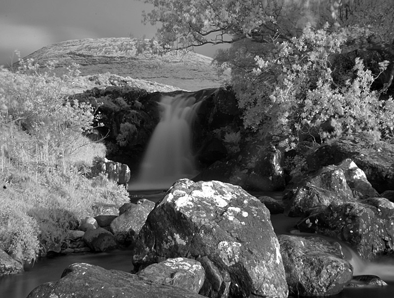

Hi Mark,
Here is one taken with IR filter on my D40. I don't know how different (or not!) the D40x is.
Heather
