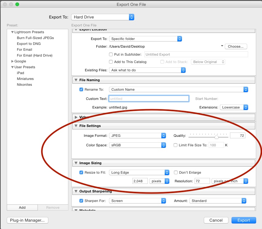

What version of Lightroom are you using ?
If you click on File - Export you should see this window.
In the highlighted area you can set the size you want.
Click on the Resize to Fit dropdown and select what you want.

Lol-- I know I'm blonde but I'm not THAT blonde! I definitely have my lightroom settings correct:) Thanks for the screen shot and all your help everyone. I felt very confident walking into my wedding this weekend shooting with my D4!
