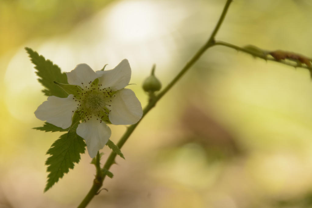

OK...so I looked at a couple of PS tutorials on youtube and read a couple of other tutorials and as usual I didn't get quite what I was after, so i combined ideas from all of them
My starting shot. I thought this might work a little better than the ladybird
So what I did was.....
Adjusted exposure, highlights etc as I normally would
Tweaked the colour in Nik ColorEfex
Pulled up the detail of the centre of the flower in Nik Viveza
Then I created both a circular & octagonal bokeh brush and applied that all over
Then added blur
Then masked out the flower and other bits that I wanted to remain sharp and free of bokeh
Quite pleased with myself as layers and layer masks have so far confused me but I found it easy today :D
The result is still not quite there but getting there

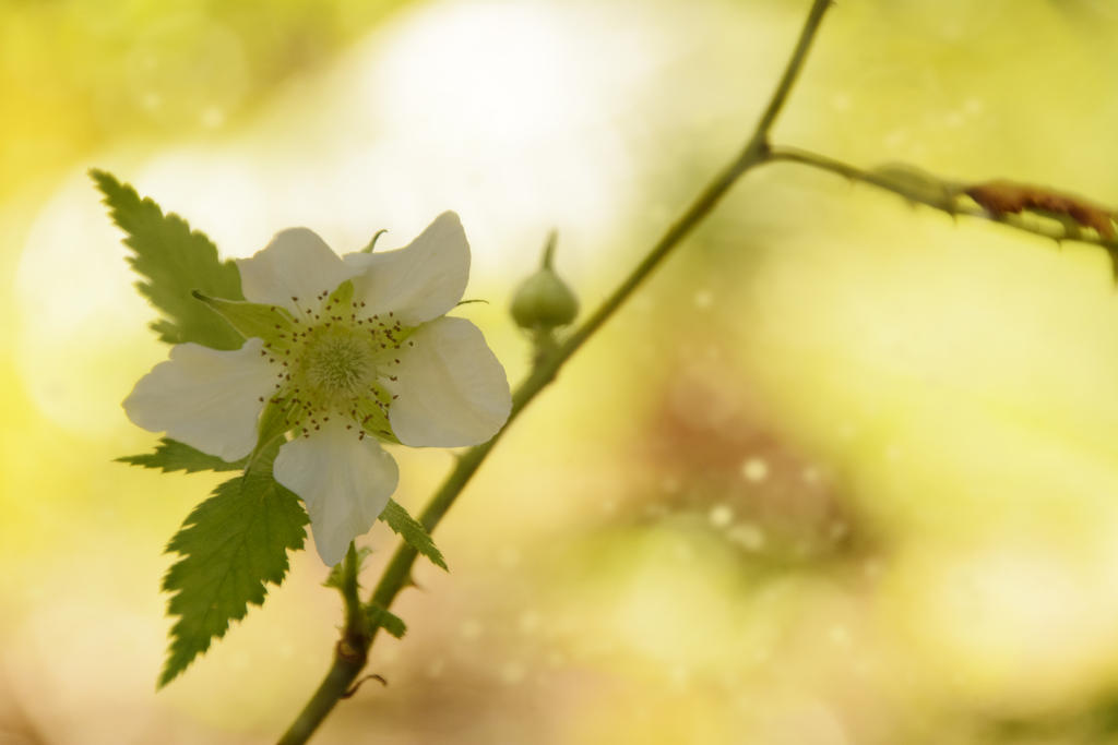

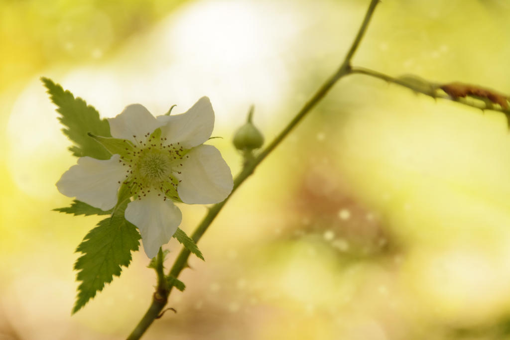

Crispix396
I think she (the fb page) runs some pretty heavy filters on hers. several of the images look like they have some sort of painting effect applied. Besides that, her images have much more LIGHT in them, the backgrounds are very lit up, and lots of distant bokeh. Your photo was a little dark. That being said, if you lighten it a little (just the midrange), duplicate the layer, run it as screen (in the past i usually used roughly 3 layers, 1 original, 1 slightly blurred screen at 20% and 1 blurred Overlay at 80%) I also see on hers it looks she used a radial blur very softly. I played with your image using these and got this. If i had the high res, or if the background had more light, could have got a much more dramatic effect.
Crispix396
and really its just an "open file, duplicate layer, duplicate layer (so you have 3), select #2, blur a tiny bit (to get rid of any hard edges or lines) repeat blur on layer 3, set 3 to overlay, set 2 to screen, fine tune to desired setting."
