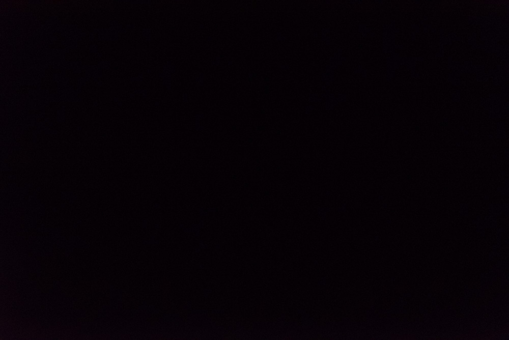

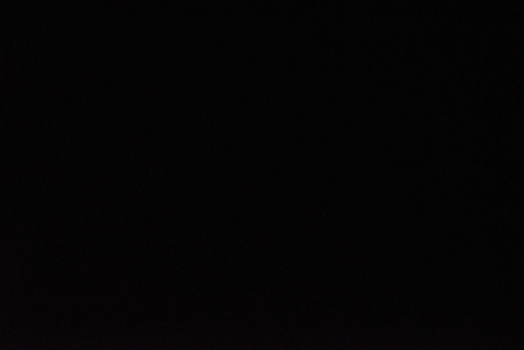

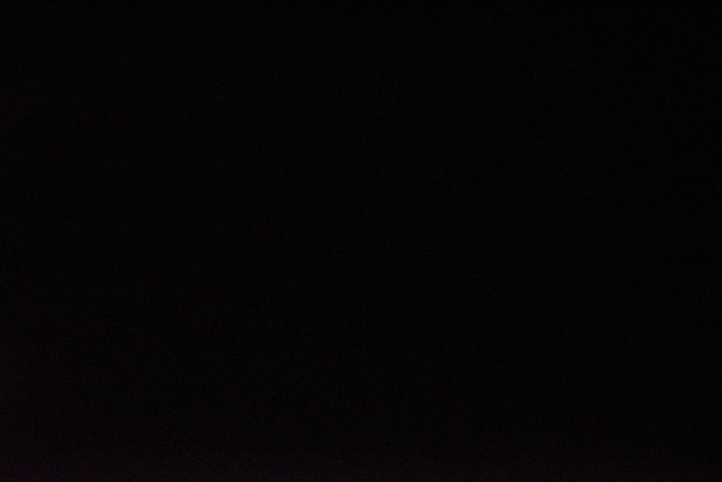

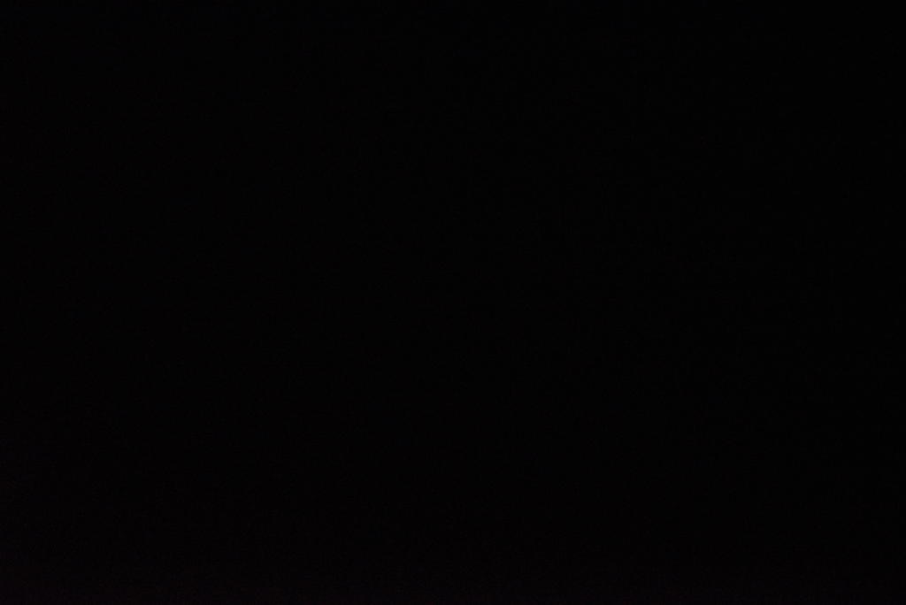

About half year ago, I wrote about my D750 showing magenta noise along the bottom of the frame with strongest intensity in the left bottom corner (camera in the horizontal position) when shooting at ISO setting from 5000 up (see http://nikonites.com/d750/36462-high-iso-magenta-noise.html#axzz4N4CTo445). I also attached a sample high ISO exposure with the described noise taken outside in the night for you to see what I ment. During discussion I thought it was caused with ADL mode ON while shooting RAW. Looks like I was wrong, the problem persists so I am limited to enjoy photography with this otherwise awesome camera under ISO 5000 only which makes me quite sad and disappointed:-(

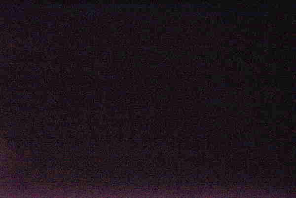

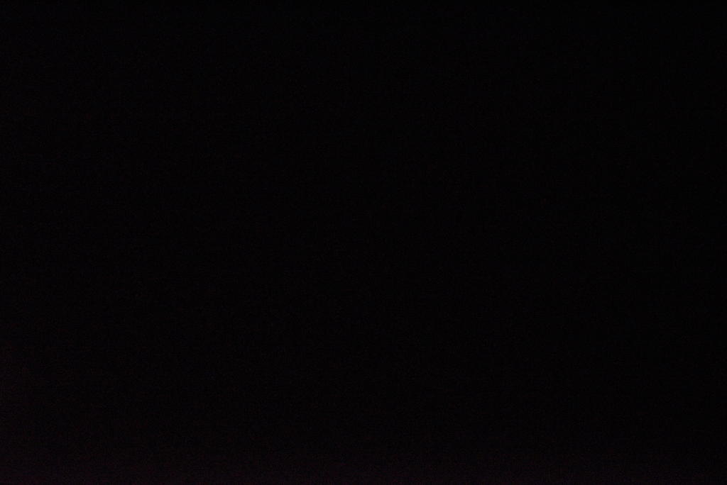

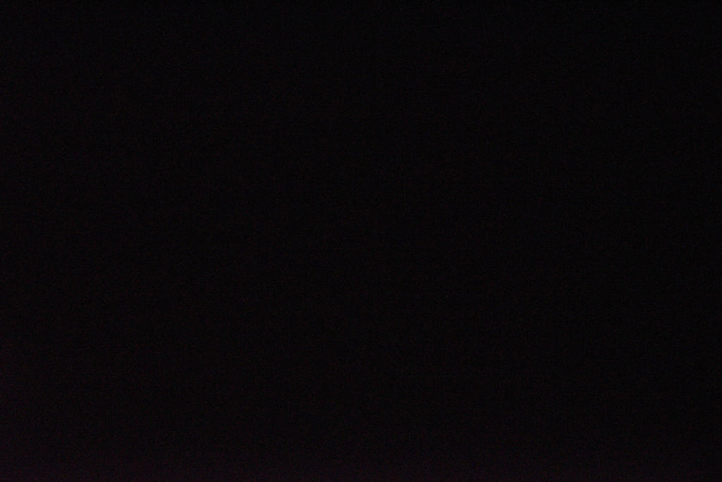

Today, I am going to show you four test images (ISO 12800 and 6400) right from the camera (no manual image data alternation applied, all supportive image quality modes OFF) taken with the lens and viewfinder window cups on. Two of them are in-camera and other two Capture NX-D converted JPGs with NR OFF from flat 14-bit lossless compressed RAWs and resized for upload. The higher ISO, the more vivid magenta noise is visible even without any further shadow (or anything else) processing, i.e. right on the camera screen (with brightness set to zero, i.e. medium level). However, it might help you to see the problem better if you post-process attached images for yourself or even test your D750 the same way I just did. And then please let me know your results. Thanks a lot.
Anyone with a suggestion or explanation now? Any feedback very appreciated, professional especially:)

I see it and on the 12800 ISO it seems to go higher up on the photos, about 2/3 of the way. At 6400 it is seems to not go up more than about 1/3 of the way. I can't tell you why it is doing it, but I do see it when I really look closely.
I might add that to see it I had to click on each photo to see a little larger version.

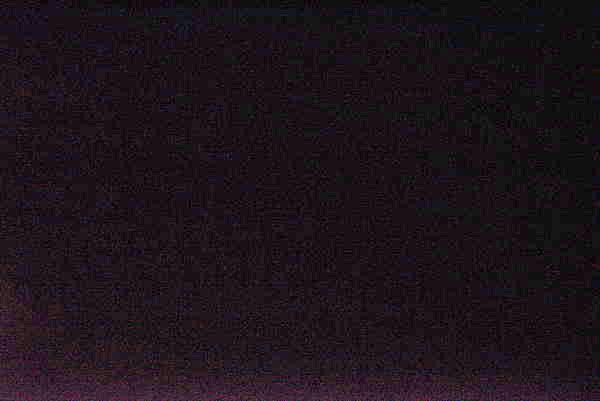

Here's the 12800ISO shot with a massive Levels adjustment applied to the Midtones. That's what I have to do before I can clearly see the magenta noise being discussed. With this adjustment the magenta is more prominent on my monitor than what I'm seeing in this post but this should give you an idea:
12,800 ISO; Midtones slider at 2.50

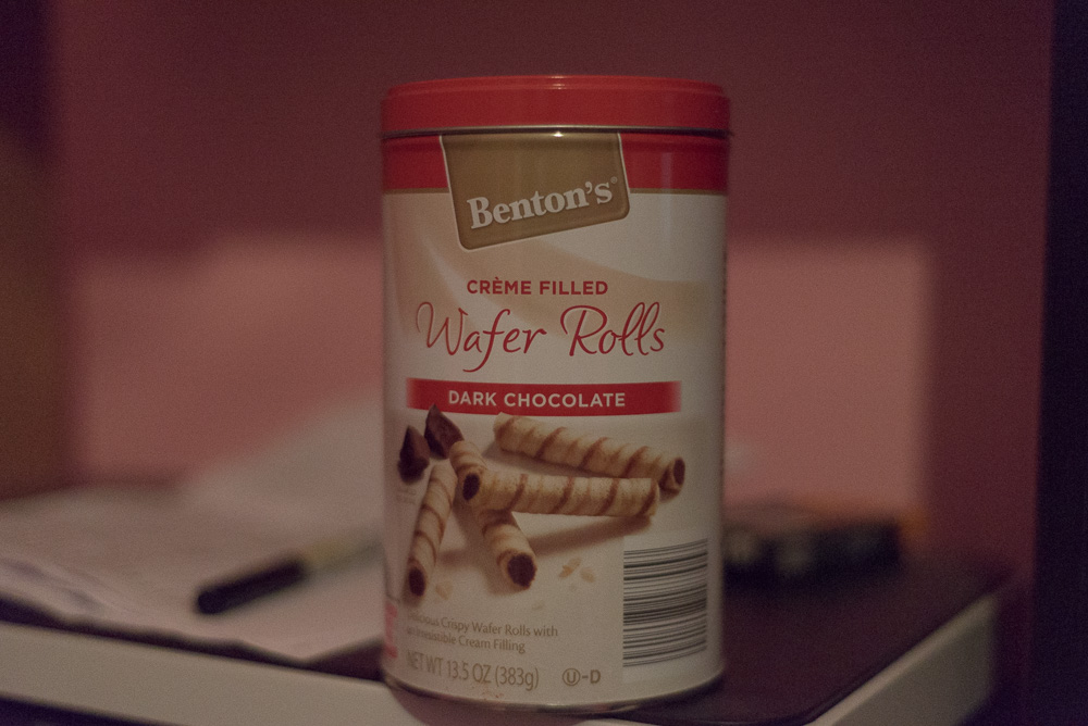

I don't see a problem at all. Normally I don't take shots with the lens cap on but I tried it with my D750 at the same setting as yours.
The first shot is with the Adobe Standard profile, the other is the Flat profile.
Please post a properly exposed shot at 12800 ISO.
Here is one SOOC from RAW to jpeg with the Camera Flat profile at 12,800 ISO

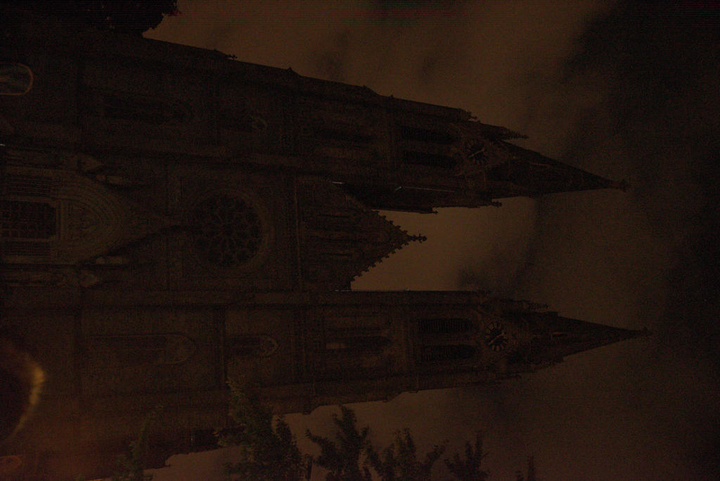

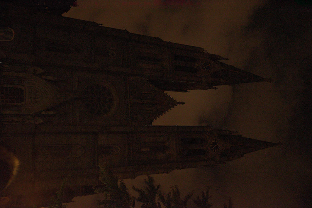

Please check this unprocessed (just resized) night image from my D750. Don't bother about the hand-shake blurr if you notice any, just concentrate on the noise along the bottom edge especially and also on some weird lines along the top edge. What do you think? BTW, I don't think this highlight-weighted picture is underexposed (clouds look ok to me), it was dark like that.

Please dont take offense treat this like a chat while where having a drink:D to me you seam to be going to extreme with your uploads too show a fault,if its the case the best thing to do is to send it off to Nikon,this last sample is under exposed and far too small a file to see anything worth while in.
One question and ime sorry if i have missed it,do you see the same results with all lenses,i ask because in this m4/3 world i have moved into there is a banding problem with the Panasonic 20mm f1.7 and the 16mp sensor,its only that combination and it doesnt matter if the sensor is in a Olympus or a Panasonic,just to make it worse not every one gets it.

Again the file size is too small,its 76.8kb the exposure adjusted file looks like this,its breaking up too much to be of any use to check for anything.
