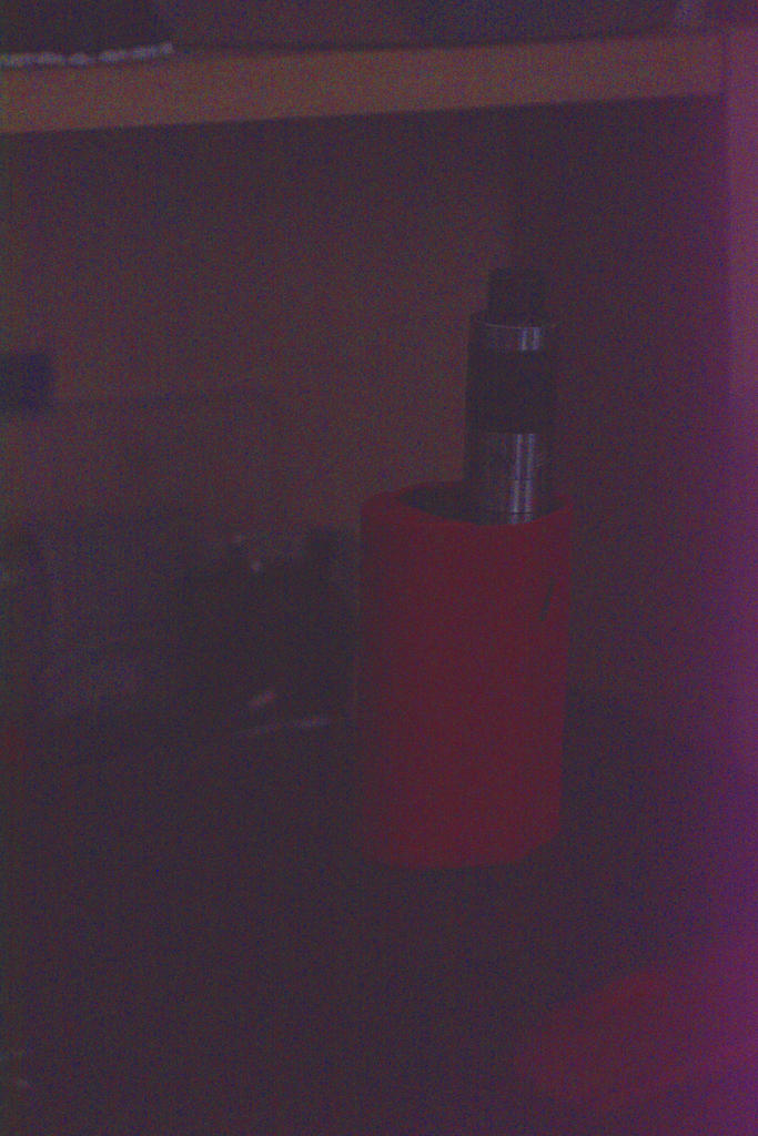

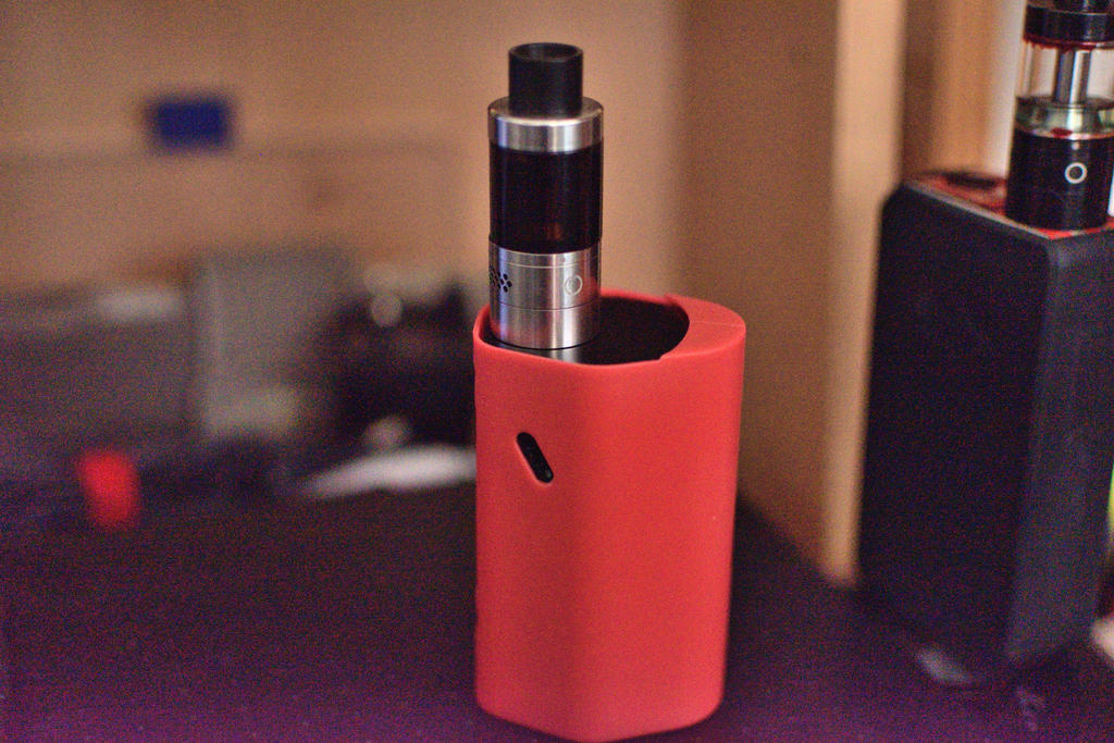

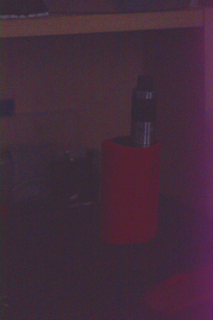

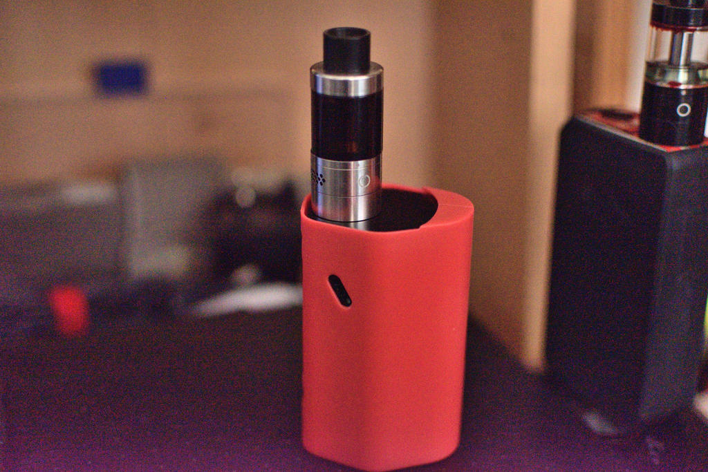

So HDEW Cameras were compliant and today Fed-ex delivered another, brand new D5500. I opened the box, nervous this particular model wouldn't be in as perfect *looking* condition as the one I sent back. It was, even better packaged this time. First thing I did was take a JPEG and check Shutter Count... Yes! '1'. Then I remembered to check for this purple banding, it seems I am looking for it now subconsciously on all photos. Initially I didn't see it, but I was a bag of nerves. Remembering that what was producing it before was low light, higher ISO than 100 so I closed the blinds, took a shot at 800 ISO 1/80s to match a previous 'mismatch'…
SAME EXACT PROBLEM!! What the h***! How can this be? I will attach these test shots and if anyone wants me to send NEFs I can do so. I just don't know what to do here, admittedly these are low light shots and the pictures in "normal light" are fine. If I was none-the-wiser I would just put it down to cranking up the shadows and exposure in post, but a) the reason I bought this D5500 was for this model being notoriously good for low light, even bought a brand new AF-S 35mm 1.8g to compliment this "feature" and b) going through my D3300 photos over the last year the ones with similar settings (underexposed on purpose) show clear from top to bottom no purple 'Amp Glow'
I am at a loss here, thinking I will just keep the camera because this is just too much stress to even apply to send it back. It was "only" £409 brand new so… ?
I feel like reaching out to any experts in this phenomenon, experts in the field of DSLR Sensors. How can 2, brand new D5500's have exact same problem? DSC_0007_00001Capture NX-D_01.jpg

I had something similar happen for me when I have tried to salvage a shot that was just to underexposed. Sometimes when I take a sunrise to keep from blowing out the sky I purposely underexpose the foreground and if I try to pull any detail out of it I will get this purple haze. I just have to dial the foreground back down, but that is just my experience.
Usually, when I have this condition the histogram is pretty far to the left.

Proper exposure might solve your "sensor's" problem... A severely underexposed image will show this kind of behavior when seen at 100% on the computer's screen.
When there is not enough light, the image suffers. Sensors only catch the light that is there. Extremely low light usually don't make nice images.

Today I have been shooting in broad Daylight and all the Pictures look crisp. I am seriously considering maybe I need to alter my Shooting style and instead "ETTR" from now on. At this moment I want to keep it. Too much headache even contemplating sending this one back…
The reason I decided on the D5500 is because a few weeks ago I started Night Shots (long Exposure on a Tripod) with my then D3300. I was capturing lovely Photos, but the Noise was horrendous. After extensive research I read all over the place the D5500, while perhaps having the same 'Sensor' is capable of brilliant High-ISO and Low-Light (Recovery) Shots. (This was evident to me when showing the Photos From the start, the amount of crisp, clear "recovery" on the top 3/4's of the Photos I was taking was amazing. However, down the bottom we have that 'Amp Glow'. There is no denying this, it is blatantly evident. Thus I went through my D3300 archives (both then and again today) and some similar shots (e.g. 1/80s, 800 ISO, whatever Aperture) and pulled out the Shadows and increased Exposure and even on the D3300 they are uniform, no Purple Amp Glow to be found.
