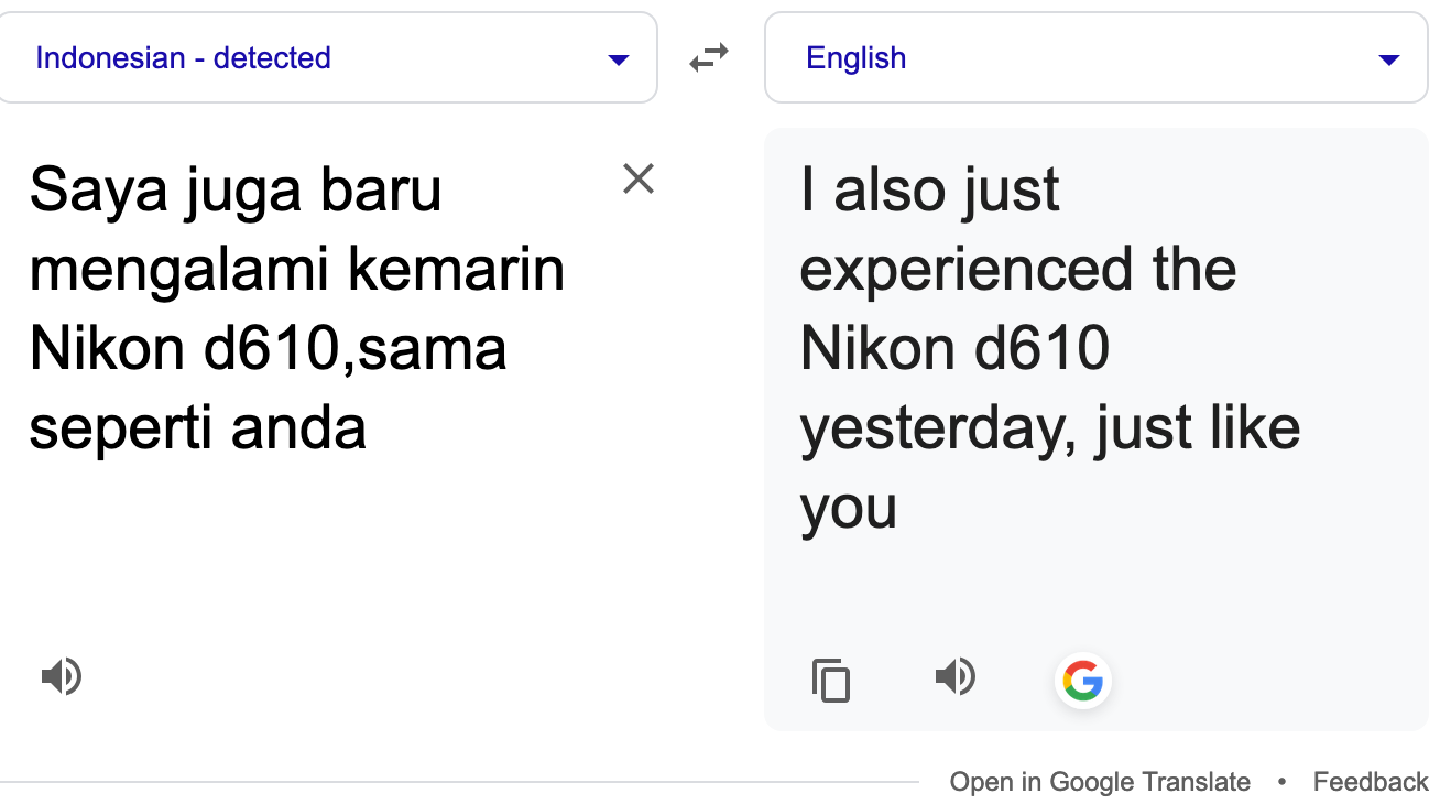

Saya juga baru ngalami kemarin Nikon d610,sama seperti anda
hark
Please type your responses in English. Thanks.
For everyone else, this is what I get using Google:
