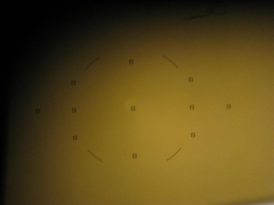

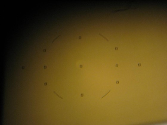

I'm not sure what it is but on every DSLR that I've put my hands on of late I can see a faint circle dead center in the viewfinder. This circle is NOT an AF-point or have anything to do with focus points. It's very difficult to see except under the right lighting conditions. Here's a photo from a Canon user that shows what I'm talking about. I'm not referring to the reference circle (the lines at two o'clock, five o'clock, seven o'clock and eleven o'clock) I'm talking about the faint, clear, circle that just barely surrounds the singe, center-most, AF-point:
It appears to me the OP's problem relates to this strange circle. I have a suspicion this circle has to do with metering, but I'm not sure about that. At any rate, this is clearly not a hunk of crud on the sensor that needs to be removed. I agree with @Marcel that this is a Nikon Service Center issue.
Just had a look at my D810 and you are correct there is a very faint circle in the middle. You can see it when looking at a light grey background. best to move the selected focus point out of the way as it almost covers up the circle.
Never noticed it before.

Yeah, the neutral background does help, I just tried with my D750. I've never been able to figure out what it is, or why it's there, but both Canon and Nikon cameras have The Spot.
If anyone knows for sure what it is please pass the information along... I'd really like to know!

I'm guessing (I'm out of my depth too) that this is a semi-transparent part of the main mirror (marked in grey here) that lets some light through to the AF system.
