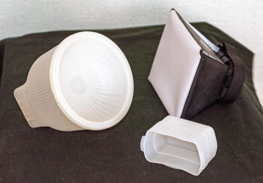

A rummage through my junk box revealed these commercial diffusers, none of which were particularly good in my opinion. In my naivety I bought the bottom one, the top two were gifted

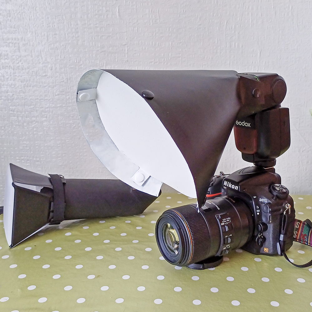

Until I'm satisfied that I can cope with my shaky hands problem, I have finalised this version of my Q&D flash diffuser. I have also cut out a couple of pieces of lightweight white plastic to 1) attach under the lens with double-sided 'tacky tape' to act as a bottom fill-in reflector and 2) a larger piece of similar material which attaches at the top of the main diffuser to spread and soften the light even more.

Interesting diffuser setup. I look forward to seeing some pictures from it. Was that home made, or commercial.
Silversnapper
....... Was that home made, or commercial.
The body is the Pringles tube shown in post #13 and painted with some old blackboard paint, the 'head' is the circa 2005 commercial version, top right, in post #29 and the whole thing is secured to the flash with a strip of Velcro type tape.
