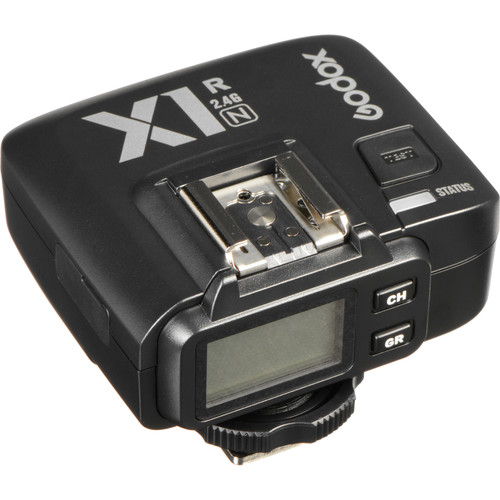

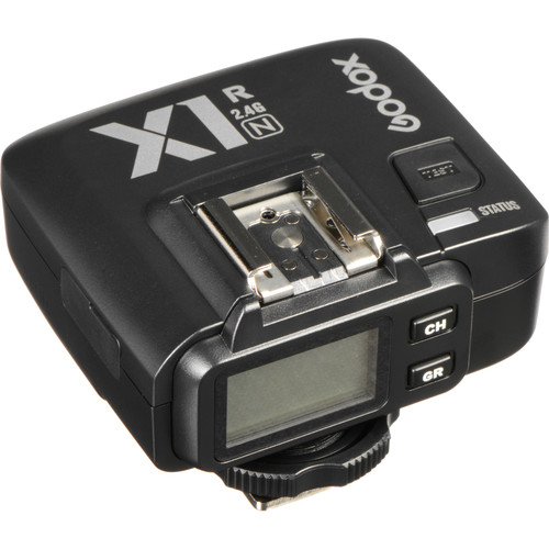

Just wanted to follow up and let you know the Godox X1R Controller and Triggers are working with every flash I've thrown at them. This includes all three Yongnuo flashes I have (YN-468, YN-565 and YN-568) as well as both my Nikon units (SB-400 and SB-700). I'm actually finding the Yongnuo's easier to work with, generally speaking, than I am the SB-700 but it could be that I'm just rusty with the Nikon.
There's a mild learning curve to getting multiple flashes set up and adjusted "just so" using the X1R, but I expected that. And while I never thought I'd care about having a pass-through on the Controller now I'm starting to think it's a nice thing to have and see where I might use it from time to tome.
So there you go: the Godox X1R is working like a champ with my Yongnuo flashes.

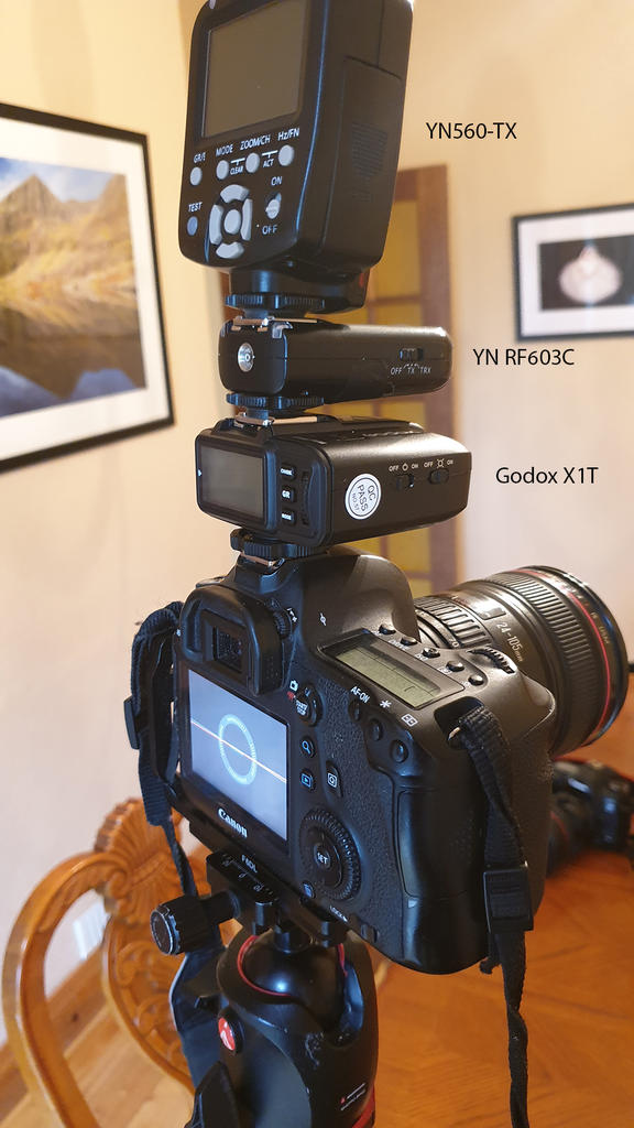

I'm not Paul and don't have a definitive answer for you, but I've heard of stacking triggers. This article includes a pic showing triggers stacked on the hot shoe. Not sure if this is the only option though. Image from article is linked below.
https://carrigmanblog.wordpress.com/2019/03/10/using-yongnuo-flashguns-with-the-godox-ad200/

[MENTION=13090]Horoscope Fish[/MENTION] is this the receiver that Walt can use for his Yongnuo flashes?
https://www.bhphotovideo.com/c/product/1341962-REG/godox_x1r_n_ttl_remote_controller.html

I'm with Fish on this, Walt. Why spend $40 per receiver to make your Yongnuo flashes work when you can buy the Flashpoint equivalent of the TT687N for $95 each. The Flashpoint ones appear to be on sale for $15 off their regular price right now.
Danno
There is the X2Tn trigger that will allow you to stack the YN flash on top of it. But I am thinking the TT685 will make you happier. I find it a lot easier to deal with than the Yongnu flash.
