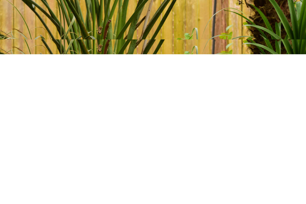

1) Note in my post you quoted, I detail out what it looked like when reviewed in camera. Some of the photos were bleeding or overlapping into the next ones in sequence. I scrolled through the photos again, in camera, and there was no corruption. When I downloaded those same photos to my computer, more but different corruption was the result.
I am thinking and hoping it is a bad card, but per my other posts the corruption is inconsistent and changes when viewed at different times.
Did you try downloading with a card reader and then into another folder from the camera? Which program are you using to view your jpegs?
Chris E

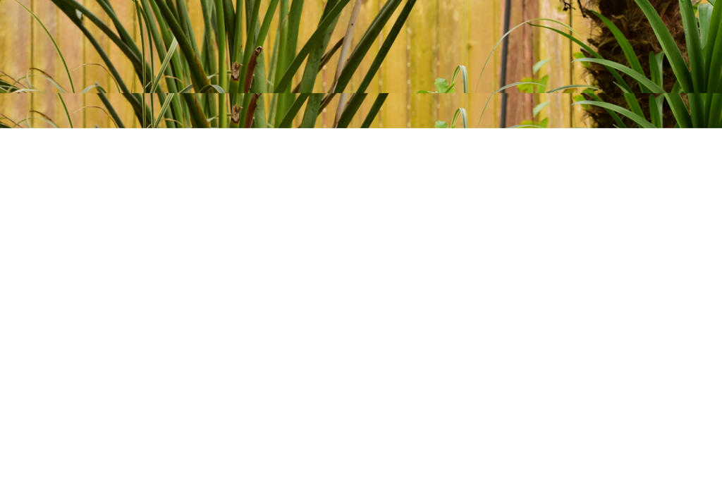

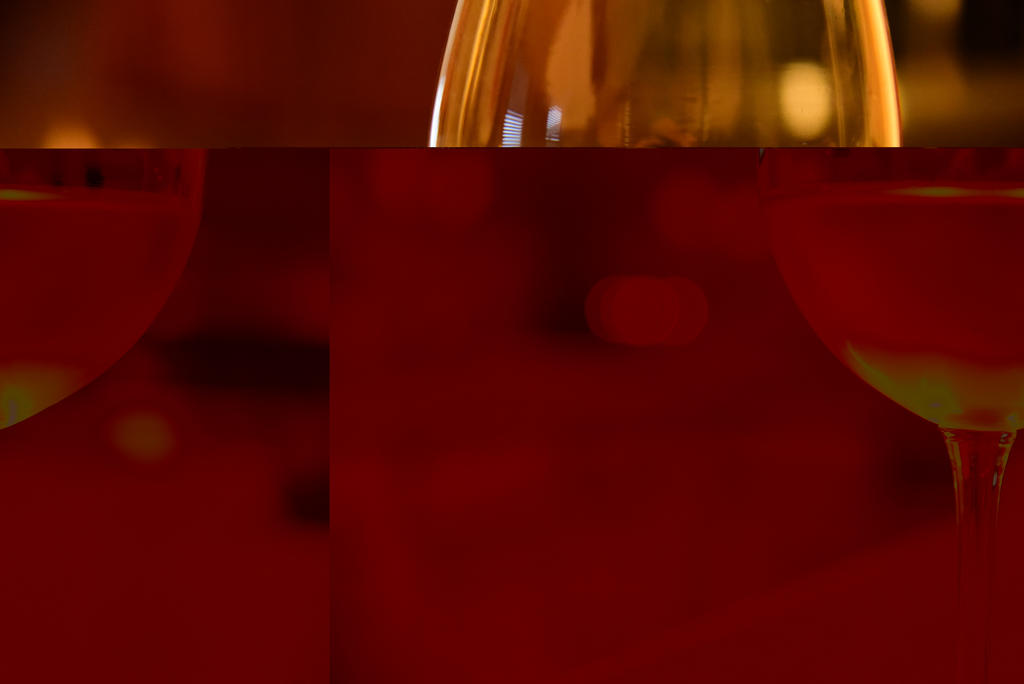

To summarize for everybody and to add more detail:
1) Some of the pix look corrupted when viewing in camera, but after scrolling through them they clear up. Some of these pix are different than the ones corrupted when viewed on the computer.
2) I download using the slot for SD card in my laptop. I have had this laptop for a year, probably downloaded 5000+ photos with no issue.
3) I have been viewing them with Windows viewer, or whatever the default viewer is in Windows. I usually do this and then only import the RAWs I want into LR. I shoot jpegs to mail out or whatever without having to go into a RAW editor.
4) The corruption when viewed on the computer is different than corruption viewed in the camera. The camera made the pix overlap, the computer either blanks out part of the picture or makes them look like the pic I posted earlier.
5) The corrupted files will not open in LR. Elements 12 will open them but warns they are 'corrupted', and then they open and look just like they did on Windows viewer with the same corruption.
6) The RAW files in the other slot with the other SD card were not corrupted. So, as of now this is either a jpeg issue with the camera, or that particular SD card is corrupted.
6) I have reformatted the same cards and switched them, now slot 1 RAW with the card that had the corrupted jpegs previously in slot 2, slot 2 now has the card previously used in slot 1 for RAW.
7) Tested this out and no problems with either card, either in the camera or after download using the same SD card slot in my laptop.
I will continue to test using various setups and post back.

did you try a different card reader? till you havent, you cant rule it out.

Did you try a different card? Did you try to shoot both raw and jpegs on the same card (same slot)? I suspect a card problem since even the camera has problem with it. But on the other hand, if the raw files are all OK...
When did this problem start? Is it just since you've started using the D750? Could you find another camera to try your cards with?
I don't think we can do much for you. You'll have to try all combinations to find which link is broken.

Yes, the thumbnail is normal, only when it is opened does it do this. The files are too large for the forum, PM sent.

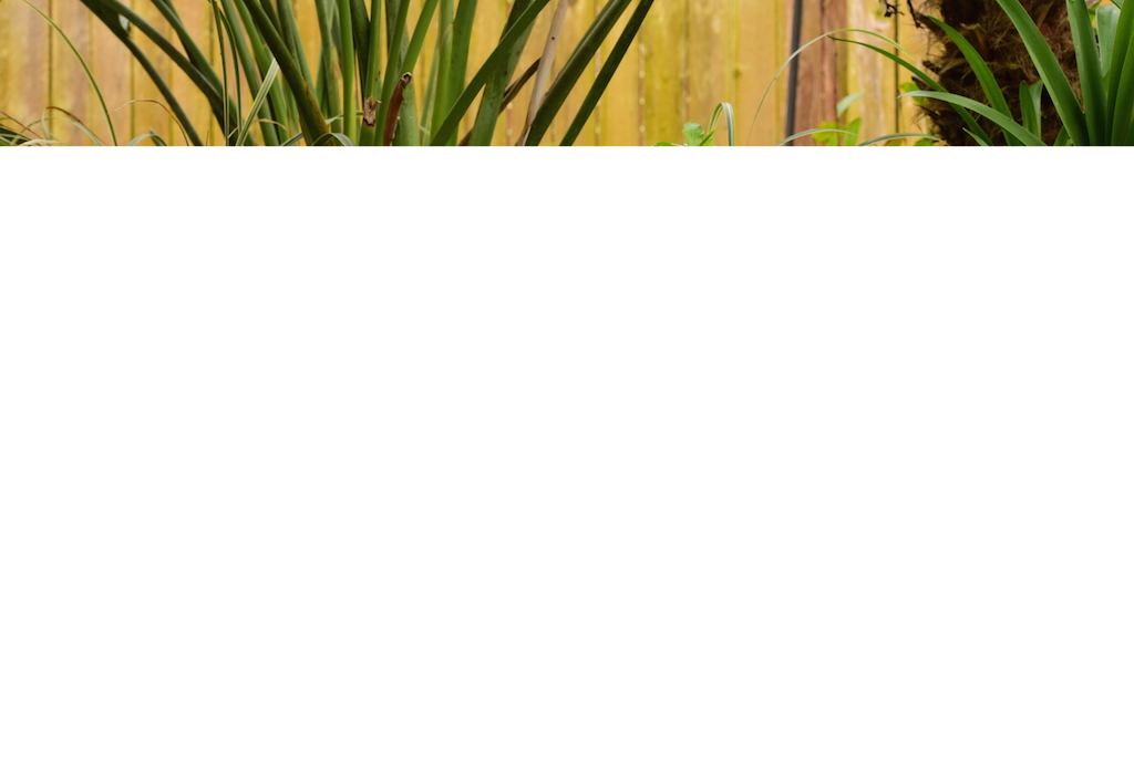

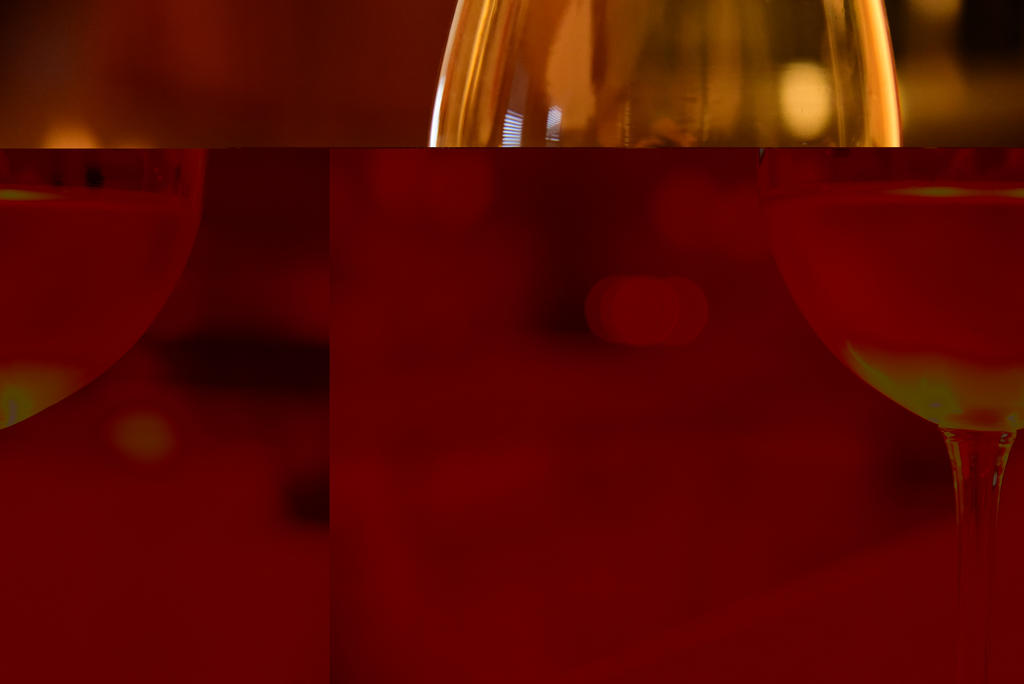

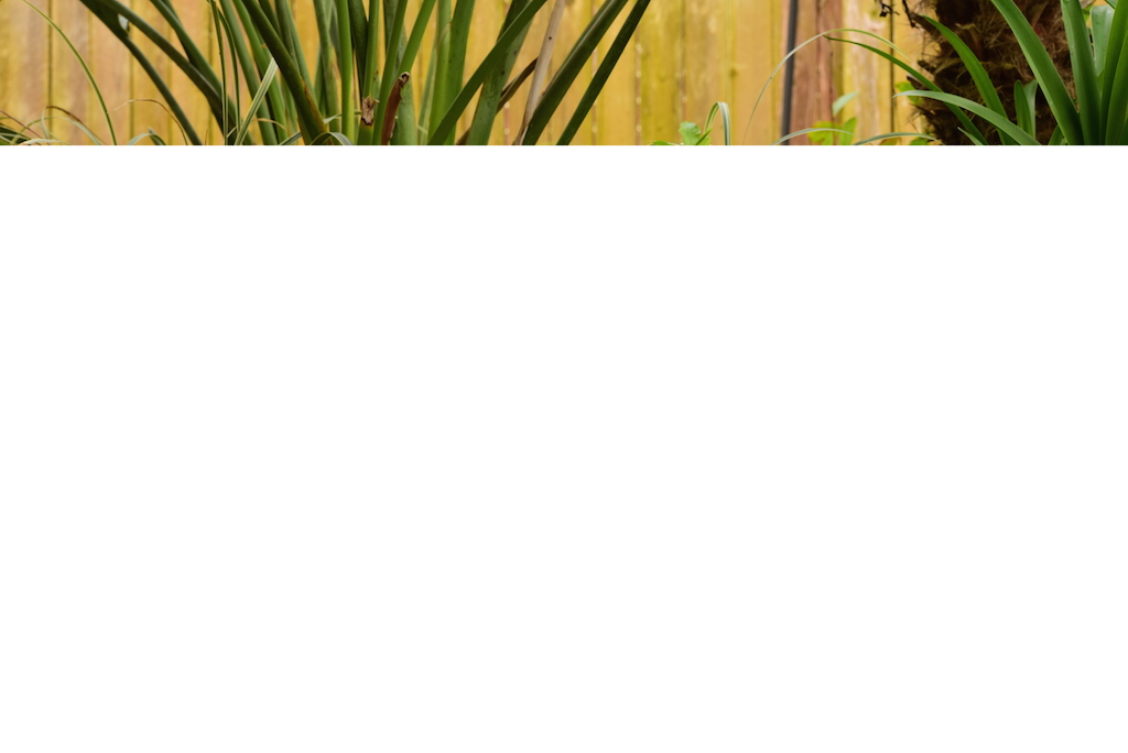

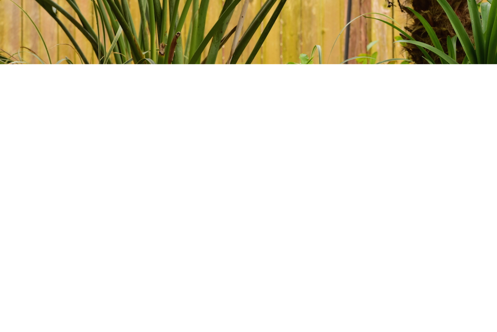

I checked the metadata of a full you sent me and everything seems to be ok. The preview that is added to that metadata is fine too, as you can see here. The full shot had only the top 15-20% correct and all the rest was black.
As far as I know the metadata file & preview JPEG are created before the full version so theoretically it is still possible something goes wrong during the write of the full in cam but I consider that unlikely. I'd bet on the card or the reader.
Here's the full resized.
All what is white is corrupted info. My Mac could load the file but GIMP and RT would not even accept it.

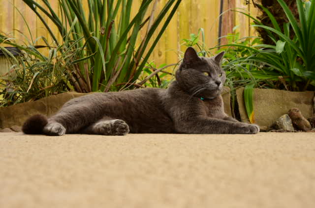

I can report I've used my camera sparingly the last week, but have had no issues since I reformatted. I have changed my setting for slot 2 to be duplicate. I plan to go to Galveston in the morning to shoot the sunrise and maybe some street stuff so I will know better after that.
I really like the flip screen, more than I imagined. I took the pix of my cat with the camera on the deck, screen flipped up so I could frame it properly. I was using my 60 macro prime....yes I have one of those useless non tele's J-see. :D

Yes, I was the same way. I do have neck problems so I thought I would use it when on tripod when I bend over to compose, but I use it much more. Here is another one, at a river near my sister's place over by Lost Maples State Park in Texas, this is the Sabinal River. I almost dunked my camera by putting it too close to the water, not paying attention with the screen flipped up. I partially submerged the end of the lens before I noticed.
