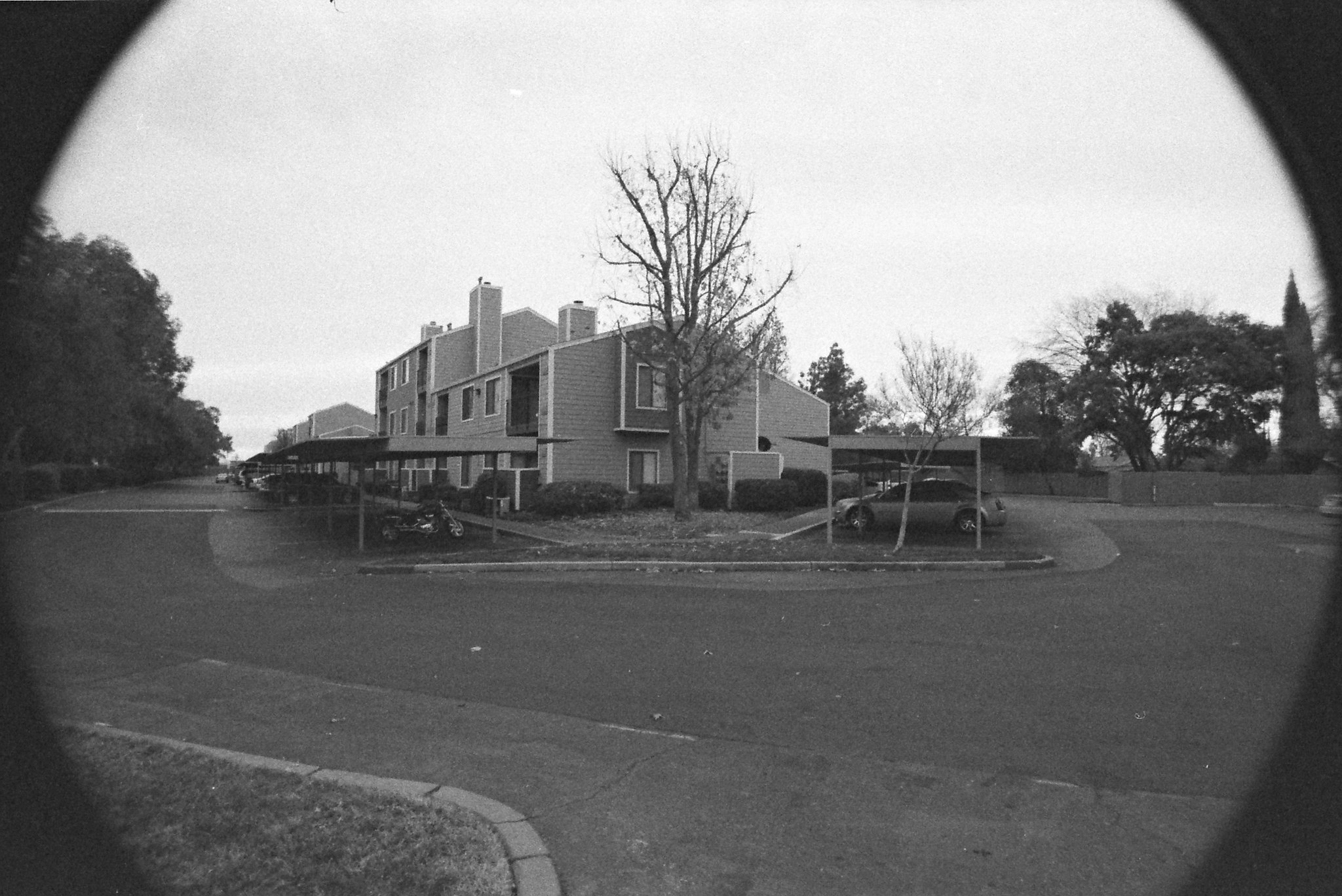

Here, by the way, is the result going the other way, of mounting the stock 18-55mm lens from my D3200, which, of course, is a DX lens, on my F2, which uses a full 35mm frame. I only took this one picture, with the lens zoomed at 18mm, and you can see that it fails to cover the whole frame. Interestingly, as I observed through the F2's viewfinder, as you zoom it toward the other end, it covers more and more of the frame, covering the entire frame before you get to the 55mm end.

But what a nice result can come from a little cropping. I had this result as well trying DX lens on the D750 when I first purchased it. That led me to acquire the 28-300mm FX that I have now and hope to use on my D500.
Thanks for the info and the example.
