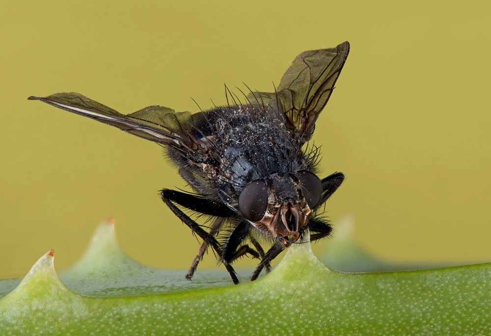

ControlMyNikon and CombineZP (free but only does jpeg's)
10 images with D800/105mm and Kenko extension tubes = 180mm
Two strobes from the sides, background is a yellow dish towel from Lee Valley, prop is a piece of aloe vera plant.
Roughly half of the original image size. I process the raw files, save to jpeg and then stack.
In ControlMyNikon set the start/stop depth and number of images. Click the shutter and it does the rest..
Cheers, Don

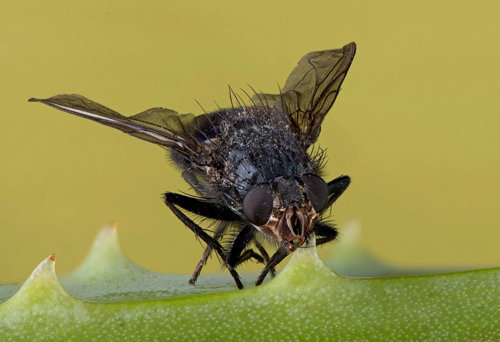

Cheers, Don
