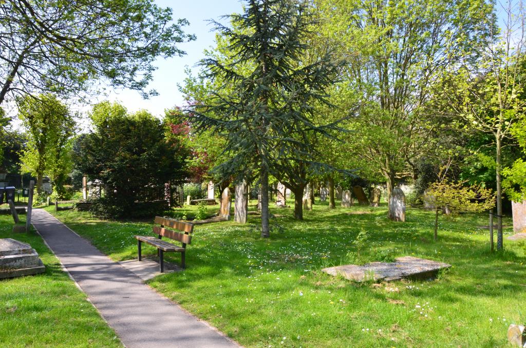

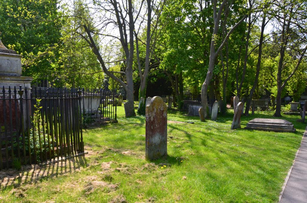

OK Many thanks for your patience. I did a test this morning and will try to attach the three photos here. On each of the three shots the lightening bolt symbol in the bottom right corner of the viewfinder was flashing. (I took other shots where it was not flashing in the same area also) In the Custom Settings Menu the Exposure Delay Mode is set to off.
I do try to see and remember the settings as I take a photo but they are only in the viewfinder for seconds and I am sure I would forget them before I had time to write anything down
1) Exposure 1/400 - f/10 - ISO800
2) Exposure 1/400 - f/10 - ISO800
3) Exposure 1/500 - f/11 - ISO800
Thanks very much all for much needed assistance. DSC_6302.jpgDSC_6301.jpgDSC_6300.jpg

This is no doubt very frustrating for everyone. :) There is no reasonable explanation why the Flash-Ready indicator would blink in bright sun when the flash was not being used. There is even less reason why it would do this in P mode but not in A mode. No one will know why this time, we simply need more info about the situation. Aperture would be about the only candidate, but Auto ISO could affect it. As is, we know nothing. Frankly, it is sounding like a camera defect. Certainly it is not normal operation.
An experienced troubleshooter with access to the camera (like a repair shop) would try different things, hoping to chance onto any additional information that might show some possible cause.
Short of that access, it would at least be be good to see the Exif data (the complete data).
The camera records in the image file just about every possible setting that was used. This is called Exif data, and most photo programs show it, or at least some of it. However, when Adobe programs rewrite the file, some of the Nikon data is omitted then. And worse, when Adobe programs save it with the File - Save For Web menu, they omit ALL of the Exif data.
Also, even if present in your image upload, some posting host sites strip away the Exif data. I am not sure about this site, but it certainly does appears to strip it, at least I have never seen an exception here with the Exif data. So sorry, I doubt posting the image here can help. If you could post it on your own web site, the Exif probably would show.
So... it's very difficult to know more than what you can tell us.
You did post guesses about exposure, but frankly, if ISO 800, Sunny 16 says f/11 would be about 1/1600 second shutter in bright sun. That would be the normal expectation. But you said 1/400, and that does not compute. There are some darker areas in your pictures, but the bright areas mostly do not look overexposed.
Also the big key would would see data for BOTH the P mode case when it blinked, and also see the A mode case when it did not, to try to find out what the difference was. There must be some difference. In camera A mode, you set aperture yourself, but we have no clue what it was. Seeing the Exif data can only help to know what the situation was.

File type: JPEG
File size: 9,707.9 KB
Creation date: 19/05/2013 10:51
Last modification: 19/05/2013 10:51
Make: NIKON CORPORATION (Nikon | Home)
Camera: NIKON D7000
Lens: AF-S DX VR Zoom-Nikkor 18-200mm F3.5-5.6G IF-ED
Software: Ver.1.03
Dimension: 4928 x 3264 px (16.1 MP, 3:2)
Focal length: 18 mm (equiv. 27 mm)
Aperture: F11
Exposure time: 1/500"
ISO speed rating: 800/30°
Program: Normal program
Metering Mode: Center-weighted average
White Balance: AUTO1
Focus Mode: AF-S
Image Stabilizer: On
Noise Reduction: Off
Flash: Flash did not fire, compulsory flash mode
[Image]

Thanks JJM. Sorry, I still puzzled, but if Nickt says he sees it too, it must be a normal thing. My D800 and D300 do not have the D12 Fash Warning D12 menu, and I cannot make them do that flashing. Something new I guess, and I can believe other models might do it.
This image was 1/500 second, and the internal flash can never work at 1/500 second (external flash models can, but sync there requires Auto FP for even the shutter to work). If the internal flash were used, shutter speed would drop to 1/250 sync limit (menu E1 actually), and P mode would adjust the aperture accordingly. A different flash could be used though, and P mode could have shifted gears for (a different) flash, but a flash warning at 1/500 second seems unreasonable to me.
I rarely use P mode, but I could believe that maybe P mode is trying to offer more automation and help, where A mode does not? Camera automation is generally pretty dumb however. Meticulous maybe, it knows how to do what it does, but it is dumb in that it has absolutely zero human smarts about what the scene is or what it actually needs. The human photographer can be a huge help.
So far, it sounds like the solution is to turn OFF the D12 Flash Warning menu?
The Exif was from image number 6302, which was the first of the three images you posted. Says Program mode, ISO 800, 1/500 second, f/11, center weighted meter. I don't see anything odd there. I like Center metering best myself. Center metering was offering an averaged reading on the left dark and right bright areas of that center column. Seems just right.
We don't know what the Camera A mode Exif said, or how it might be different than this one, but much difference seems doubtful except aperture and shutter speed. So far, Nickt's theory sounds best to me.
