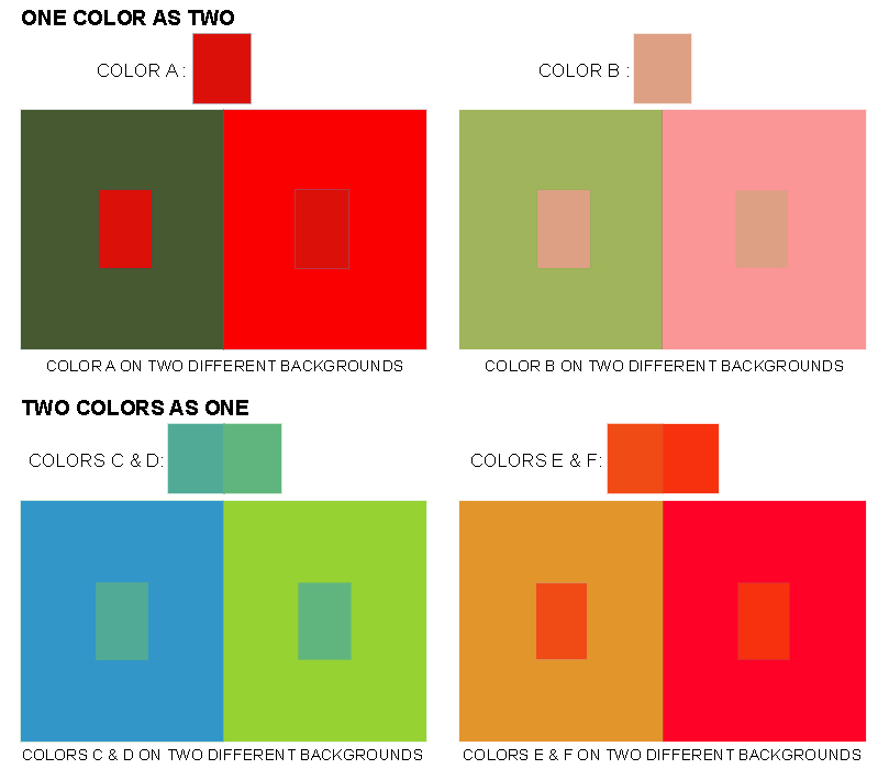

Here is an interesting color experiment from this class:
One color as two:
Notice how the red color "A" appears to be different when placed against these backgrounds? The same with color "B". This experiments shows that our eyes make a color's overall distinction in comparison to its surroundings.
Two colors as one:
The opposite is also true. Colors "C" and "D" are different, but appear to be the same here. So do "E" and "F".
