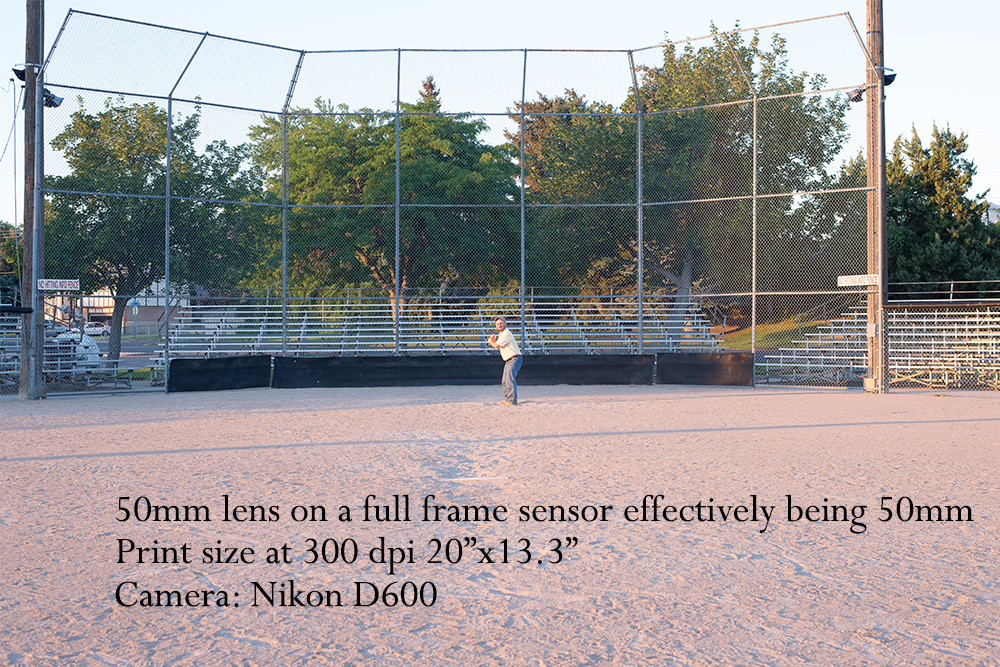

This image is a 50mm lens on a full frame sensor capturing the full image from the lens.

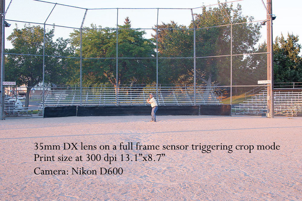

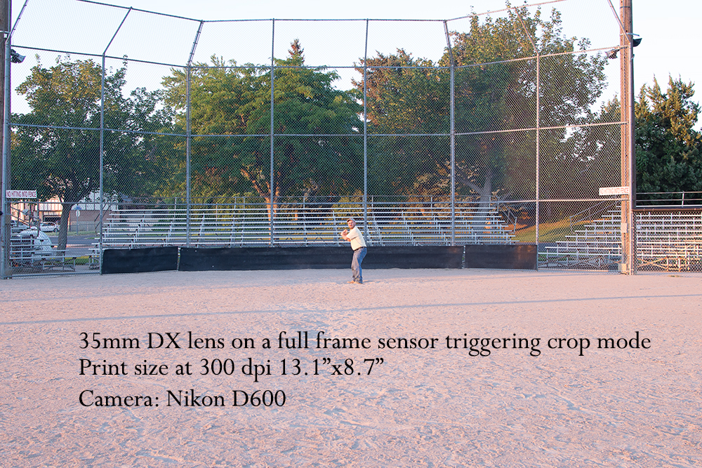

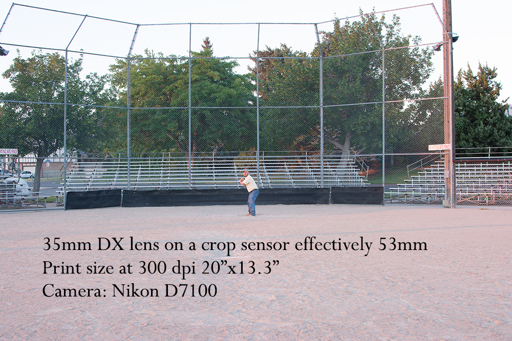

This image is a 35mm DX lens on a crop sensor camera. The smaller sensor at 24mp allows for this image to be printed at 300dpi (high resolution) at 20"x13.3".
Putting this same lens on a full frame camera, triggering a crop mode, gives us the same image. However, due to a small portion of the image being used there are fewer megapixels coming into play. This image has a high resolution print size of 13.1"x8.7" at 300dpi.

This image is a 35mm lens on a crop sensor. Effective zoom due to a crop sensor is 53mm.
To achieve the same "zoom" of a crop sensor we must use a 50mm lens on full frame.
The difference between a 35mm and a 50mm lens may not seem like that much. But, when you are talking serious telephoto reach it become quite substantial in reach and cost to achieve the same image on full frame. A 500mm lens on a crop sensor effectively becomes a 759mm lens. To achieve the same for full frame you're shopping for an 800mm lens. In other words, a crop sensor gives you free additional reach through the "crop factor." However, it bears repeating, there is no actual mechanical zoom happening.

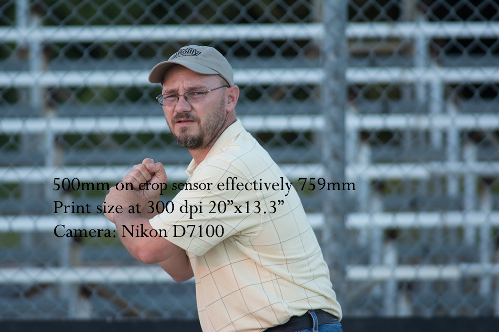

Putting a full frame lens on a full frame camera gets you the effective zoom listed on the lens - 200mm is 200mm. As I showed above, triggering the crop mode on the camera with a DX lens loses a lot of pixels. Further pixels are lost when you crop down on the image you want such as sports. Generally, sports shots are cropped tight. for this reason, when it can be afforded, FX lenses are desired because they can give you the additional "zoom" on a crop sensor camera and on a full frame camera pixels are not being lost through the triggering of crop mode.
This image is an FX lens (500mm) on an FX camera and cropped in tight for a sports shot. High resolution print size of 6"x9".
This image is an FX lens (500mm) shot on a DX camera and sports cropped. High resolution print size of 9"x13". This is a substantial 3" and 4" difference respectively.

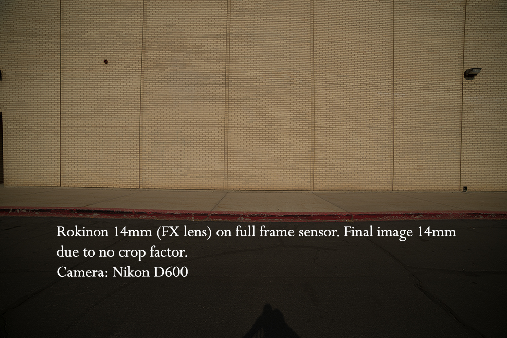

This image is from a DX specific lens: Tokina 11-16mm shot at 14mm. The effective zoom due to the crop factor gives us an image approximating 21mm.
This image is from a Rokinon 14mm FX lens. On a full frame it will give us a 14mm photo. Putting this FX lens on a crop sensor camera would give us an image like the image above because a crop sensor pulls a small slice from the center of the image.
