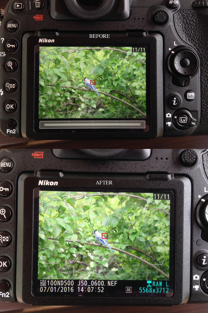

So I got a little deeper into this today. Normally I'll leave things so my Image Review will immediately show the screen with all the shot EXIF, small preview and histogram. Today, when I experienced the issue, I just had it set to show me the basic preview screen and instead of showing the file information at the bottom I got a gray line. After zooming in and back out the file information appeared. The image review still remained on until I reset it but after that it was fine. No write/card active light was lit.
I'll be contacting Nikon and letting them know, and send them this information. Not sure if it will do anything, but it's another piece of the puzzle.
On my D500 this grey bar appears when you touch and hold the bottom of the screen. You can then slide your finger left and right and scroll through images. The moment you lift your finger the bar disappears. It seems that your screen thinks something is touching its bottom (err.. sorry) all the time. Could it be your screen protector messing up with the screen?
Could it be? Yes, I think it could. I thought I spent my first day shooting without it, but what do I know. At least I know what that bar means. LOL I'll take the protector off and see if that helps. Never thought of it. I suppose I could also turn off the touch screen too. Hmmmm.

And second it would seem that the Kenko screen protector I have is the likely culprit to the problems both this time and previously. I'm not yet 100% on this as I am quite certain that I experienced the image review not shutting off with this camera before reapplying the protector, but I'm convinced that the gray line issue noted is from it. I've removed the cover and will be testing it out.
Touch screens work off of conductivity so that could be it. Once you are sure, then notify Nikon so they can warn everyone else.

Is it "solved"? No. But I believe the cause is identified. After removing the screen protector I still experienced the lack of a time out. Without letting it time out I then took a lens cloth and wiped the screen clean and it timed out properly. My take is that the touch screen is extremely sensitive and, perhaps, reacts to other surface conductors - like skin oil from a nose or hand touching it (or perhaps in this case leftover adhesive from an old screen protector). This is all stuff I can live with. My main purpose in posting about this was understanding the potential cause for the issue, not to in any way complain about what was happening.

I seem to have not posted an update to this thread, but the problem is limited to the touch screen sensitivity alone. Screen protectors may or may not exacerbate the issue, but the culprit is skin oil on the screen acting as a conductor. With smartphones using this tech for ages it's amazing that Nikon has managed to implement one that goes right up against one of the oiliest parts of the body (the nose) and managed not to compensate for this.
Anyway, I've simply turned off the touch screen and haven't had a problem since.
