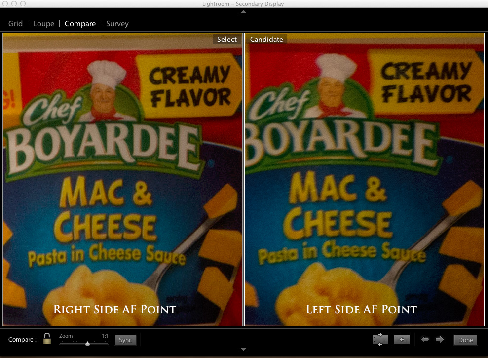

I don't know why Nikon would act as if they haven't seen the left side AF issue or don't know about it. They have a standard procedure for that fix whereby they connect the camera to their computer and rather than performing a standard AF check and calibration they calibrate each AF point individually and my understanding is that once that procedure is gone, all is well and the left side AF point issue is gone.

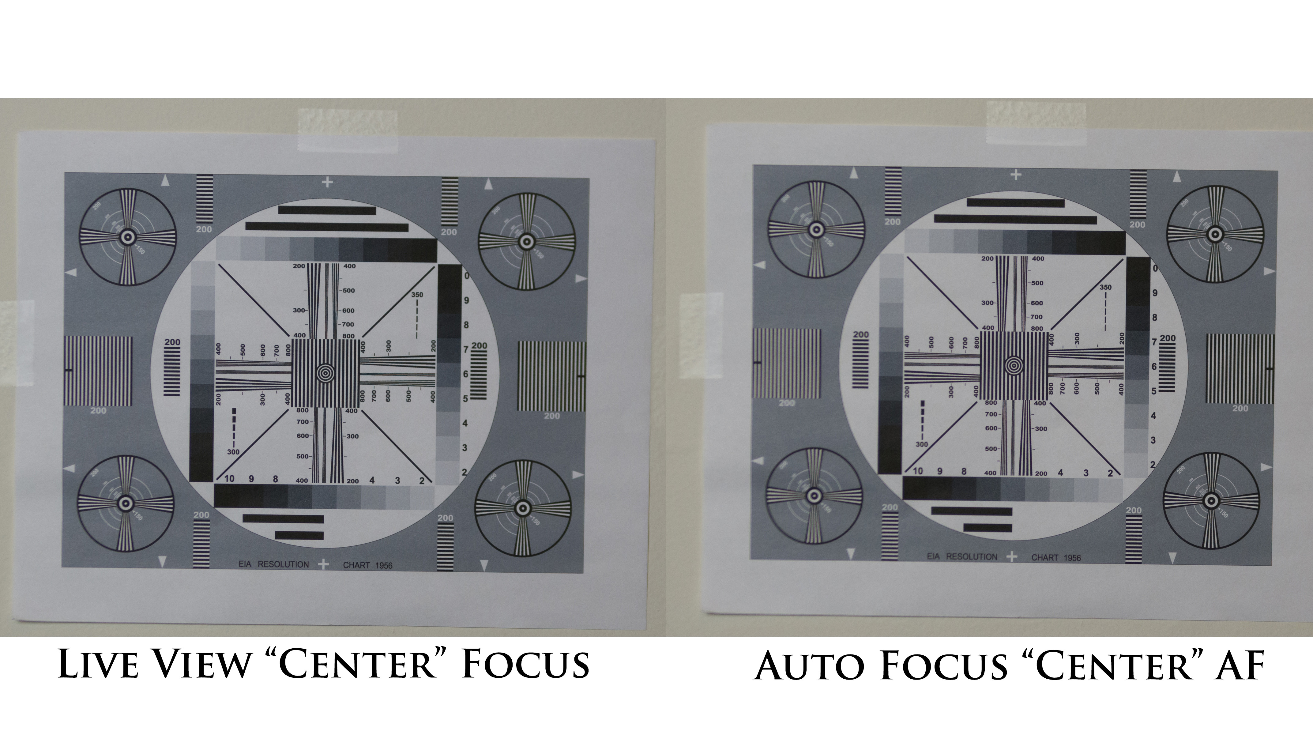

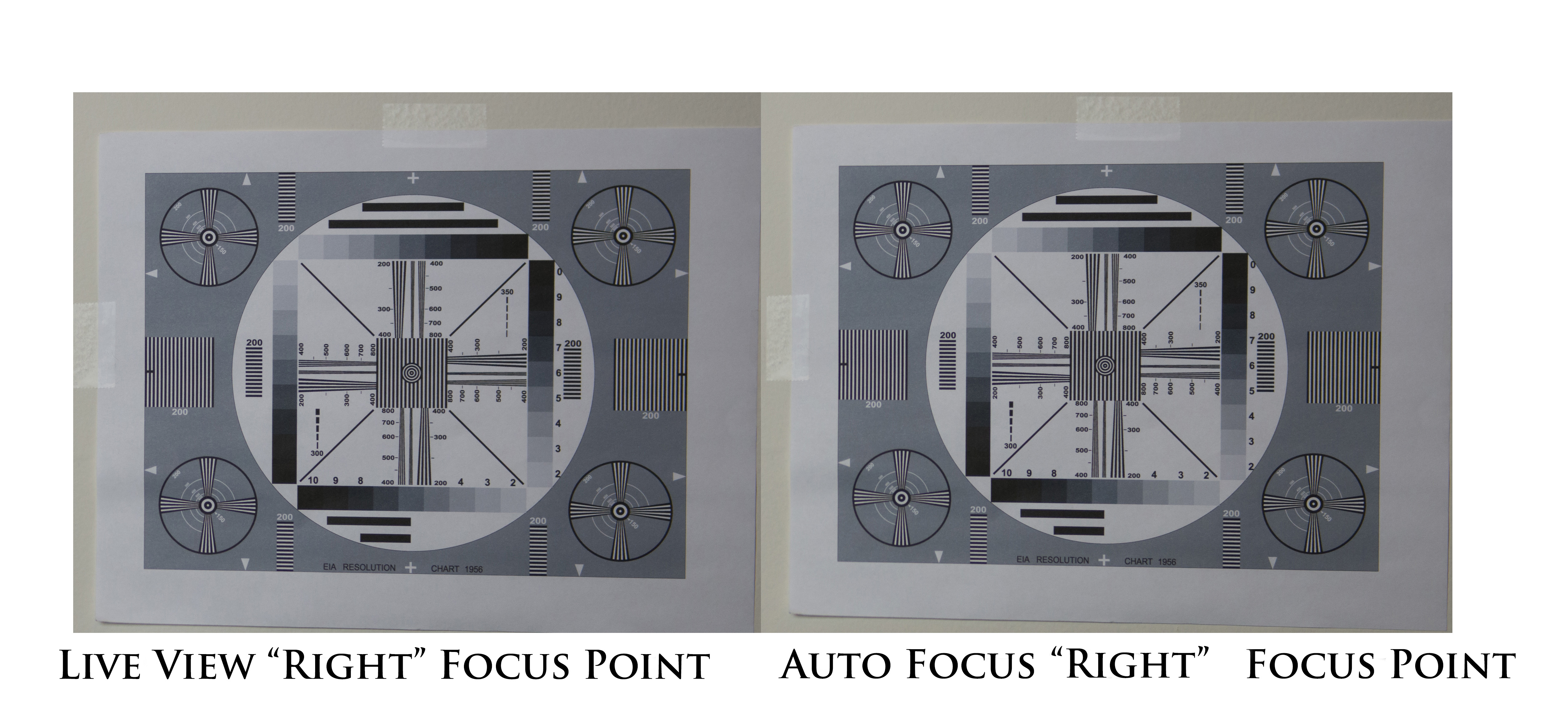

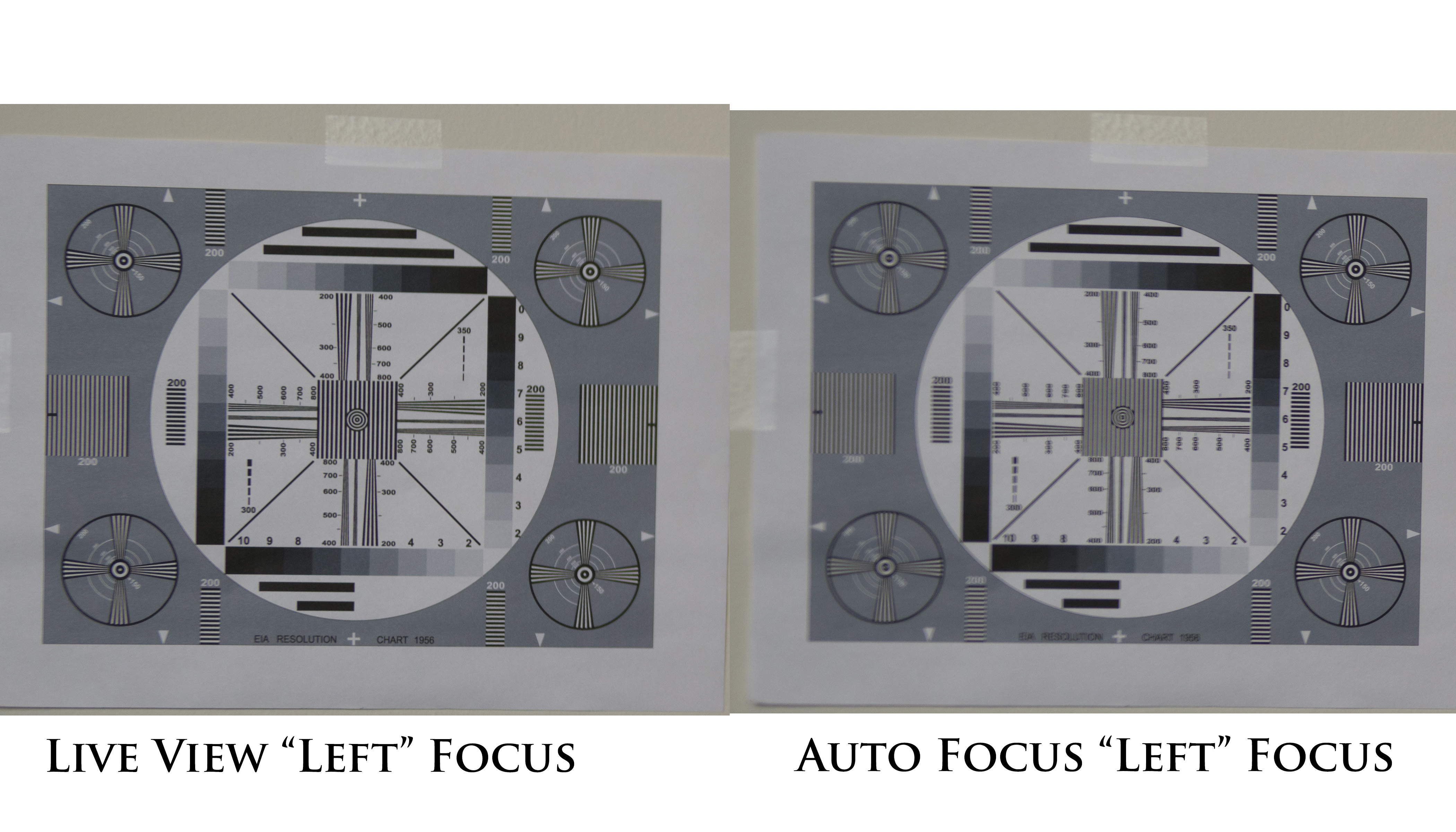

I just did a real full test. 50mm 1.4g lens test @ f/1.4. I did live view @ center, left, right. Then 3 shots @ center, left, right with AF. All AF shots are sharp. There is NO fluctuation between points. In fact, it seems the AF is sharper than the live view!
I did the same test with the "other" d800e, the one that i used until they fixed mine. It was blurry 2 out of 3 times, and the left side was bad. The live view was bad as well. So it confirms that Melville actually can fix these D800's and they actually know the issue exists.
Problems are being solved. I would buy another one now knowing I just have to drop it off for a week and its good to go!
