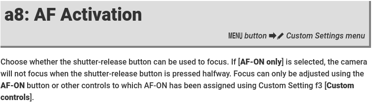

1. AF-ON button. In the online manual it describes that the AF-ON button can be reassigned, and I notice that the default customisation is as "AF-ON". What does this actually mean? I set it to AE/AF lock and got that working (so I can focus and recompose, with the item in focus outside of the focusing area of the OVF) but then realised that that's exactly the same as the AE-L / AF-L lock button just below it that I already have anyway, so that seems like a wasted customisation option. Anyway, what does the default AF-ON actually mean?
Default
a8[AF activation]
Shutter/AF-ON

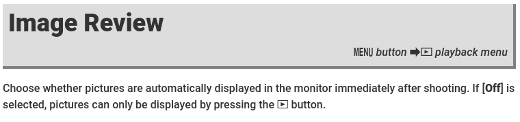

3. How do I make the camera automatically view a photo on screen after taking it without having to press the playback button?

So concerning the AF-ON button, it says if AF-ON only is selected.... so, does that mean that if AF-ON only is not selected, then the button does nothing?
In the default setting both the shutter button and the AF-on button operate the AF. When testing on 810 the shutter over rides the AF-on button so if you focus and recompose the shutter button will cause it to attempt to focus again. The AF only setting disables the shutter AF function so the AF can only be initiated from AF-on button. Should be easy enough to test if you disable the AE/AF you mentioned you set the button to.

I just gave it a try.
Setting the AF-ON button to AF-ON (the default) seems to cause the focusing system to operator constantly as if the shutter is half pressed, so keeping it pressed and then pressing the shutter button makes no difference because it's already continuously focusing.
Setting the AF-ON button to AF lock only seems to give the desired effect of a back button focus for those who don't want to commit to back button focus. Basically you still have to half press to focus, but, if you then press the AF-ON button the focusing system sort of "disconnects" so provided that you keep pressing it you can recompose with refocusing.

If you auto focus mode is set to continuous it will continue to focus if the AF-on button is held and it thinks there is a need usually an slight movement of the camera. If you are set to the default AF activation and release the the button and press the shutter button it will again try to focus. To test use the AF-on button to focus o something close then recompose by pointing at something much further away and half press the shutter you will see it refocus.
To change from continuous to single focus (not single point) hold the AF button to the lower left of the camera and rotate the rear command dial, it will change from continuous to single and back as it is rotated.
