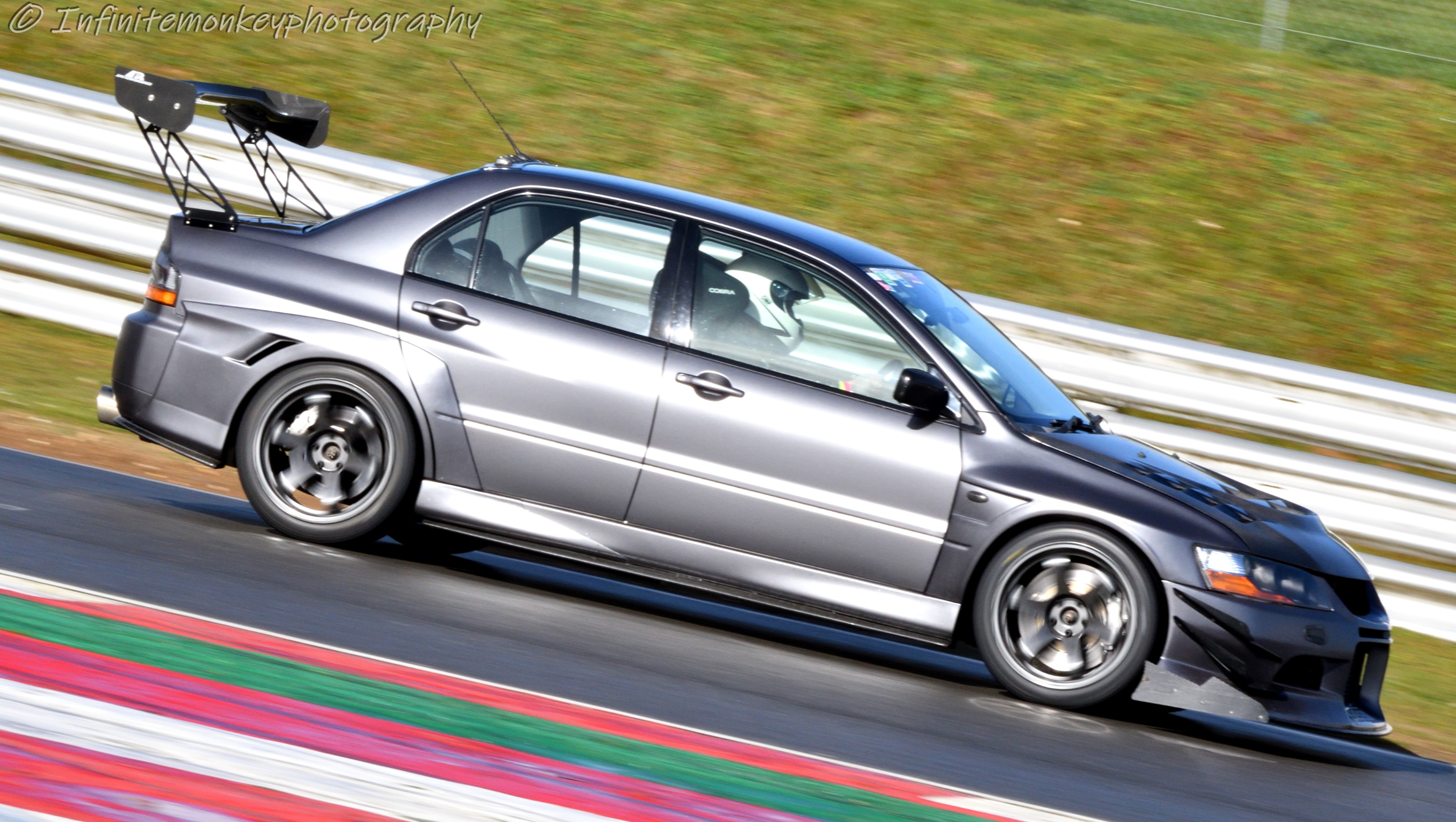

I got good results with the 400mm lens on my old D3200, such as this from Duxford last year. Going up to 1/400 with the prop driven warbirds I mostly photograph will lose too much motion from the props.

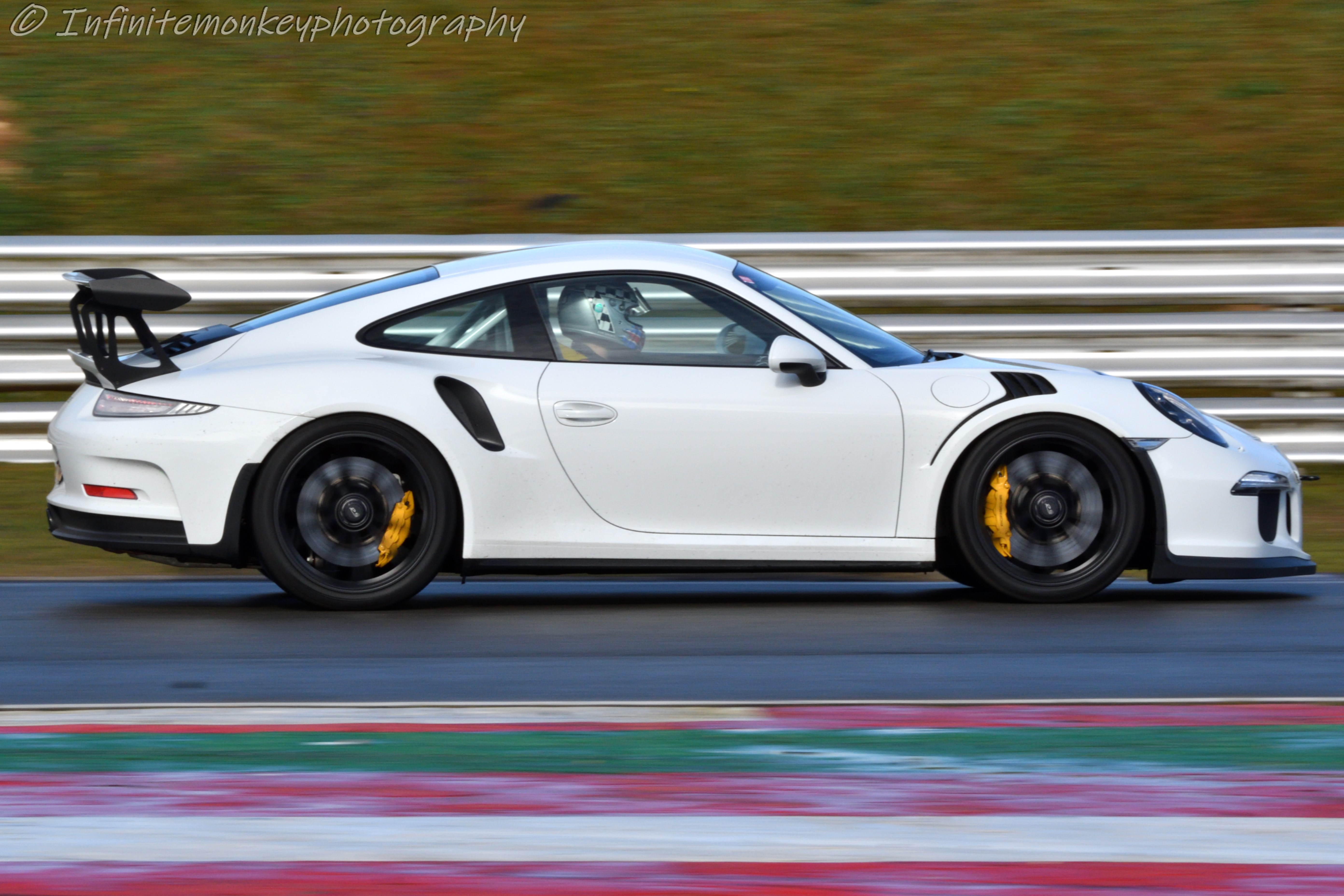

And from Brands Hatch

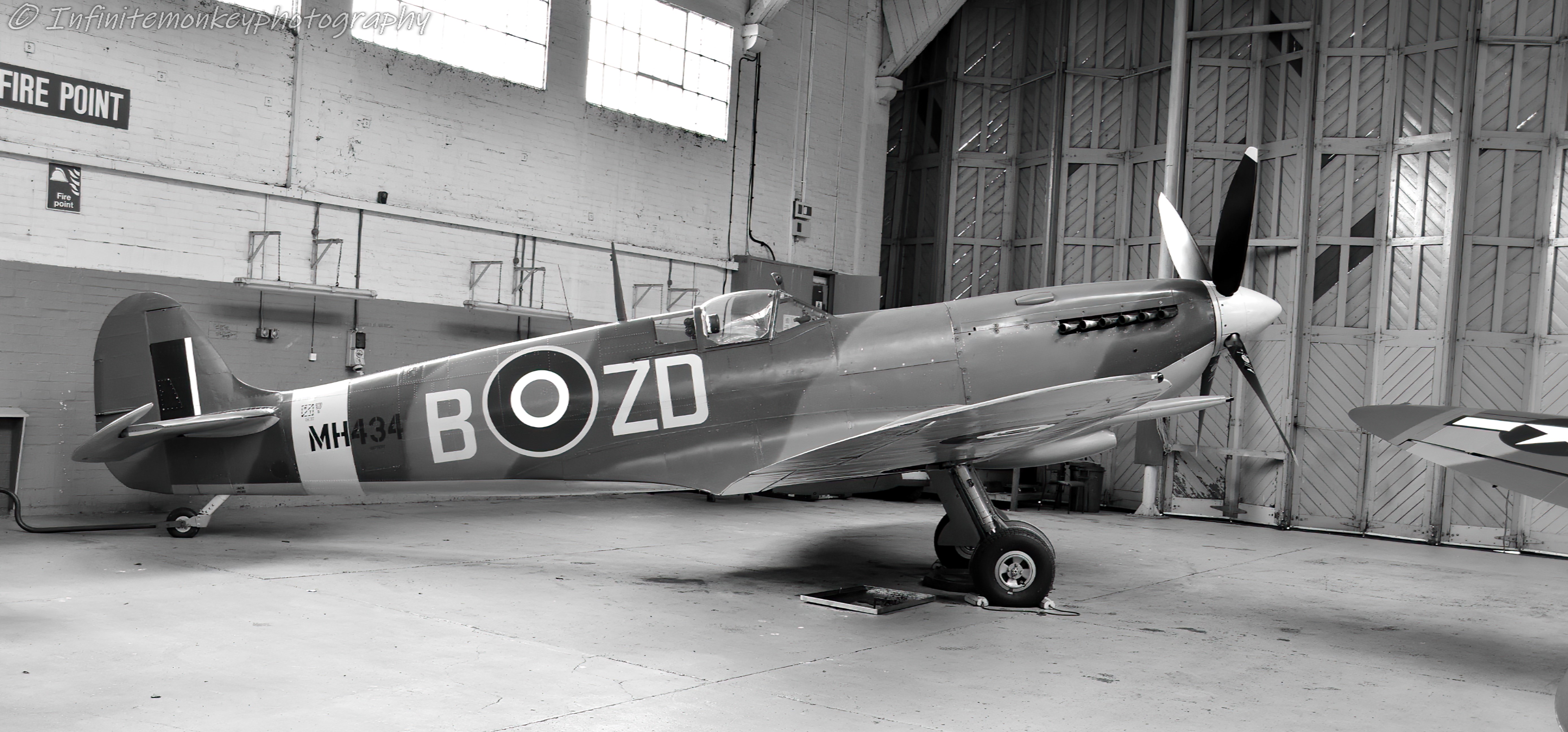

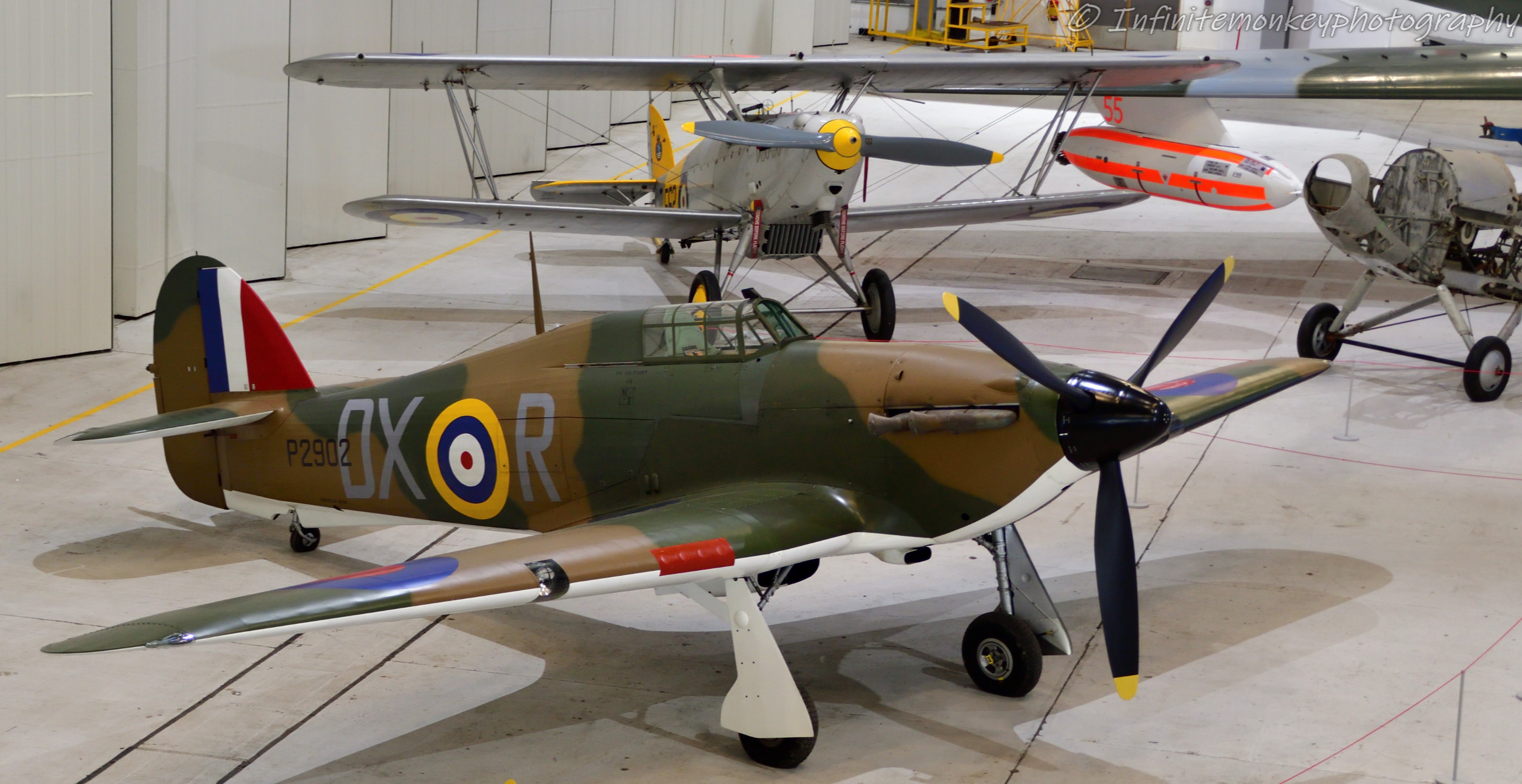

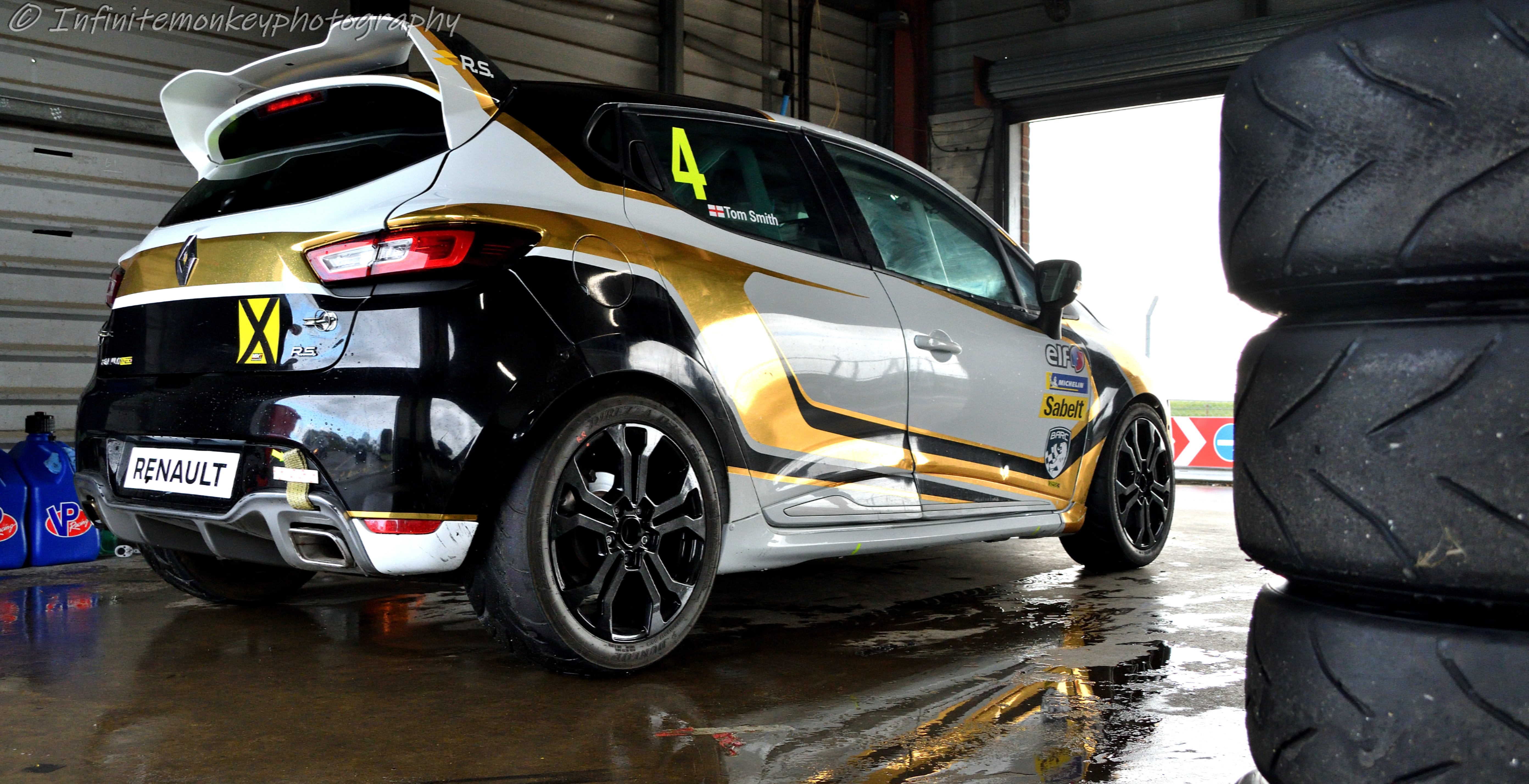

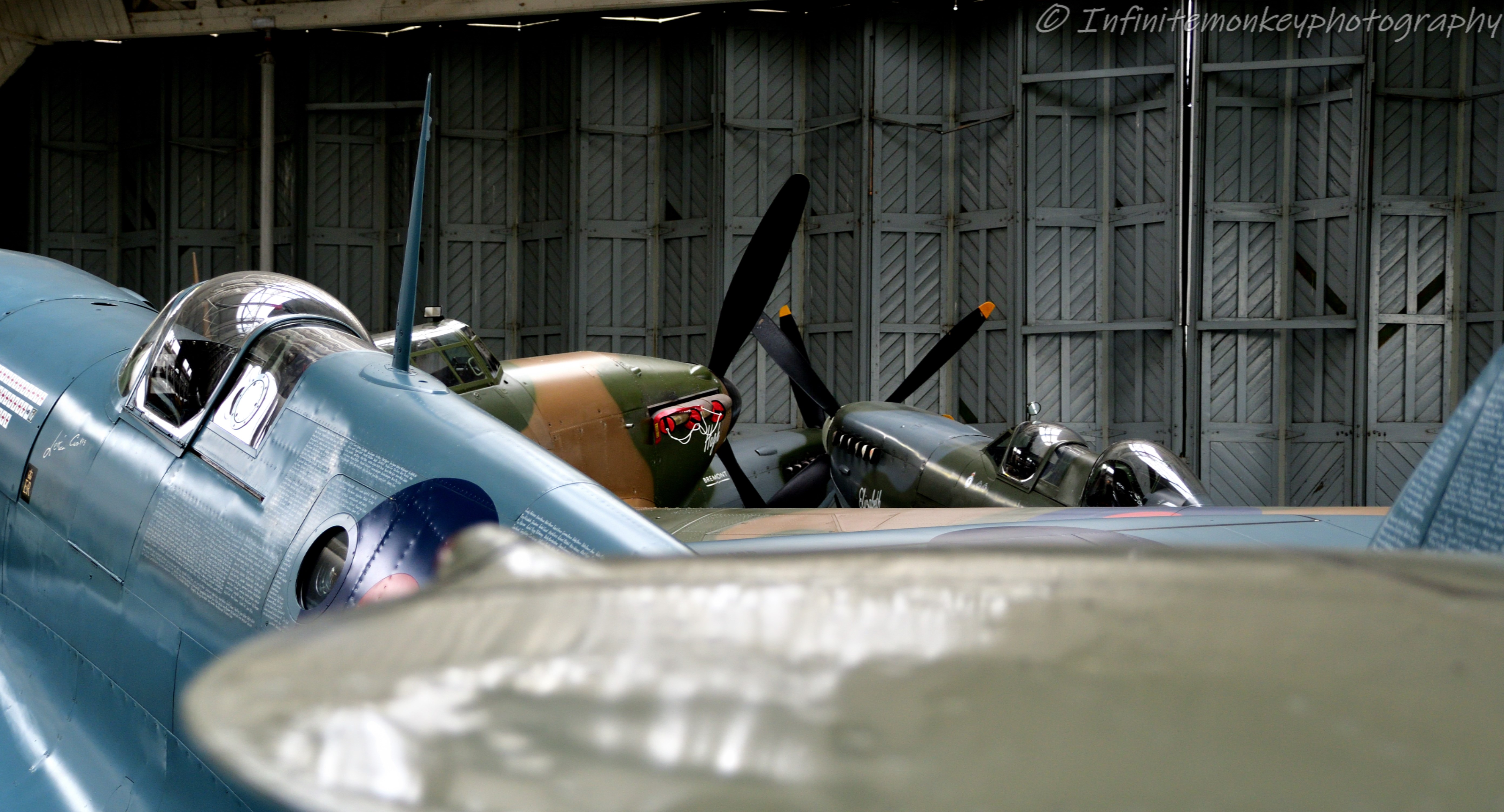

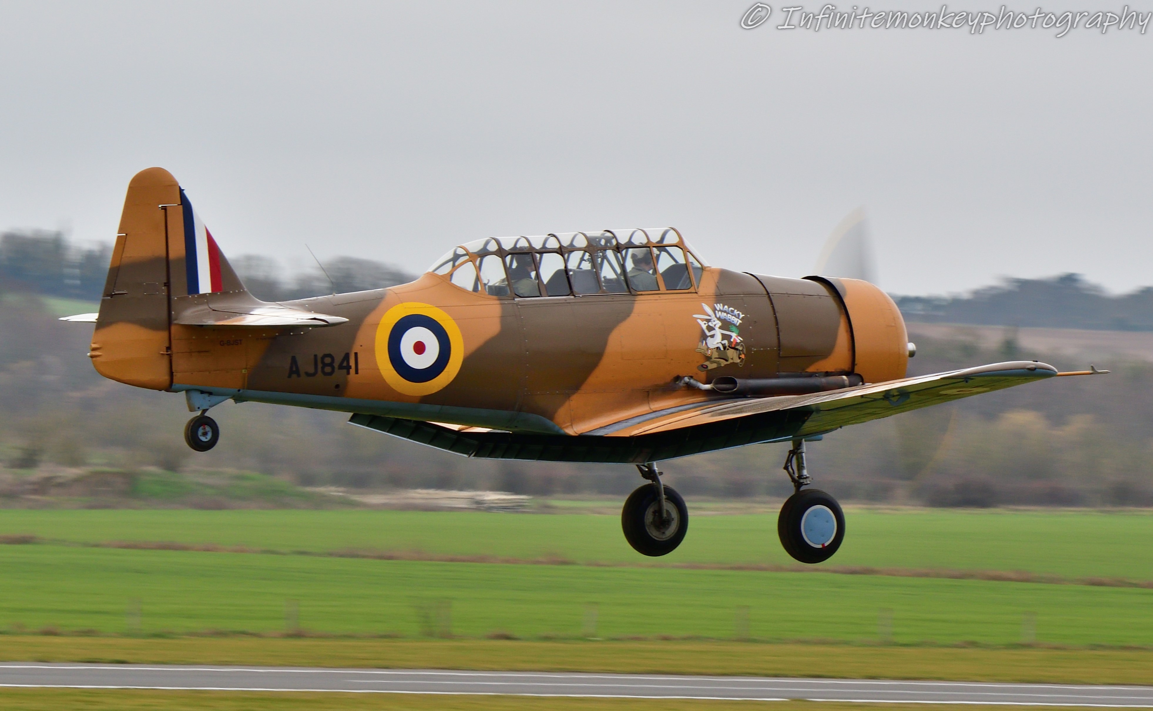

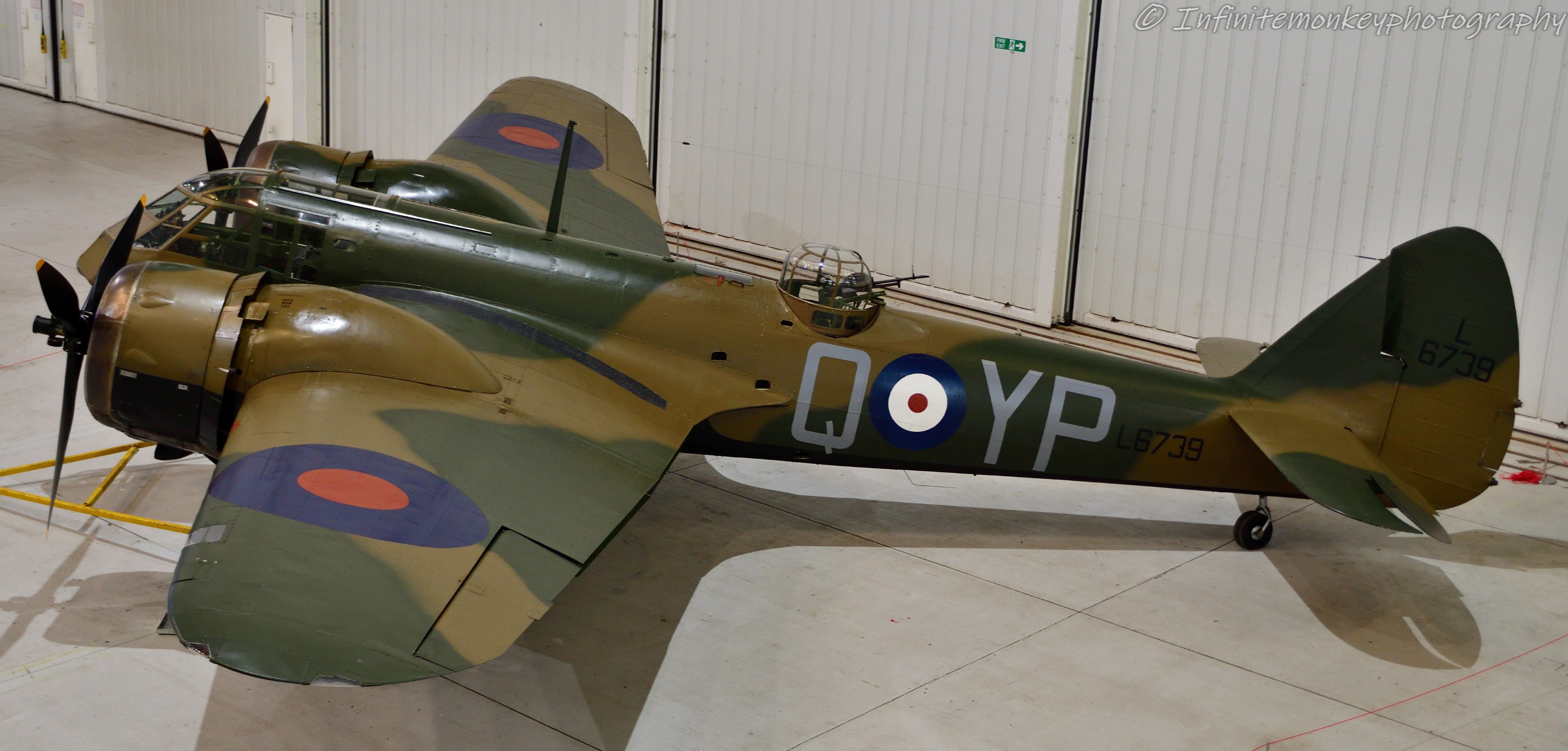

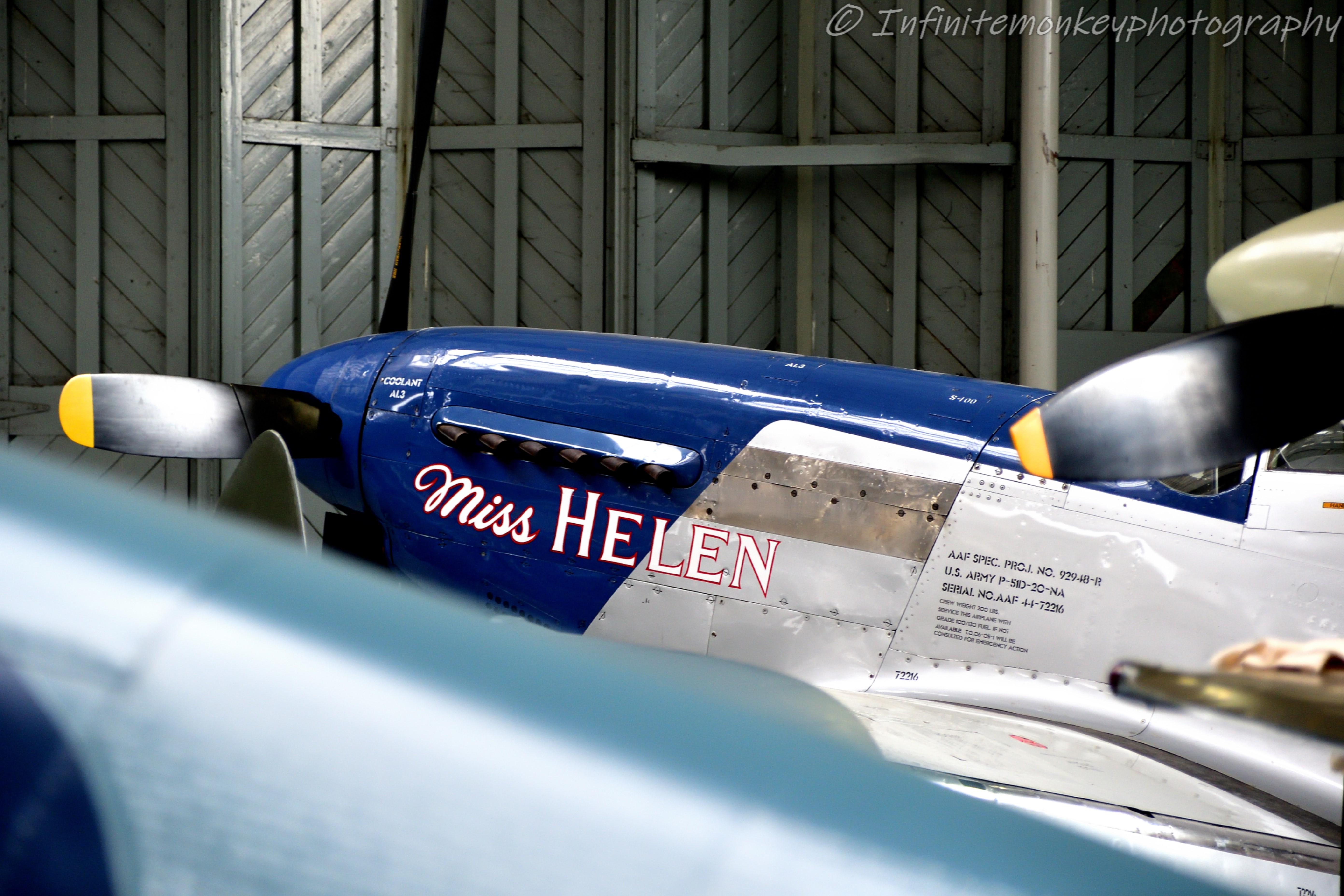

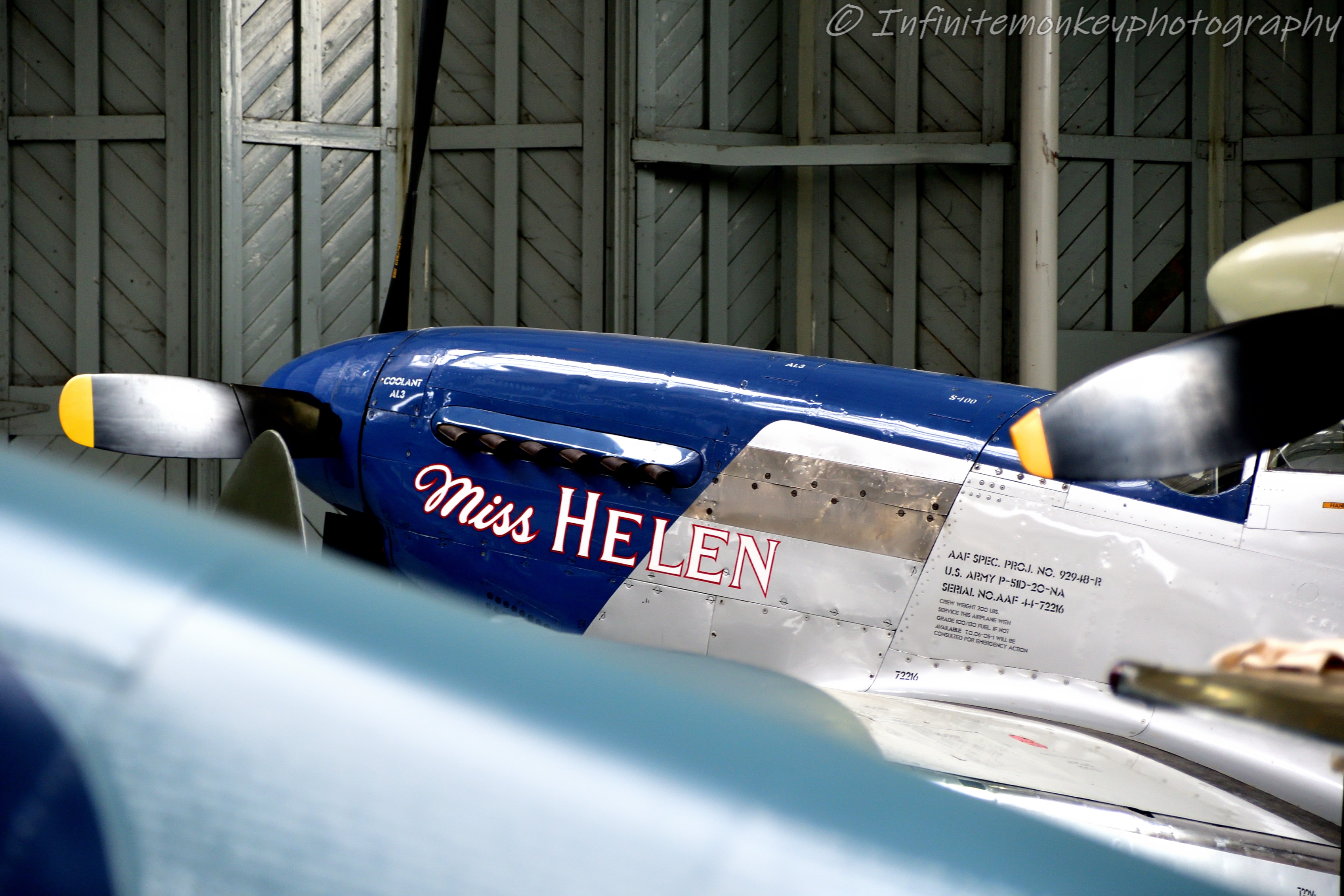

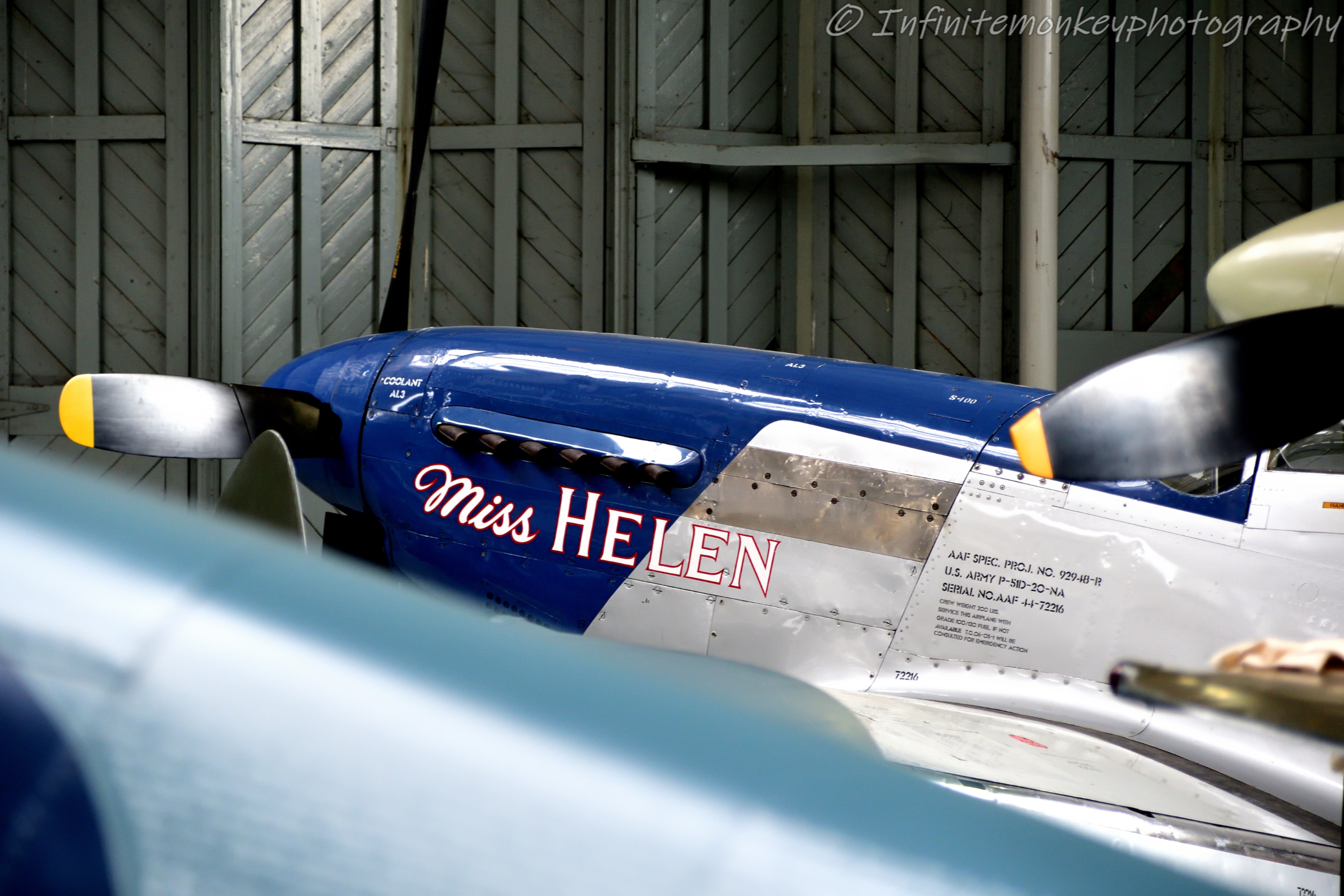

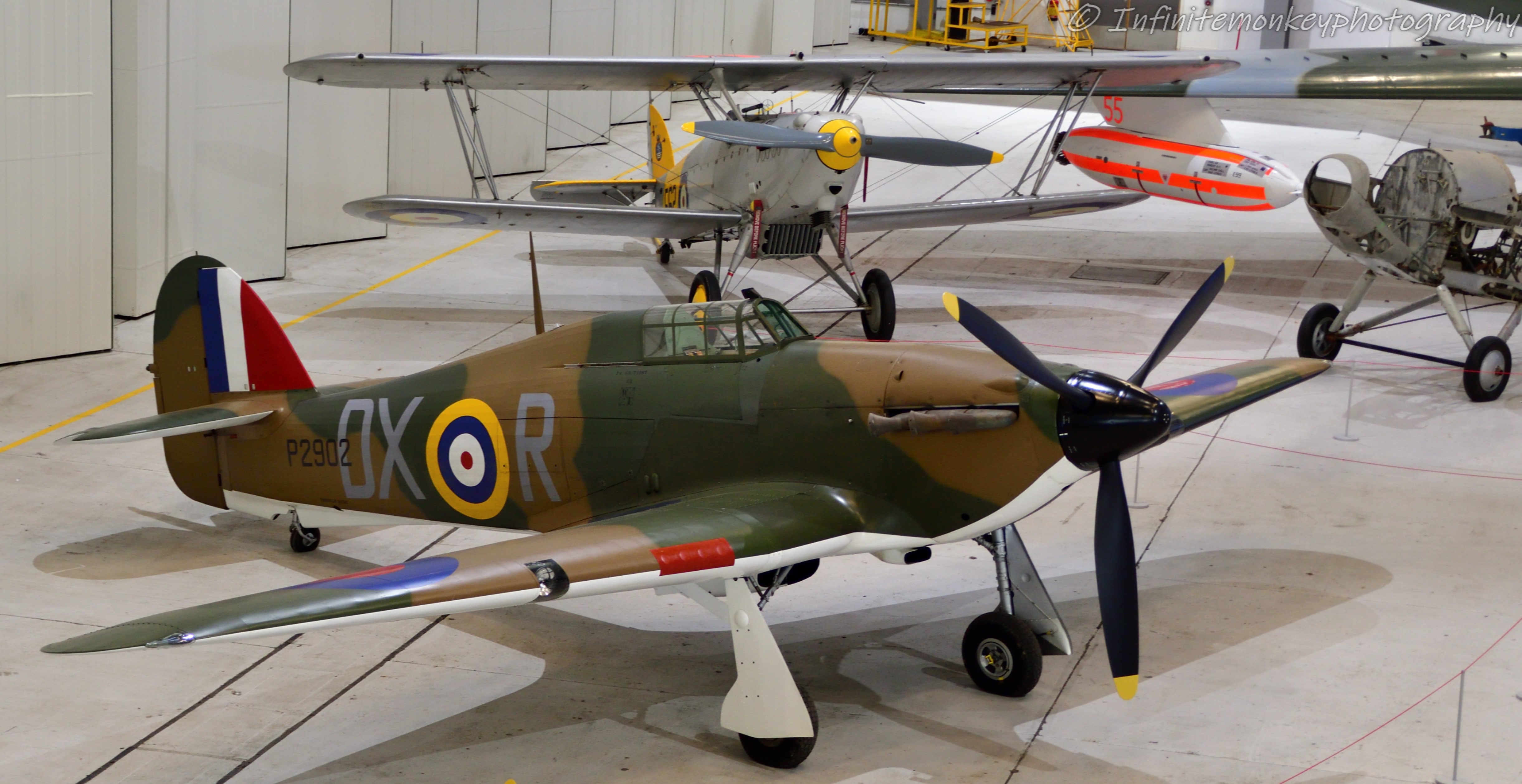

Here's a few of my results from the first experiment on Saturday. The hangar was very poorly lit, and on the ISO I would have used with the D3200, the shutter speed was too slow for handheld; ramping up the ISO past where the noise levels on the D3200 would have been unacceptable quickened the shutter speed to a useable point, without too much noise. It did seem though that the VR wasn't as effective or noticeable on the D7500 with my Tamron 18-200mm lens? Or perhaps it's just quieter and less obstrusive in operation on the newer and better camera?
The picture of the Harvard landing is the only here taken with the 400mm Tamron, and it was one of the few worthwhile shots. I've read elsewhere that turning OFF the VR, whilst counter-intuitive, actually helps the autofocus?

Nice plane Photos Robstopper. Was the D7500 camera with the Tamron 18-200mm lens used for most of these photos (I know the Harvard landing was taken with the 400mm Tamron)?
robstopper
Yes sir, all on the D7500, with the 18-200mm, except for the Harvard.
It was my go-to, catch-all lens on the old D3200. I know the lighting wasn't the best, although it wasn't atypical for Duxford's hangars, but it didn't seem to be as trouble-free, effortless photography when mounted on the D7500.
