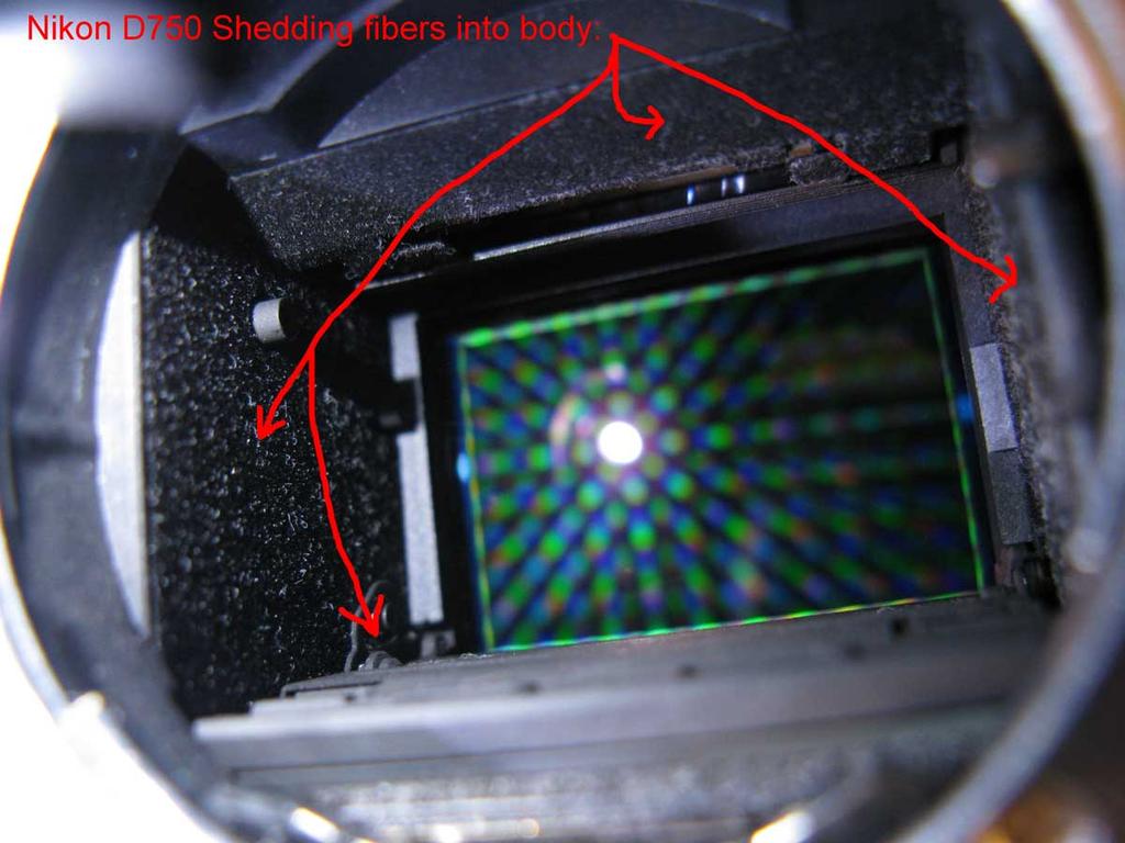

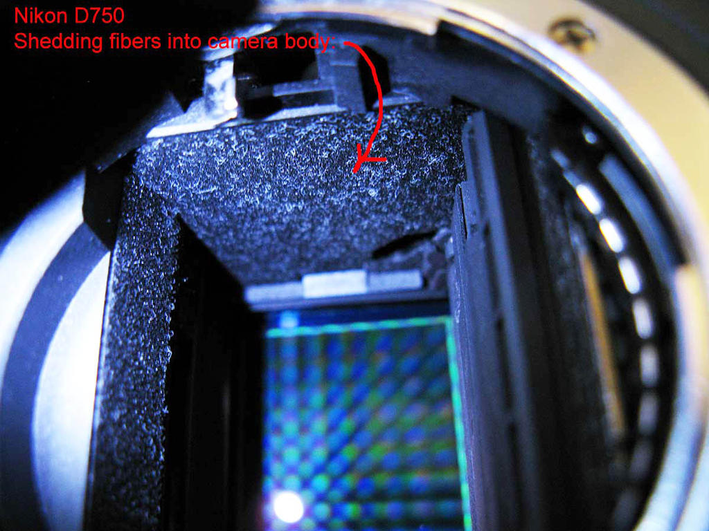

Re: D750: Unable to Clean Dust off Sensor - some progress
I've made some progress on sensor cleaning but I'm now a little concerned: When I got the problem in the field I didn't take much notice of what kind of 'dust' was on the sensor and only when I got a 4.5X illuminated magnifier could I spend more time. I've cleaned, blown, swabbed, blown and checked my work shooting my lcd monotor at f22 and opened up the test shots at X100 mag in PS. I defy anybody to get a perfect spot free sensor result, whatever cleaning method they use! I think F11 will be my aperture of choice in future and I'll fit ND filters if I have to.
I got a pretty clean sensor (not 100% perfect spot free, but I can't see that is realistically possible and would remain so) then dropped the mirror and fired off a few shots, went back and looked at the sensor which now had 'foreign bodies' on it. I looked carefully and they weren't the round grey dust particles or hairs I might expect, but 1 or 2 black wiggly filaments.
My D750 mirror compartment is lined with a black non-light reflective material. It recently came back from its shutter recall and I don't know what that involved (?) When I got it back they said they had cleaned it for free. What I saw on the sensor (and through the illuminated magnifier) was black filaments which could only have come from the material used inside the camera body. I accept the common DSLR problem of dust getting in from outside although I don't often change lenses, but black filaments falling on the sensor from inside the camera is not what I expected. During sensor cleaning I was very careful not to touch the lining as I could see it had a coarse fiber surface.
Have Nikon always used this coarse anti reflection stick on stuff in their cameras? I can see an area where it is cut away for the mirror hinge and the cut has left long filaments hanging loose which I could pull off with tweezers although a few mirror slaps and they will probably will fall off!
If your D750 is like mine and you get 'sensor dust', have a look at it with a magifier and if it is jet black you can guess where it might have come from. After cleaning your sensor, fire off a few shots then go back and check it has stayed clean. If you see 'dust' on images in post that is highly visible and curly, don't assume it is a hair from outside and just one of those things you get with a DSLR.

Re: D750: Unable to Clean Dust off Sensor - Contamination coming from inside camera!
I'm surprised nobody has come back on this?
I'm trying to get an answer from Nikon and still do not know if they applied the black Velcro type finish to reduce flare as part of their mod. or it has always been there. Now I am also seeing the fiber filaments getting on to the mirror! This is NOT dust but being shed from the materials used in the camera body design, construction or Nikon modification. Considering all the clean room assembly done on cameras, it seems stupid to introduce a material into a critical part of the Nikon D750 camera body that appears unstable and can release contamination many more microns larger than the clean room standards used?
Using any kind of jet blower could make matters worse by stirring up more of the fibres lying loose on the surface.

voxmagna
Mine was the same until it went back to Nikon for the warranty recalls. Have a look at my photos attached. Has your D750 body been back for the recall fixes and does the inside look like my photos if you look with a magnifier?
