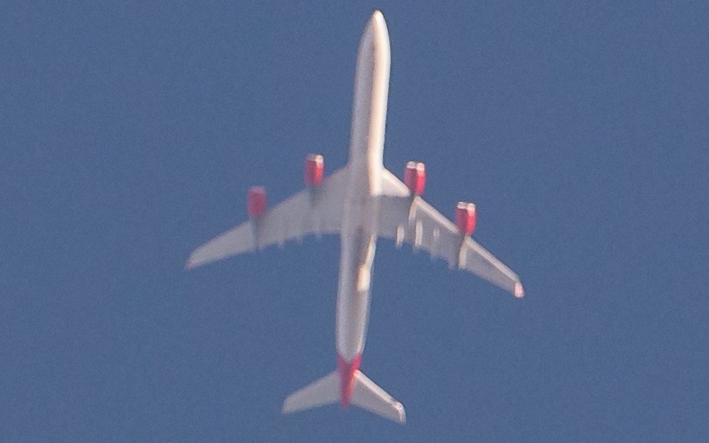

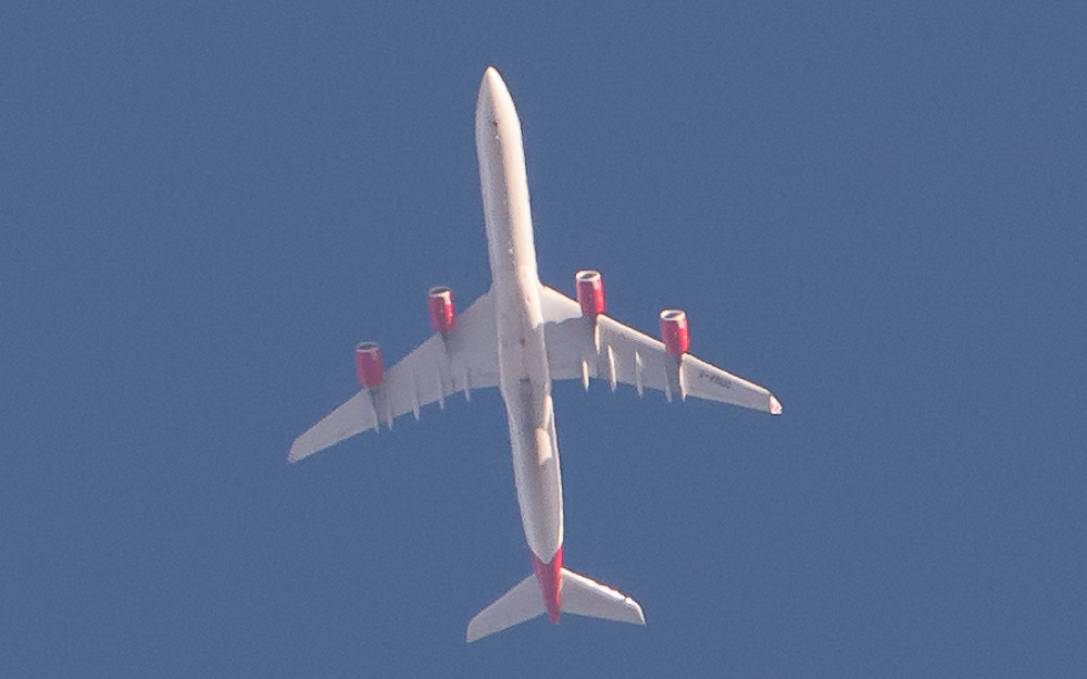

D7100 Inconsistent Focus Tracking Errors
Paganman2
And a static again with AF-A
P.
Eyelight
These were both taken within a few seconds of each other with exactly the same settings, the only difference was with the first one i just shot the plane without following it with tracking, in the second shot i followed the plane with the center focus bracket on the plane, but as normal it was not locking focus as the focus confirm brackets were dancing like crazy.
Bot these shots are 100% crops direct from Nef files and both have had exactly the same editing done - noise control sharpening etc, so in theory they should look exactly the same.
Any ideas folks please...
Pag.

Paganman2
What happened between the two shots was - i took the first and sharp one, then brought my camera away from my eye, i then decided while the plane was still within range to take another shot as it was getting more overhead at this point, i put the center focus bracket dead on the center of the plane belly and followed with the plane for a few seconds to let the Vr settle, then i breathed in and took the shot and held focus on the plane even after exposure.
