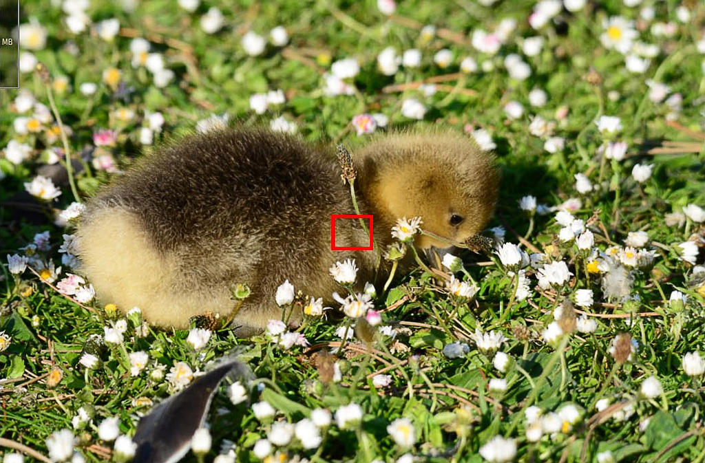

This is the image i was trying to capture when the freeze occurred,the bird is on a embankment which slopes steadily away,it was fairly close but not too close,after the refusal to focus on the bird i pointed the camera about 15/20ft beyond the bird still nothing,switched off and on and it worked,as you can see the lighting should have caused no problems and it didnt after the freeze.
I wish i could find out it was something i was doing then i could solve it,there is the possibility i may change it for another with a later serial number so i get the VC update just in case there is something else hidden in the update.
This is my focus point,it was placed there with me being close and the bird being at a slight angle and i wanted to spread the DOF over the complete bird.
I cant see it should have had any problem in this situation
