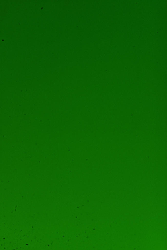

@hark: "too dark to be oil" ???? too green to be a leave??? too white tto be milk ???
"Plus there is an odd size elongated spot near the top--oil tends to be rounder" : this spot is just a place where three spots come together... But what you want to say is: ok 500 spots but a few of them are not oil but the 490 others are oil ???
Those darker spots do not look like the oil spots I had on my D600; therefore, I surmise the debris stems from something else besides a faulty shutter. As someone (maybe Dave_W) mentioned, some of us take precautions with where we store the body and lens caps rather than dropping them freely in the bag or placing them in a pocket. Any dirt or dust will easily transfer from the caps to the inside of the camera's body.
@sonicbuffalo: Dust ok, hundred of spots: not OK, the spots are the same as on my D600 (witch was replaced by a D610 by Nikon). Never had a similar problem with a D90 or D700...
Okay...this tells us that you've been through the process once before where you sent in your D600 directly to Nikon. So WHY are you asking for our opinion? If I was under the impression that my D610 had the same issue as my D600, I'd FIRST upload a photo to Nikon's site so one of their techs could take a look THEN possibly ask for the opinion of other esteemed members here. Obviously we aren't telling you what you want to hear. The bottom line is it does NOT look like an oil shutter problem to me. But rather than take my opinion or the opinion of others, you SHOULD ask Nikon for their opinion.
Please don't be surprised if they tell you it looks like dirt/dust. If Nikon determines it is dust/dirt, then I don't think they would cover it as a warranty repair.

It's a shame we all now live in a "post-D600" world where common sensor dust spots are now elevated to "oil" spots by new camera owners scared to death they may have a defective camera on their hands. While I have no idea how long the D600 oil-spot hangover will last, I can say that Nikon has only themselves to blame.
Perfectly put, Dave. "You reap what you sow."
sonicbuffalo_RIP
ok Dirka......I apologize but sometimes there are people who just drop in to stir things up....and then disappear. I am sorry you are having bad luck with yet another 600 series camera. How often do you change lenses, and do you do it outside or in as much of an enclosed area as possible. Everyone's habits are different, and who knows, it might explain things, maybe not.

after about 3 years into photography, I realise dust in sensor is something you got to deal with regardless of the brand or model. I am not sure about those that totally don't change lenses.
So the way to go is learn how to DIY on cleaning of sensor. Otherwise you just to send to the service guy on a regular basis. Cleaning the sensor is almost similar to cleaning your lens glass. Just need some extra care and that is about all. I did it after my 2nd try but the 1st is because I panic. The sensor is NOT going to be scratched unless you use something hard that can also scratch your lens glass.

So I started seeing same same on mine....blew it out with my Rocket Air, cleaned the sensor using type 3 SensorSwabs and boom - sensor is clean...no spots on any image that I can see....
TL Robinson
Mine is now in Nikon repair center. Using type 3 Sensor Swabs voids warranty... :(
Well - I have a clean sensor in about 5 minutes and no muss no fuss....I doubt they'd be able to tell if you used anything other than air to clean it if I had to send it in for anything else...but, whatever works for ya...

I have never needed to use the warranty on any of the Nikon bodies I have had. I wouldn't and haven't hesitated to clean a sensor and have never sent one in to have it cleaned. Sensor swabs and eclipse and if done correctly you are not going to harm anything.
Dirka
Thanks Jonahex, you, WJYPhoto and other people here tell me the same... But at a Nikon store they told me that I will make scratches on the low paas filter... Anyway can you tell me where I can find how to clean it correctly?

On page 3 of this thread, I posted a video that BackdoorHippie originally posted for me when I ran into sensor spot problems. It's one of the most thorough videos you will find on the subject.
TL Robinson
SensorSwab has pretty clear outlined instructions on how to do it...it's simple as long as you take your time, watch the video, and follow the instructions....
