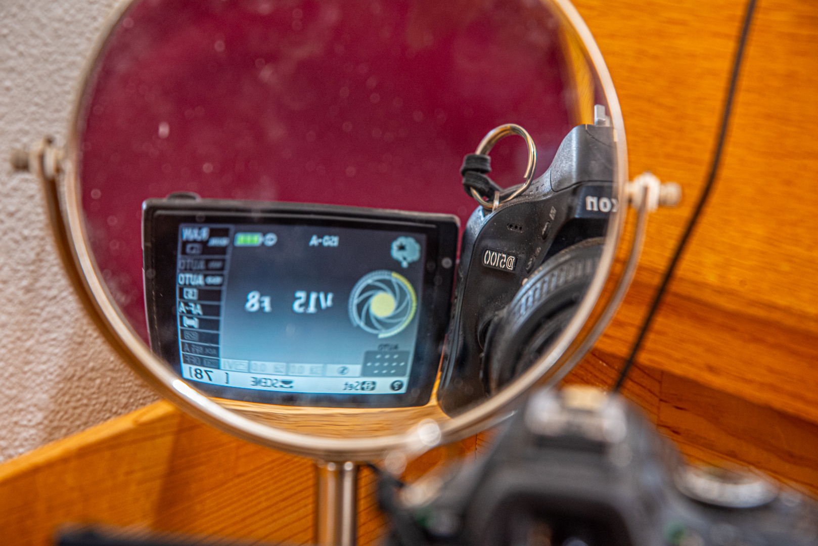

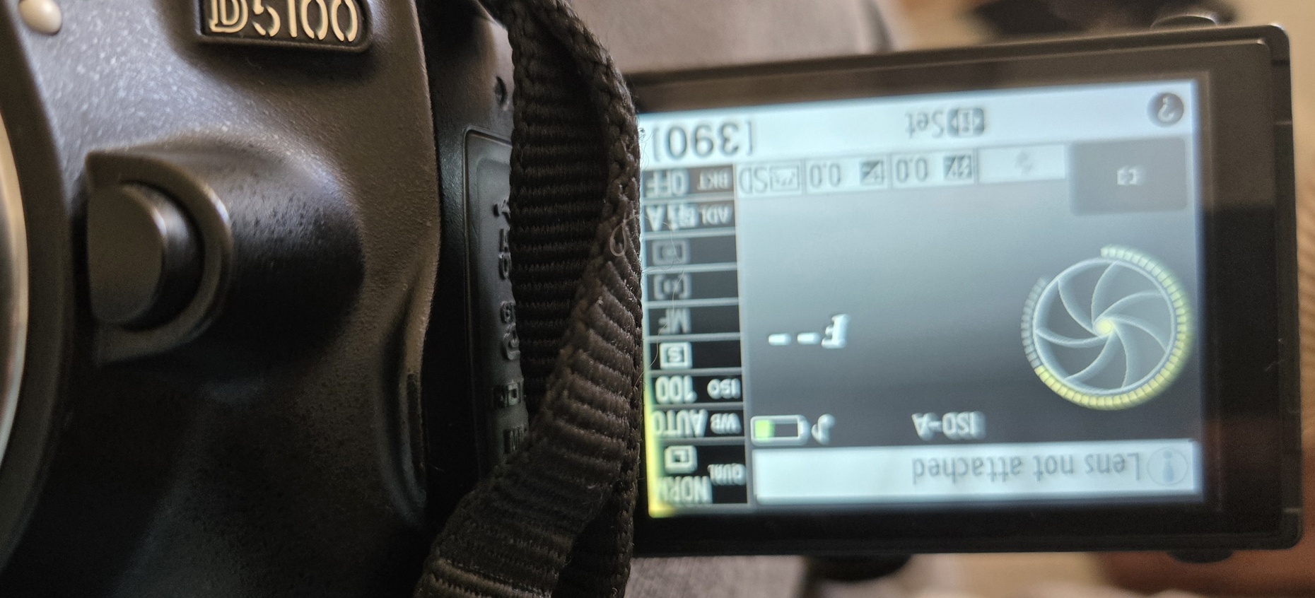

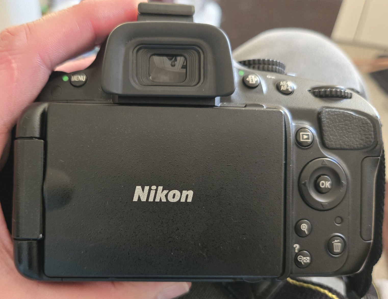

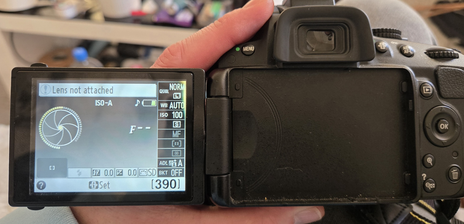

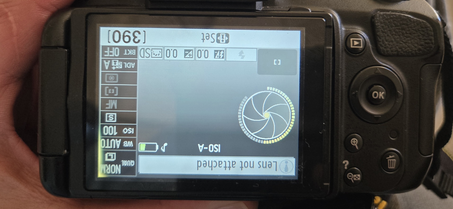

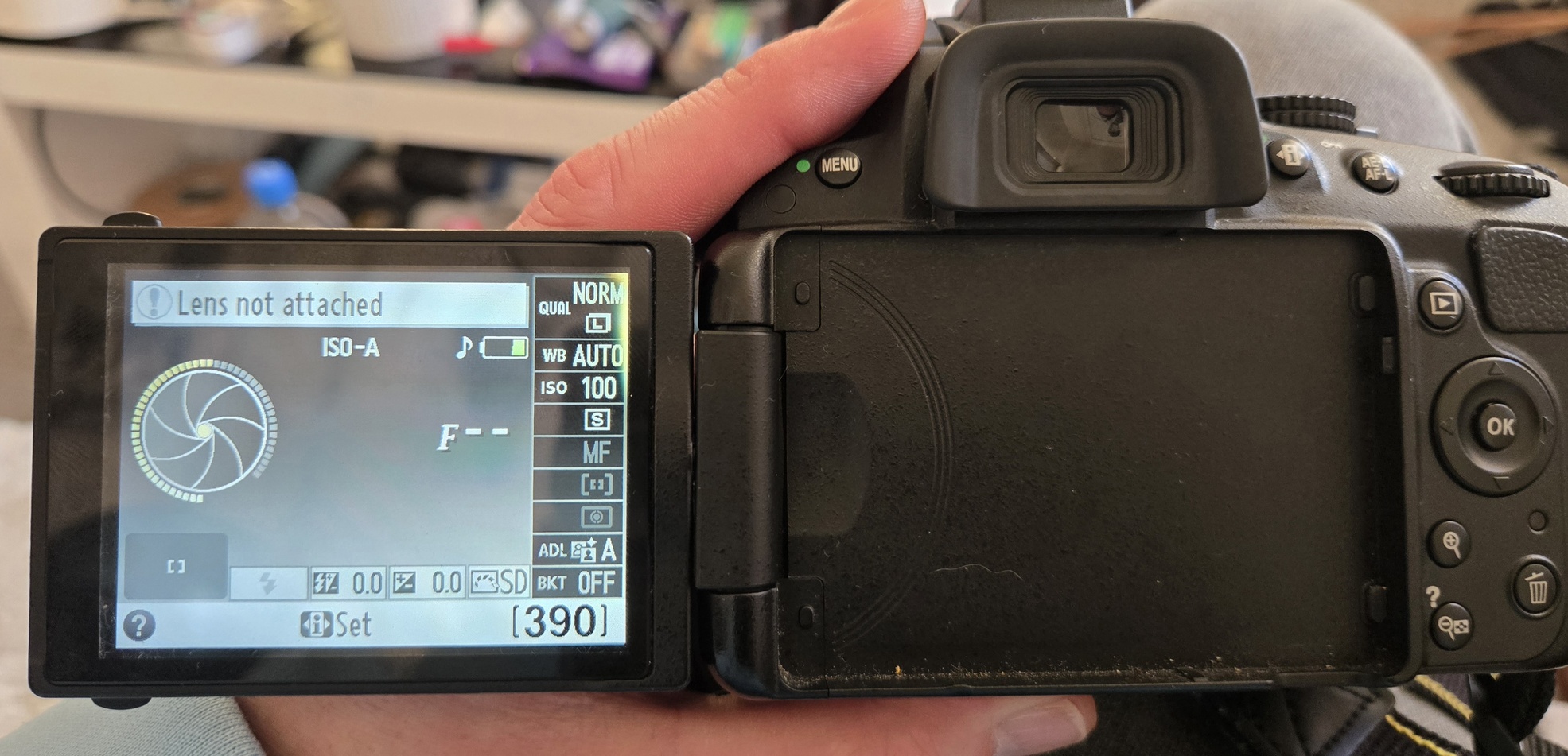

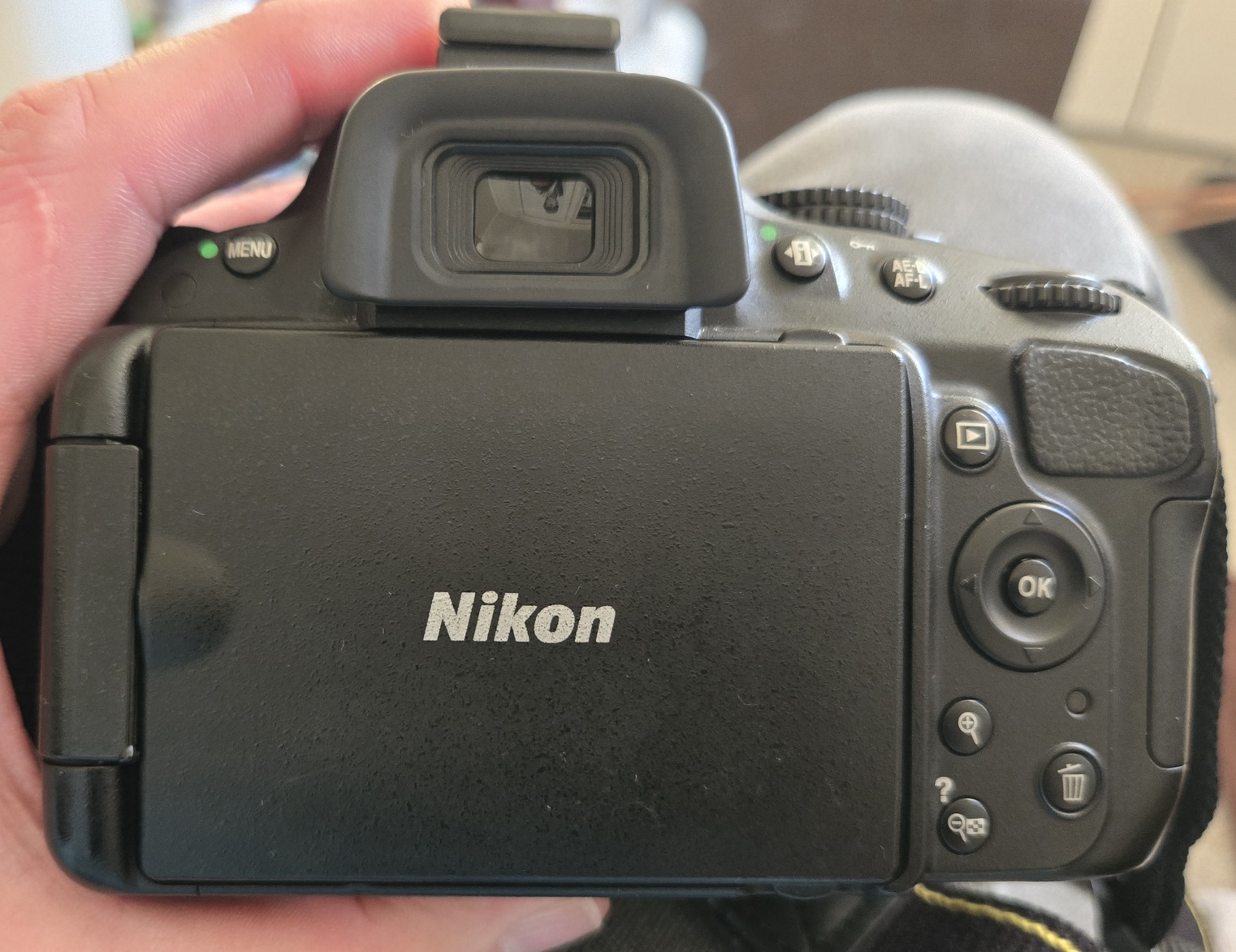

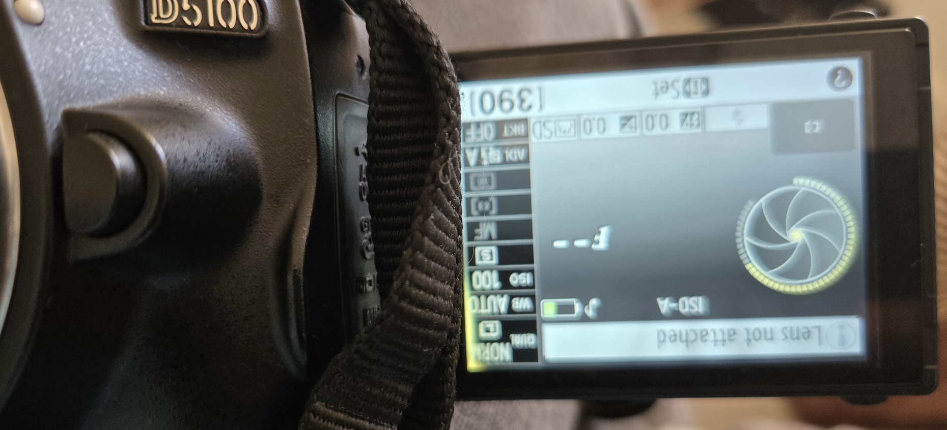

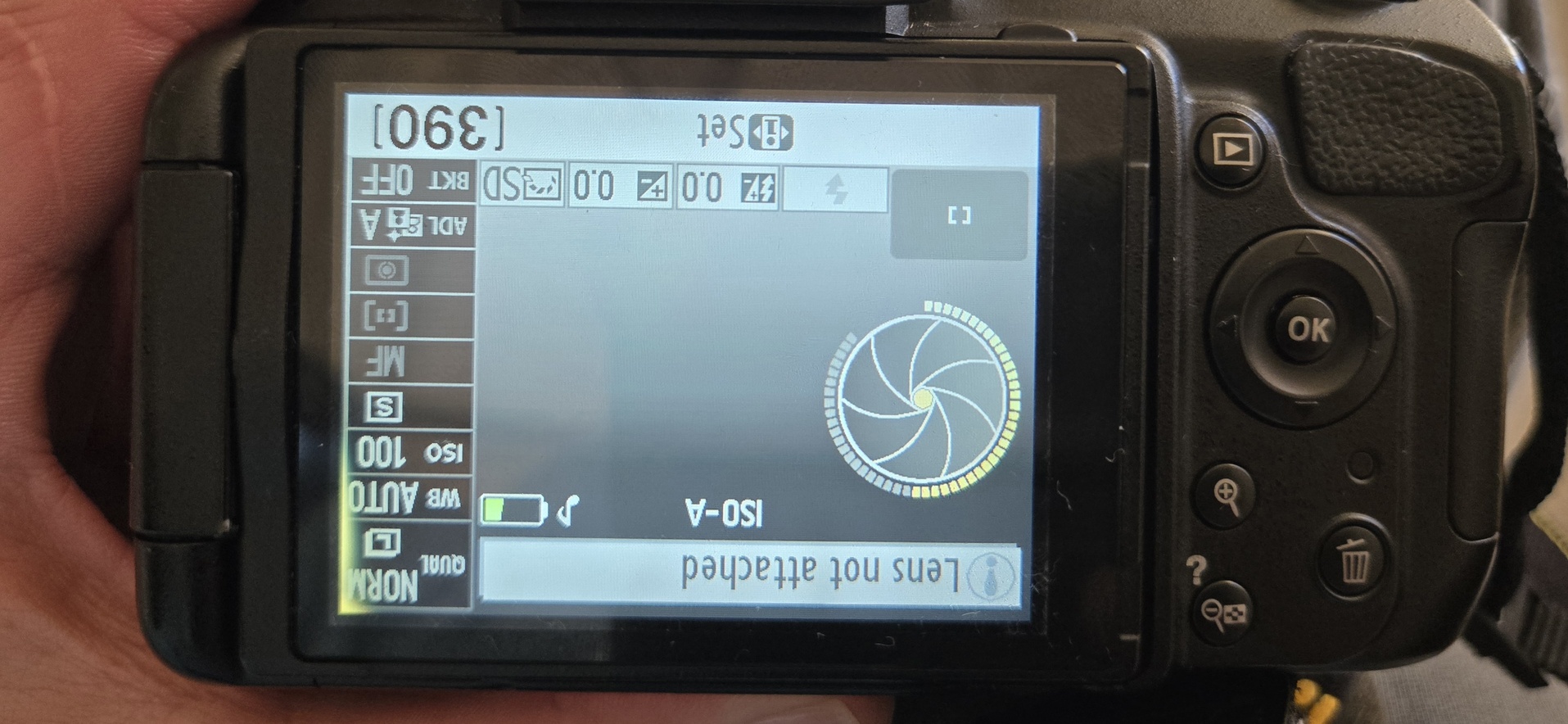

I'm a little bit baffled as to why my screen displays incorrectly (upside down) when the screen is folded flat to the camera if that makes sense. I fitted a new hinge to the camera so I know the part is a working part. And I have checked the finger mechanism and its there. It hasnt broken off.
Am I missing a trick here 🤔 iv taken a photo to try and explain what I mean. I'm truly baffled. I even thought that I could have installed the screen the hinge upside down but this isn't possible I've checked. I just dont know what's going on with it. Iv read that there are accelerometer sensors within the camera but they are working correctly when photos are taken.
