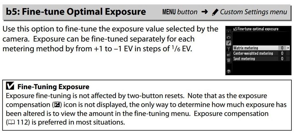

Okay...now to the nitty-gritty. ::what:: I don't know if this info will help or not, but I looked through the digital owner's manual for the D600. If you have the manual, please turn to page 226 where it discusses fine-tuning the metering. For your convenience, here is the PDF. If you are going by the PDF page numbering, you will want page 252 (which is page 226 of the owner's manual). I will also attach a print screen--I hope it will be large enough for you to read.
According to this info, there is a custom settings menu where you can override the default settings for matrix, center-weighted, and spot metering. You might want to check and see if the matrix metering setting has been changed. If not, you might want to consider changing it to accommodate for the underexposure problem. Supposedly the 2 button reset will not affect whatever is programmed in there (so says the manual). To quickly access that part of the custom menu, it is b5.

You post provided what I was looking for, a way to fine tune the (3) shooting modes. All (3) were set at zero. This means the camera out of the factory was set at -2/3s of a stop under, which was causing the underexposures. I reset all (3) to +4/6ths, and will wait until daylight to test the changes. Further reading also disclosed, that if I make a change to EC for lighting conditions, and then use the bracketing, the camera will take into account the EC change, and provide correct bracketing exposures. Thank you very much for your help.
