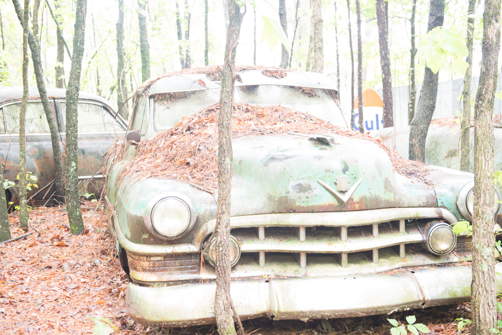

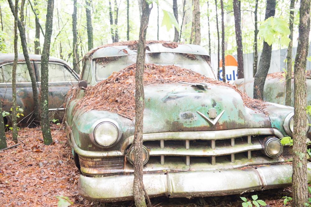

Post a few unedited samples.
Starting at 1/10 @f4 ISO 100 down to 6.0 sec @ f4 ISO 100 using the menu set bracketing, this was before I decided to change my ISO to 400
2014_05_10_OldCarCity-1.jpg2014_05_10_OldCarCity-2.jpg2014_05_10_OldCarCity-3.jpg2014_05_10_OldCarCity-4.jpg2014_05_10_OldCarCity-5.jpg2014_05_10_OldCarCity-6.jpg2014_05_10_OldCarCity-7.jpg
480sparky
So if you're shooting in manual, and this happens when you do a 7-frame bracket.......... what happens when you shoot just one frame at a 'correct' exposure? Does it come out properly exposed or is it 3 stops over?
T-Man
That is indeed weird, Kinte! I just checked my D800 and I have the same menu options selected as you, and the "under>MTR>over" bracketing sequence is working as it's supposed to for me. If you're in Aperture priority, your EV nominal value is set to "0", you're using matrix metering, and you have "under>MTR>over" selected in menu option e7, I can't think of anything that would cause the 3 stop shift you're seeing unless either your camera has faulty metering or you have a firmware bug. Are you certain you have the latest firmware update loaded? 480 brings up a good point in his post above... if you take a single shot at "0" EV, is it way over-exposed for what it should be at the ISO you're using? If so, then your camera isn't metering properly. If you're having these problems only when bracketing, then it sounds like a software issue to me. Either way, if you don't find a logical cause, then it needs to go back to Nikon.
