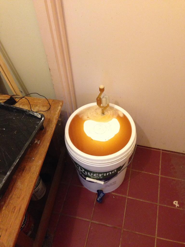

Making mead is stupidly simple. What you see below are a couple of the 1 gallon test batches I'm working with to fine tune the processes and get a baseline for yeast types and such. But basically, just dilute the honey (in this case 5# honey with 1 quart water), heat to 160F and hold to kill off any wild yeast, then add 3 quarts cold water, pitch the yeast and wait 4-5 months.

Process-wise making mead is really no different than making beer from extract. The main thing, in my opinion anyway, is sanitation. While good sanitation is crucially important when making beer, sanitation importance is about off the scale when making mead because honey takes so damn long to ferment. In short, your gear has got to really be clean because any undesirable yeasts in your carboy are going to have lots and lots of time to do their undesirable thing and you don't want that. I love me a good mead but damn they take a long time to make and mature. My best mead recipe required one... full... year... from (yeast) pitch to (drinking) glass. If memory serves that was about nine months in the carboy and another three months (give or take) in the bottle. There are faster meads, much faster, to be sure; but the best ones I've had take lots of time and lots of patience.

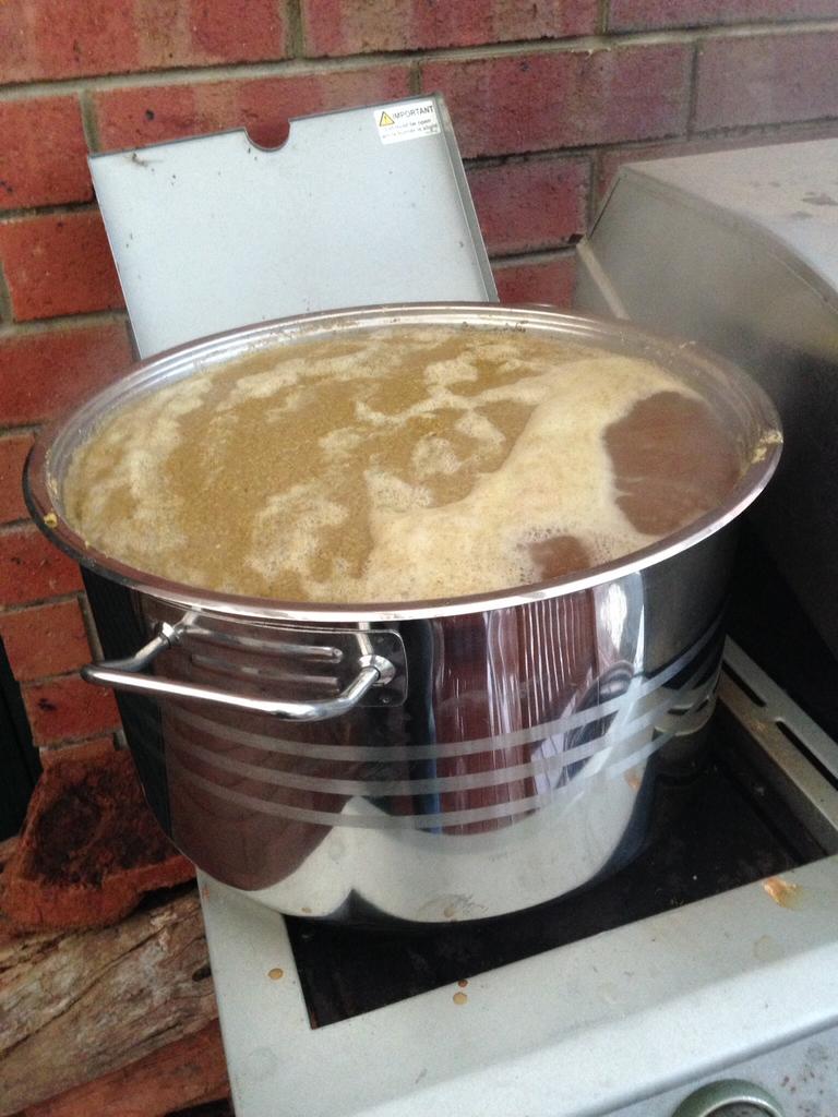

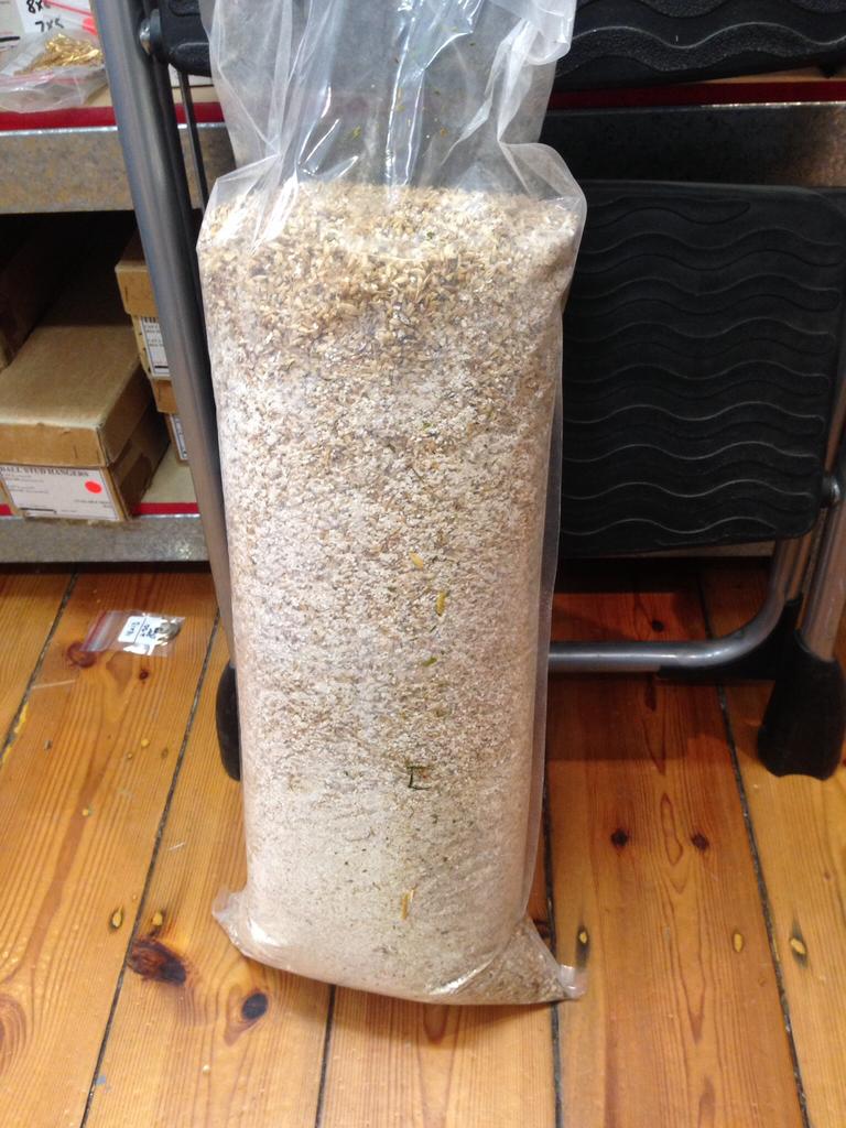

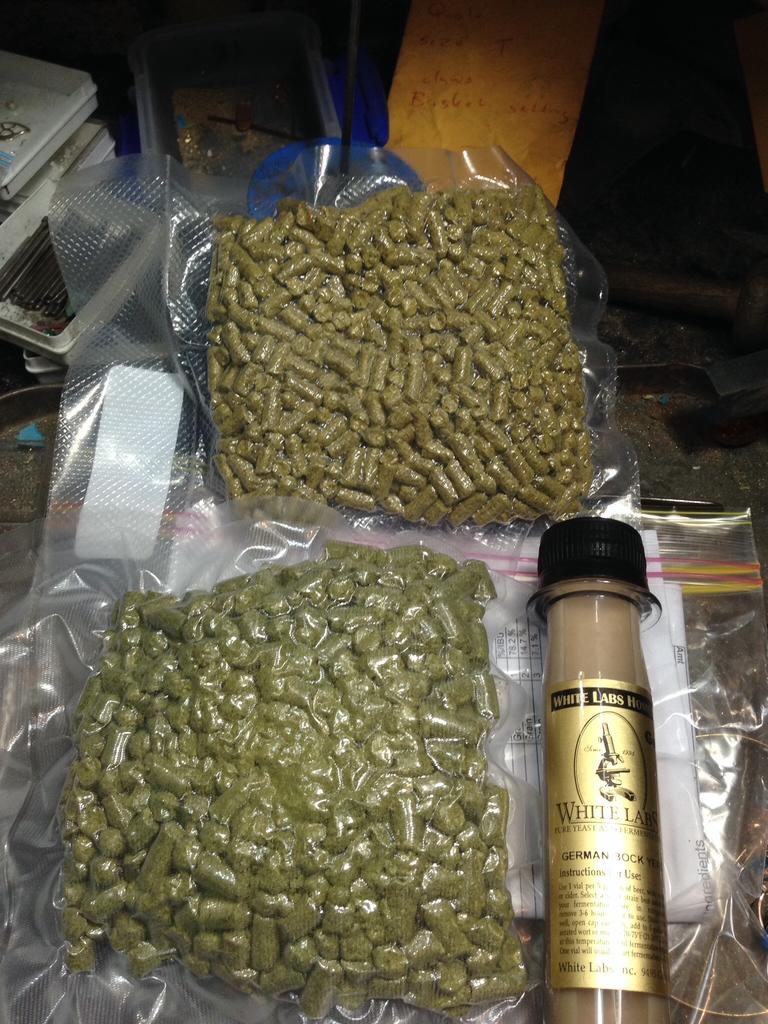

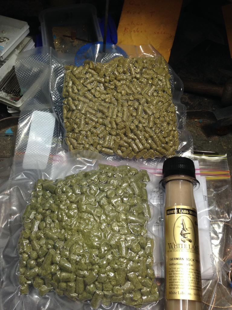

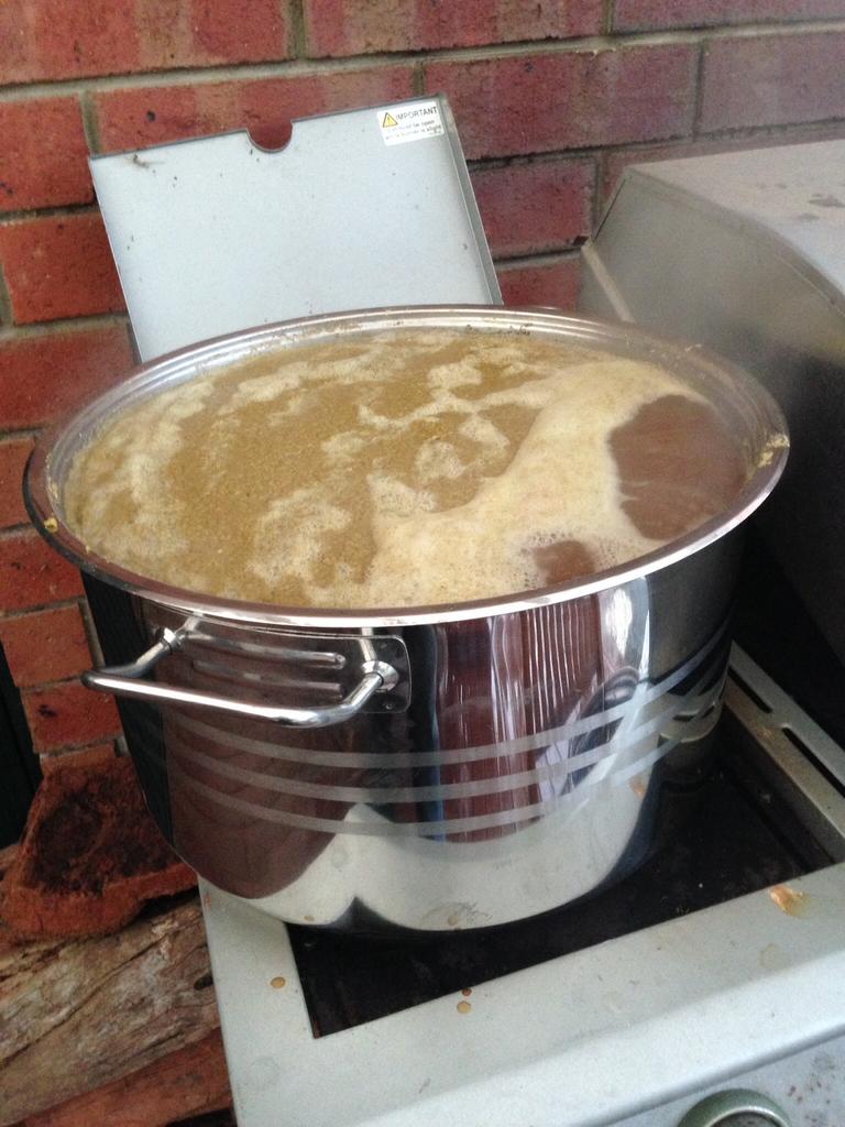

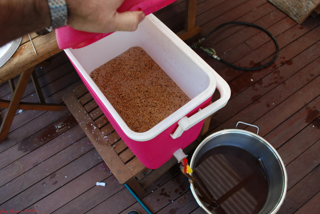

Ok tomorrow is Brew Day ! Plans have changed a little so brew one is a golden ale (APA style ) seconded brew is a German Lager !
Photos to come ....
Ijustwant1
Well I am a dunderhead :-( I left my camera at work ::what:: But all was not lost as my son-in-law had his D80 so I got a few shots but then forgot to transfer them to my computer and am now waiting for them to email them to me! Well it was a long brew day but I enjoyed it :cool: So the photos are still coming !!!
Ijustwant1

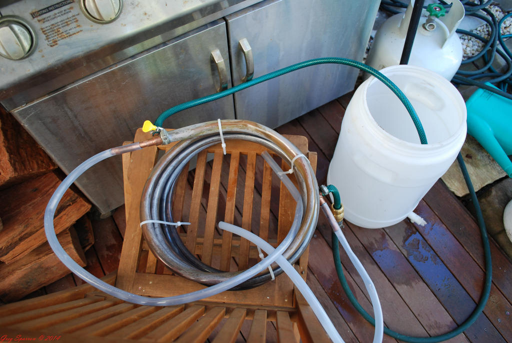

then cool the wort down from boiling to about 15-20c with my counter flow chiller , the hot wort goes in the top through the centre copper pipe the cold water flows from the bottom over the copper pipe and out the top and the wot comes out cool!
