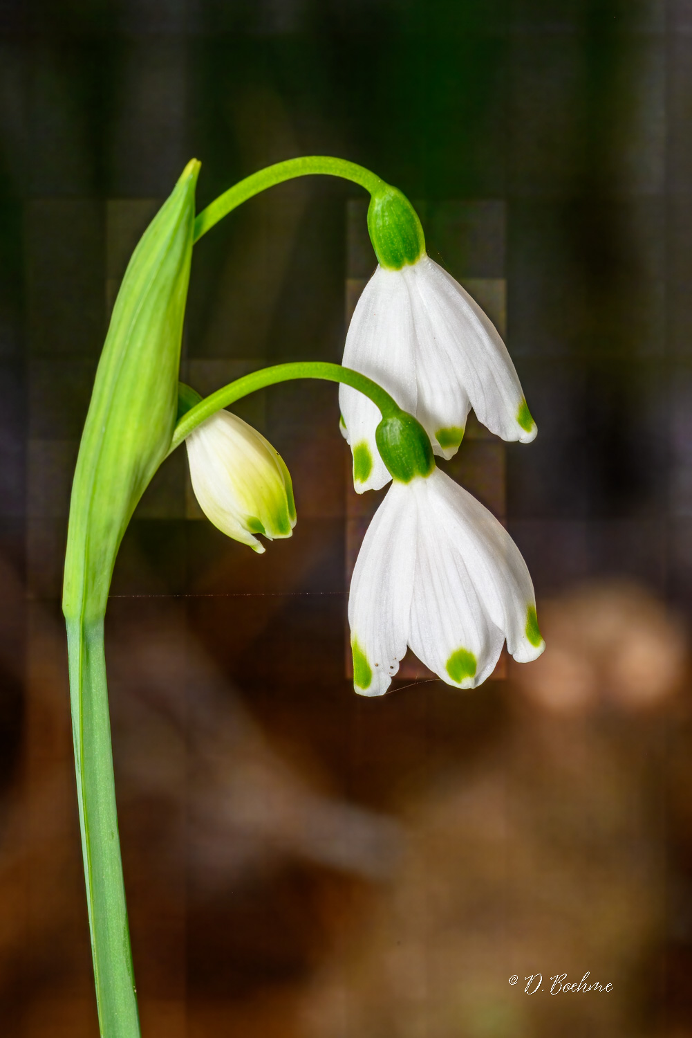

Since I started using Topaz AI, as opposed to using the separate programs, I've occasionally noticed these weird artifacts in the backgrounds. They are most notable in dark backgrounds that are then lightened in LR. The artifacts are visible in the output file from Topaz.
Here is a recent example.
I played around with a few variables, and found that this disappeared when I forced denoise off. I haven't loaded Denoise stand alone on my new computer, perhaps I should and see if it does the same thing.

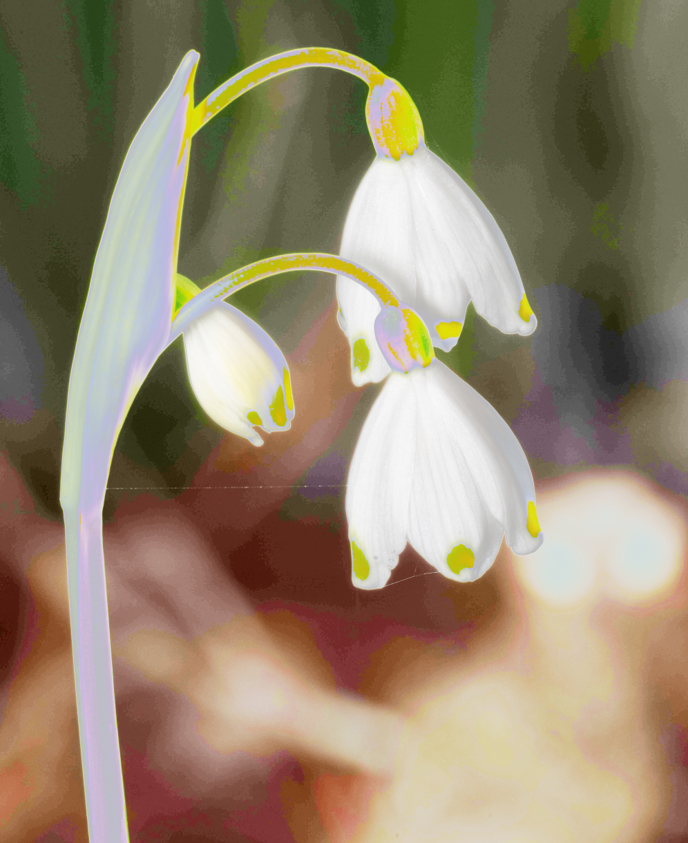

I received your original jpg. It looks like no artifact at all after Topaz DN AI. I ran your original large-size file and found no issue, but couldn't screenshot the whole image. I downsized in Photo AI (0.2x) and ran DN, no issue (pic1). I scaled large-size in Gimp and ran DN AI to see no artifact (pic2), then I ran sharpening in Photo AI it got better, and no artifact still (pic 3).

No, that's just trying to bring up severely underexposed shadows. If you look at the image in my original post at the top of the page, you will see a faint square pattern throughout the entire background, and a very noticeable set of square around the flowers.
FYI, I am not trying to fix a mediocre image here. This is just something I noticed when working with a photo that I wanted to see if it had any potential. Again, I have noticed this same issue to varying degrees in other images processed through Photo AI and decided it was time to address the situation. It is most common in out of focus backgrounds, particularly dark ones. I get those kinds of backgrounds with some frequency when shooting macro with flash, as I was in this one.
