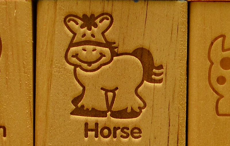

Ok, so I just now had some time to take some test shots with my d7000 fresh from Nikon Repair. The results...well...very obvious:
This is a shot with the 35mm 1.8 wide open with no Fine Tune (100% crop)

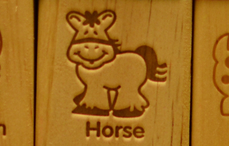

Same shot with -20 Fine Tune
Hmmm..I'm off to take a few test shots with the 18-105...

Oh no!! That's not at all what you want to see after it comes back from repair! Did you notice an issue with your 18-105mm? I have heard that the 35mm 1.8 is finicky with this camera and requires fine tuning, but -20 is a LOT as far as I'm concerned.

I took a couple of test shots with the 18-105mm and it seems to be pretty close to perfect.:) If I zoom in at 100%, I see I can get away with about -5 adjustment, but cannot tell the difference otherwise. Now, I only took shots at 58mm and had to increase iso a bit to get a better exposure (this lens needs lots of light!!).
Not sure if I should get back with Nikon about the 35mm as I can get very sharp pictures with proper adjustment.:confused:
Also, at the distance I was shooting at (and at that aperture), the dof was less that an inch. I'd think that this would be a challenge for any camera.
