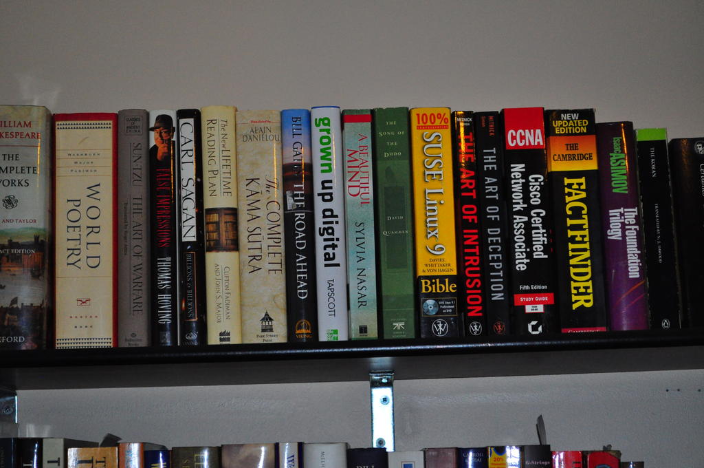

Hi, I'm having a problem with this camera indoors. The light is on in the room but the picture is coming out dark esp in S mode, P mode is not as dark but a bit orange/blurry. My minimum shutter speed is set to 1/200. With the flash on the pic is normal, is this a flaw with camera? Flash? Lighting?

If the top one is with flash on and the bottom one is flash off (both having the same settings) then that looks pretty normal. Inside with a single light at 1/200 f5.6 and ISO1600 it's going to come out underexposed. I just tried with your settings no flash and just about got the same thing.
Which camera is it? At first I thought your exposure compensation might have been set to under expose but that looks to be off.

For what it's worth, this was my pic at those settings. Not as dark but that could be because of my lighting vs. yours.

It's a D5000, I was using the 18-55 @ 55mm, taken at the same spot etc, thanks. Would increasing the iso help? Then I might have noise issues. Thanks
yeah, the top one is with flash. On board flash

you dont have enough ambient light. 1600iso is not enough. 5.6 is too closed and 1/200 is not enough time to let in enough light. add all three and you dont have enough to catch ambient exposure.

youd have to bump at least to iso 8000 to see reasonable light. and even then not enough because the aperture is too closed and shutter too fast.
tripod?

I just went outside, and tried 3 modes and all the pics came out fine/normal P, S, A so I think it boils down to a lighting issue. And I didn't change any settings. Sorry I deleted them

If ur shooting still life then a tripod is fine and expose to lower numbers with the shutter. but if youre shooting people. minimum id go is 1/125, better is 1/160. aperture is too close but thats youre limit with that lens. flash bounced up with card out with a lowish ceiling works well.
