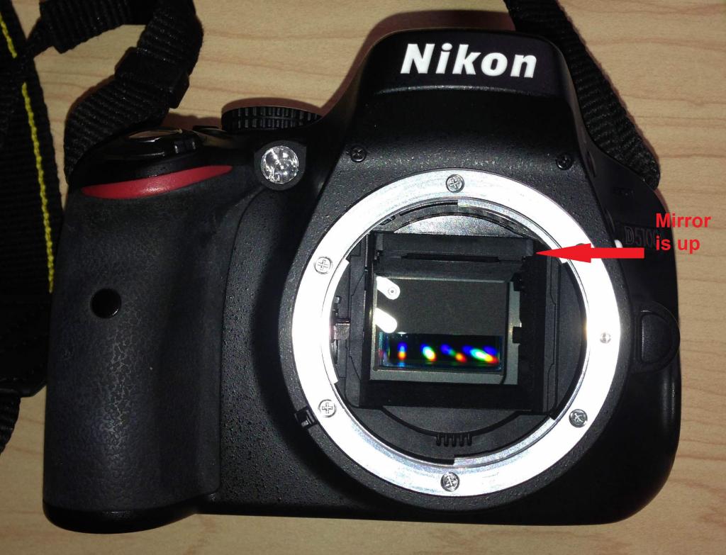

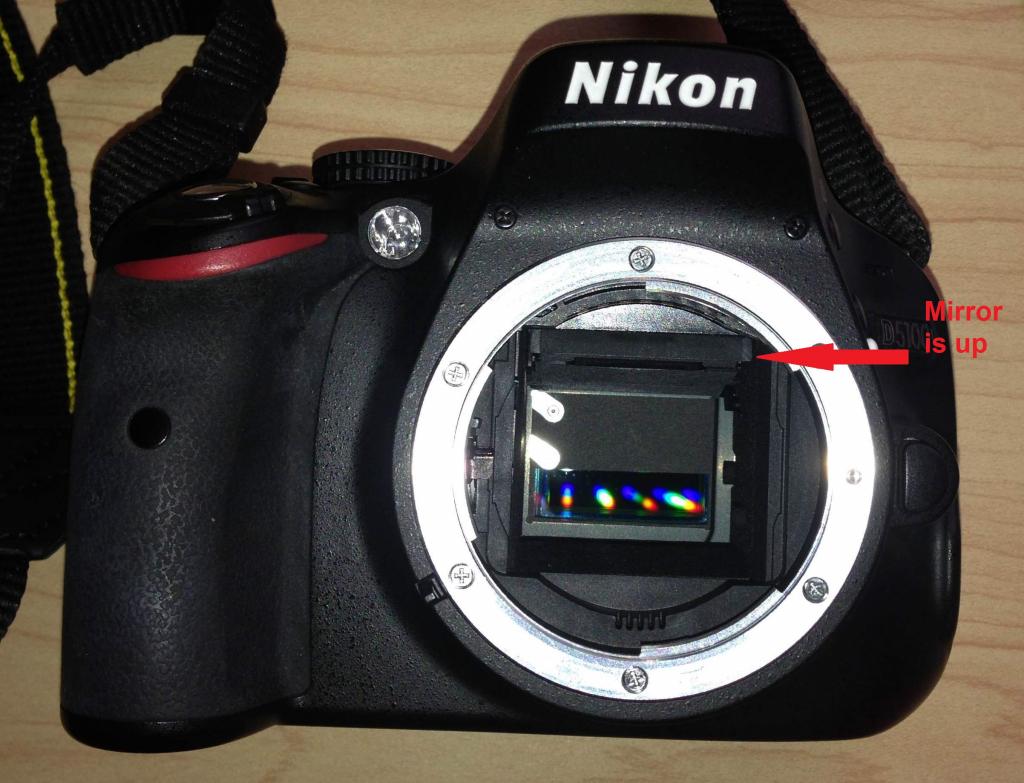

Hi Rico and everyone, I was so thrilled to find this thread. However, after looking at my camera's mirror, my situation is a little different. My mirror is stuck in the upwards position. I can push the mirror down (or open) but then snaps up again (or closes). I am getting the same error message. Do you guys have any clues as to how to fix this problem?
Here's the current state of my camera taken with a flash. The arrow points to the mirror.
