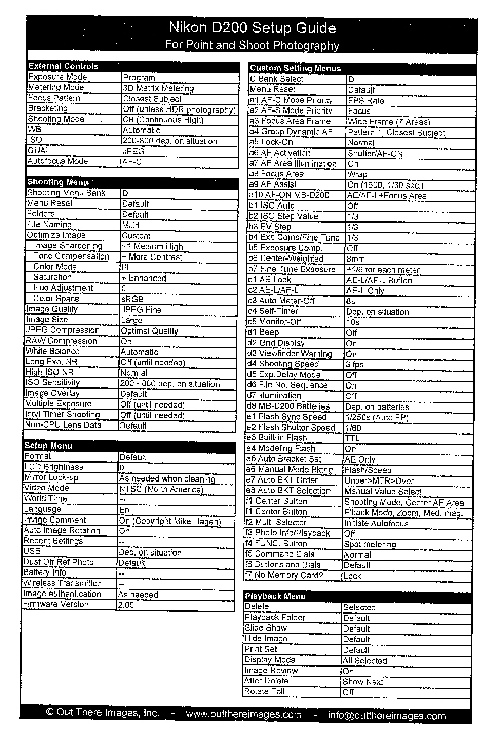

By the way, while I'm at it here, I have a number of camera setup pdf's if anyone is interested, for many Nikon models. Unfortunately, I can only send them to whoever wants one via email, as it's not possible to send them through the forum.....yet. :) Here's one for the D200 for instance
