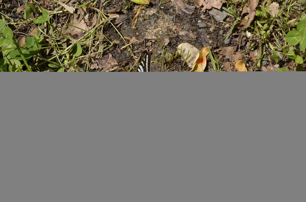

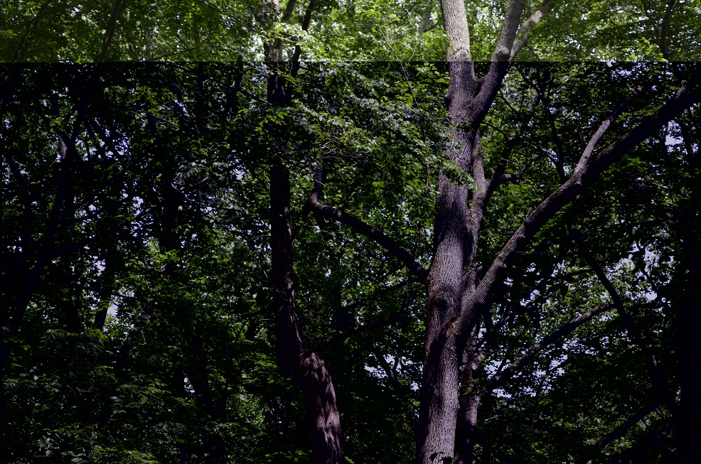

After checking out my pictures, i keep having trouble with either color not going through a photo entirely or blacking out half of the photo. error1.jpgerror2.jpg both examples of what happens. As far as I know I'm on either auto mode or landscape. Any idea on why it is doing this?

Are all your pictures coming out this way and is this a new problem?
mose
Its a brand new camera. Maybe 15/180 photos are like that. They don't display that way on the camera, just on the computer. The camera is a d5100, 18-55mm kit lens, 1.01 firmware. Happened in Macro, Landscape, Auto, and Action modes. I wondered if it was related to the hdr, but its not available in those modes.
Possibly a problem with the transfer not completing then. Try plugging the card directly into the computer and using Explorer to transfer the pictures.
Do you find the problem photos near the end of the end of the transfer?
mose
No, I used Nikon Transfer from the card reader on my computer, and its distributed between photos all throughout. Maybe it was the transfer though. hmm..
mose
PNY 16gb performance sdhc class 6. What drives me nuts is that on the camera the pictures look spot on. same exact information as pictures around it. but the moment i view it on my computer, select pictures turn out weird. Just checked my laptop, and the pictures view perfectly on it. So I've figured out its my desktop, now how to fix it...

So, I have figured out the issue kind of. It seems that its a random sampling of photos being transferred. I'm not sure if the Nikon Transfer utility is lagging, but the computer and card are having a hard time keeping up with each other when transferring the 16 mp photos. Has anybody else experienced anything like this?
