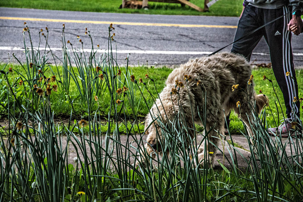

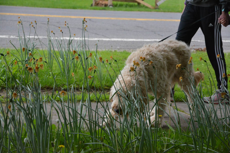

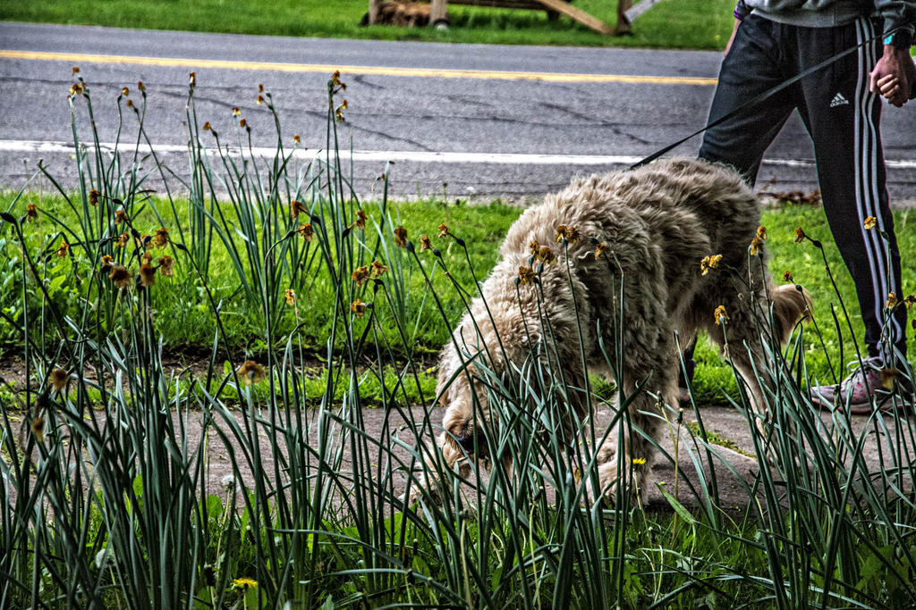

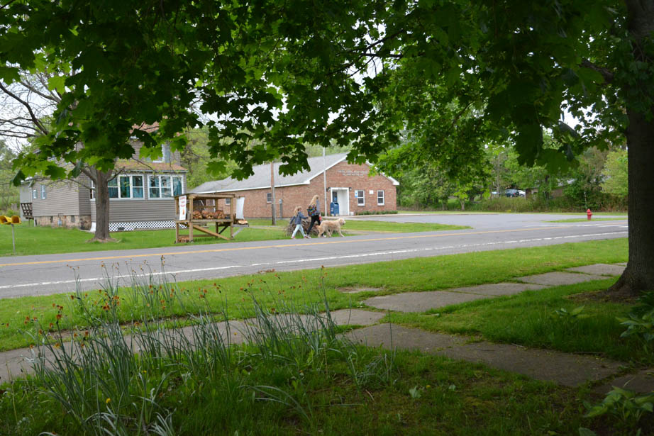

These images are fine, but a bit over contrasty, probably set to Vivid picture control and then when sharpened in post processing they can develop unwanted sharpening artifacts on edges of colors or between light and dark transitions. If you are going to post process it would be better to start with a neutral or Standard Picture Control setting, which will allow more adjustment range before developing unwanted artifacts.

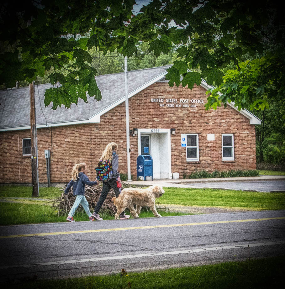

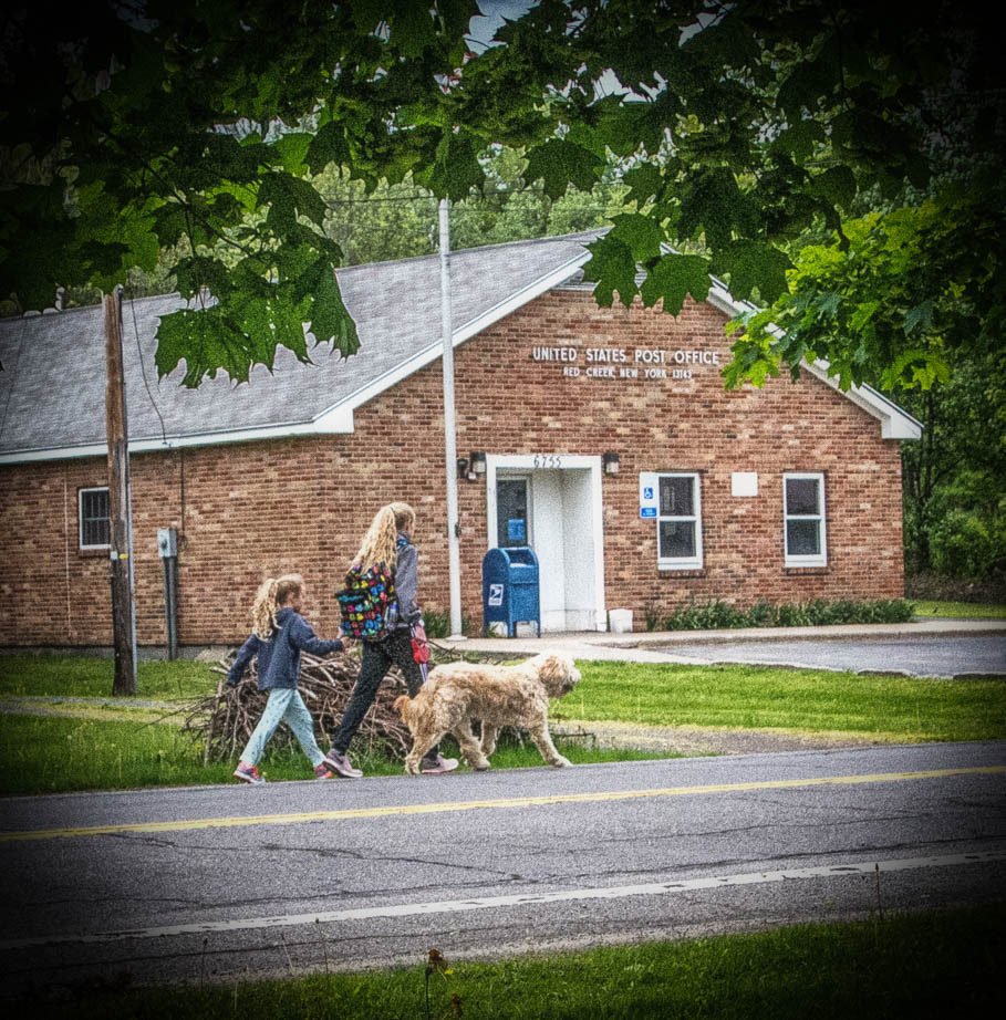

The image loses some detail perception being underexposed. It is about 1/2 stop under exposed if you look at the histogram in your editing software or the original file in the camera. The Green channel is dominate and that is easy to over saturate so it is often good to slightly underexpose a green dominate image so you can selectively increase brightness in post process. The problem with under exposure is that noise quickly becomes a problem in the image and colors are not accurate. Look at the brightest part of the image, the white signs. They are not white but grey due to under exposure.

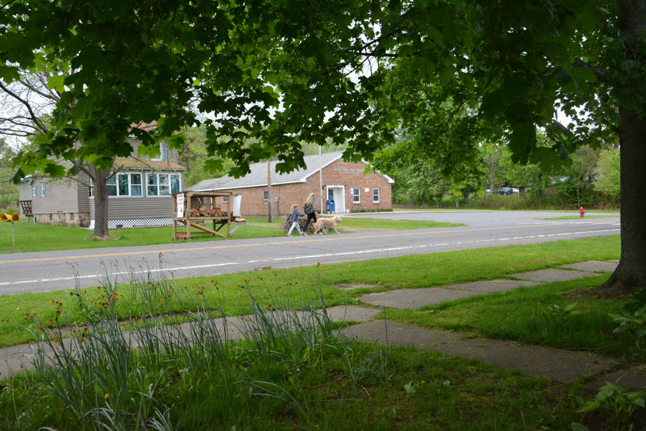

As mentioned before, detail is lost when the subject is defined by fewer pixels, and the girl and dog are a tiny portion of the total so few pixels have to define all you see of them, no more than 12 square pixels define her head and hair for example. If you were to use a pencil to draw an object and could only use 12 dots to draw it, you would not expect to see very much detail or convey much information. But the eye does a pretty good job of painting an impression in our brains that it is a girl, and has long blonde curly hair. Objects closer have thousands of pixels with which to capture and display a great deal of detail.
Cropping should be limited to adjusting the aspect ratio of the image, but not for zooming in unless you don't mind losing a lot of detail and sharpness. That is why most of us have a camera bag full of lenses that are most appropriate for the subject and distance to get the maximum number of detail defining pixels across the subject. If you used a 300mm lens, she would have appeared sharp and filling about 1/3 rd - 1/2 of the frame. Even a lower quality telephoto lens would allow more detail and resolution than cropping a shorter focal length lens image.
There is another factor, and that is viewer perception. A person sees a distant object and missing data is filled in so we think we see a lot of detail that only appears not to have detail when the image is blown up. It is perfectly natural to have a lot less detail perceived with distant objects so it is usually a better representation of a distant object to be displayed small, in its normal context. It looks more natural.
