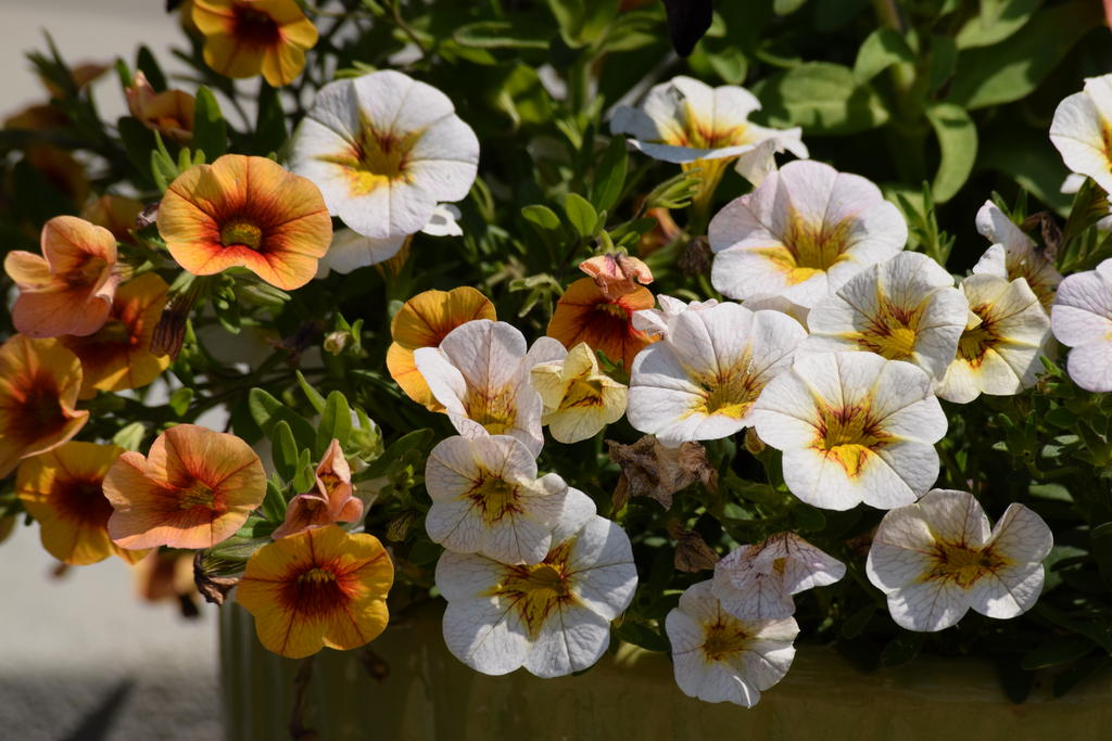

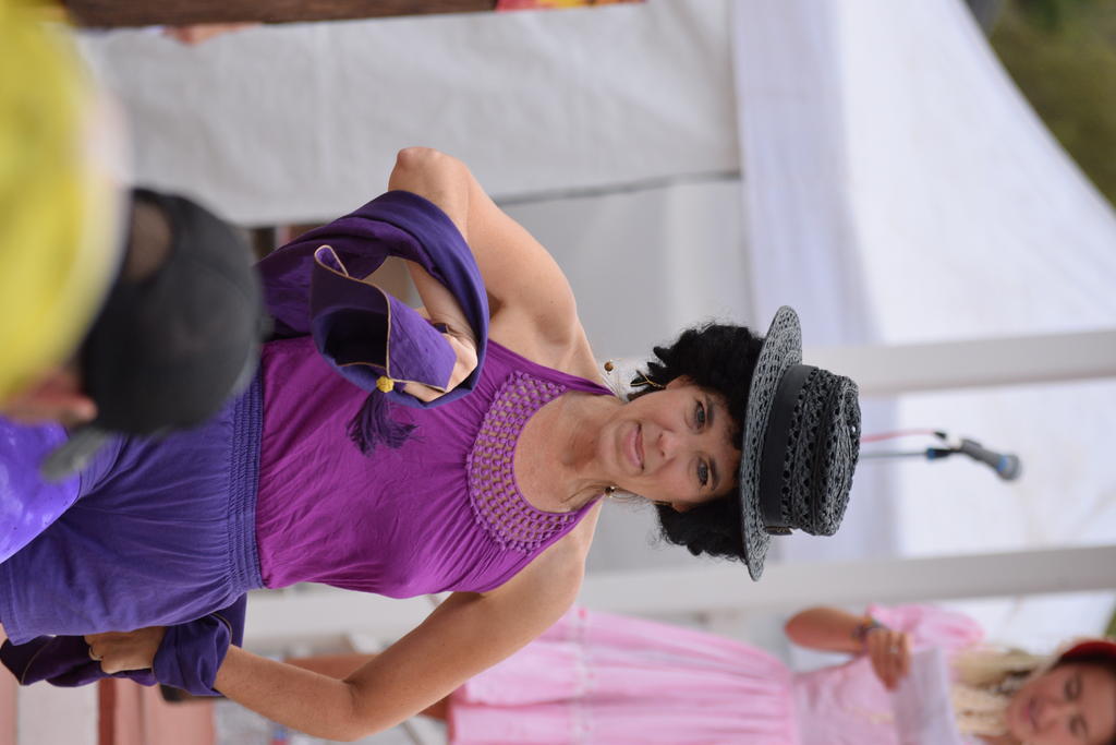

So far, almost every shot I take looks fine when viewing the image on my computer at about 50% or so of the resolution, but when I pump it up to 100%, they're muddy, not sharp! I can't figure out why. This is really bumming me out and I'm wondering if something might be wrong with the camera. Any thoughts about that - or what could be the cause? Here's two example of images with focus that looks okay, but when you make it 100% - it's actual size -not super sharp. Neither are great photos - just examples of what I'm talking about.Other kind of silly question - I was experimenting with using back button focusing and can't figure out how to turn it off and return to depressing shutter button half-way for focus. Can anyone tell me?All help appreciated. Thanks!

Not sure about the pictures. they look sharp. The forum resizes so there is not much there to zoom into and we can't see settings. They look sharp with shallow depth of field. They don't look muddy, but I don't have the original to zoom in.
Somebody will ask for your exif data, so you might as well post them. If you resize the pics before posting to 1000px on the longest side, the forum won't mess with it and then we can usually see the exif data that way.

Hey Nickt! Thanks for the backbutton focus resolve! Yes - at this resolution - the images look fine - it's at original size that the issue I'm talking about shows up. I should have figured they'd need to be resized for posts... Thanks again for response!

That first picture looks sharpest on the woman's hand and the fabric she's holding. The front of her hat is also in sharper focus than her face. I think that's where your focus was. A smaller aperture (higher f-stop) would give you a greater depth of field. Most lenses tend to be sharpest from 5.6 to 9.
