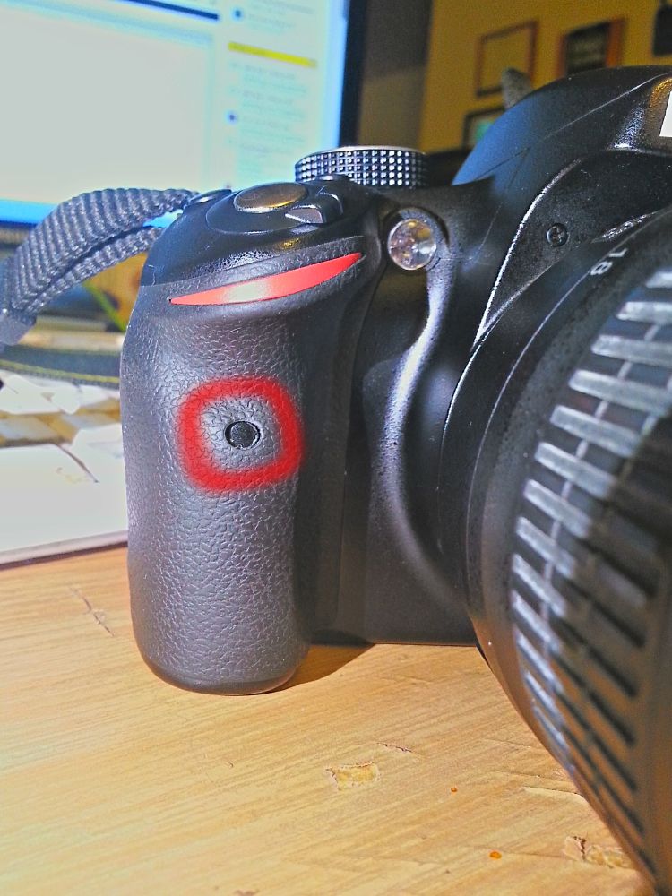

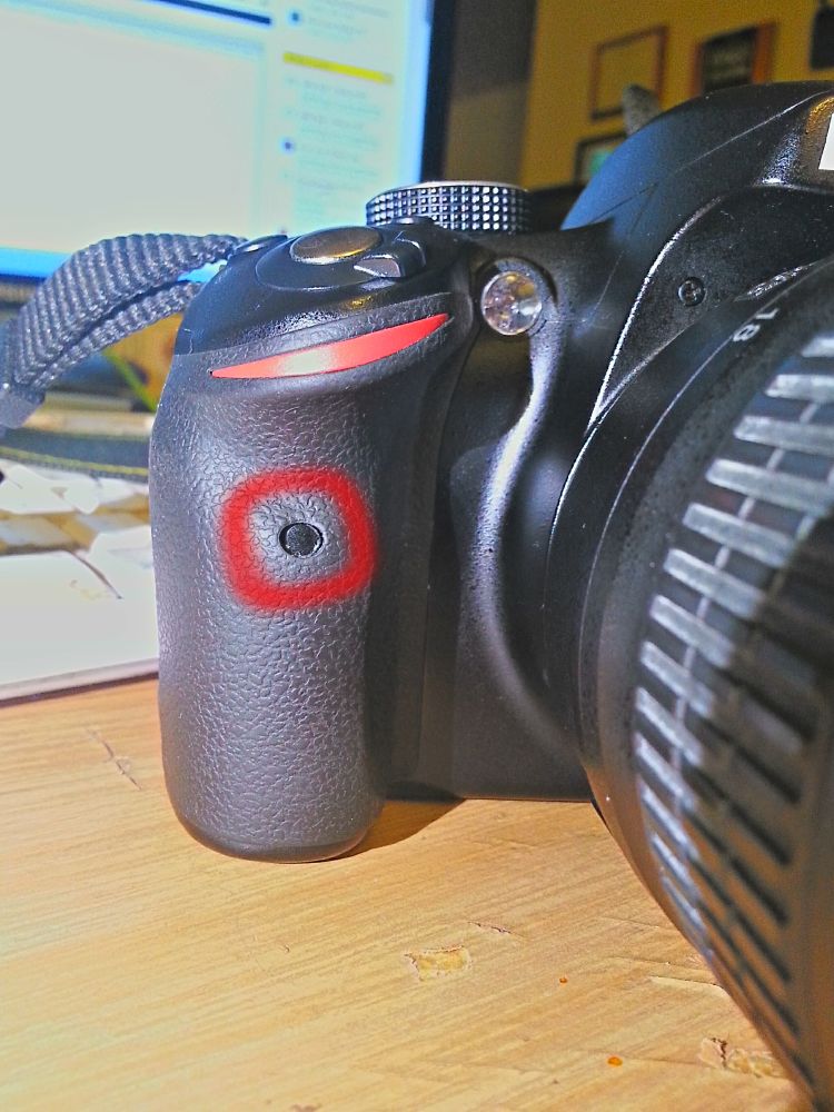

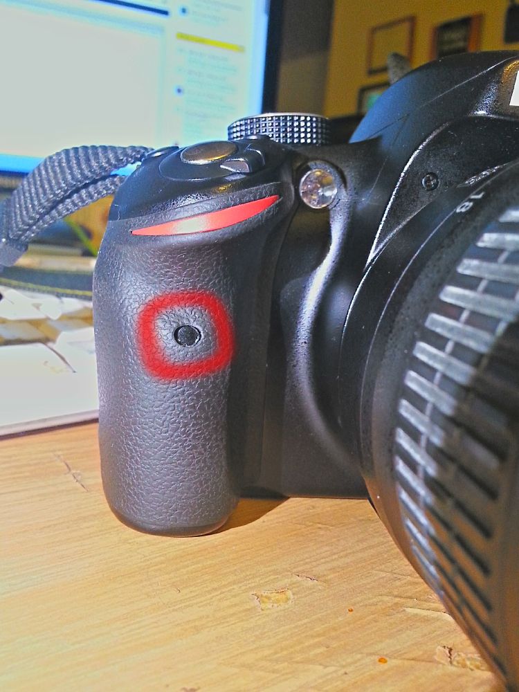

as Paul has said you need to enable it, and remember the IR receiver is on the front (On the handgrip) of the D series bodies so you need to have this in front pointing back to the camera for it to work :)

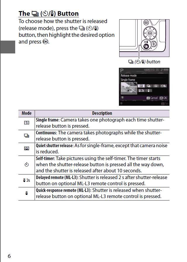

My bad, the D3300 is an odd beast... The shutter release modes, including the wireless remote option, are handled by a button on the back of the camera body:

Got it- thanks guys! Paul, where in the heck did you find that info? I googled a few times and checked my manual and 300 page camera instruction about just the 3300- to no avail. Do you have supernatural powers! Again THANK YOU for solving my puzzle.
One thing I noticed though, is that I need to set the Quick response remote setting each time I take a photo. Is that how it works? Paul

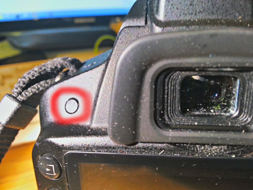

Bob Blaylock

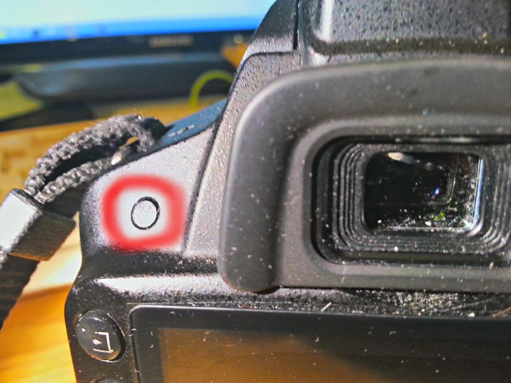

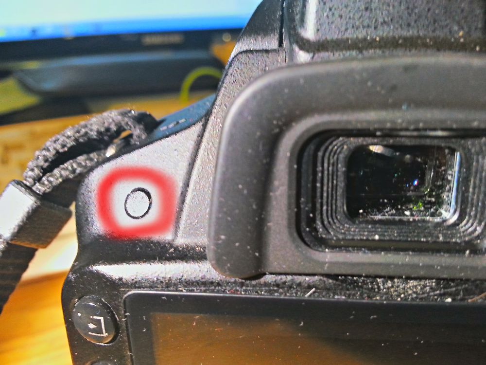

My D3200 has a sensor on the front, where you indicate, and another on the back, near the upper left corner. As a result, it can respond to an IR remote in front of it, or behind it. I doubt if the D3300 differs in this respect.
Daz
You are correct however I could never get my D3300 to fire from the back, not sure if it was just a dodgy IR, but the front worked fine, back a no go
