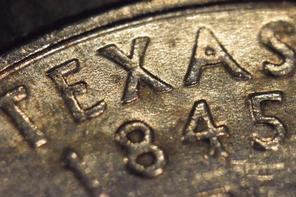

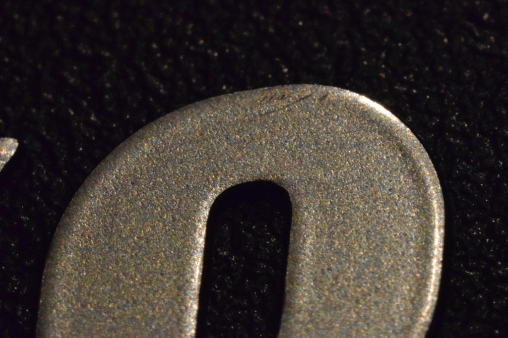

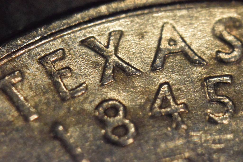

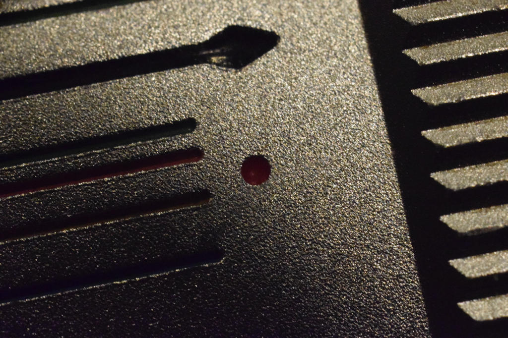

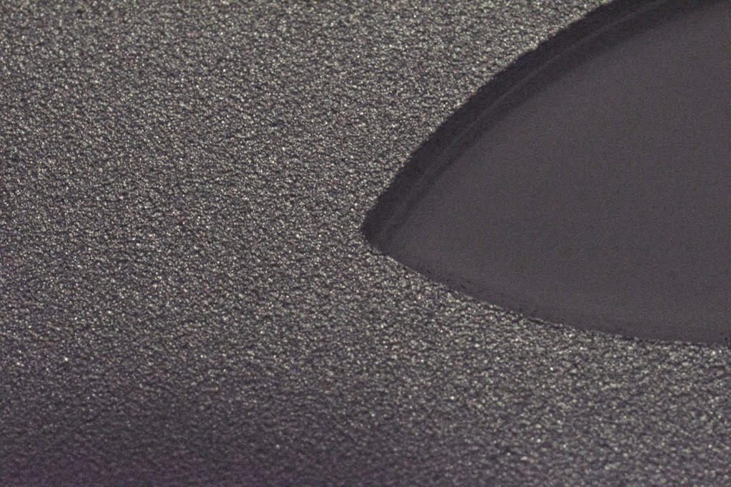

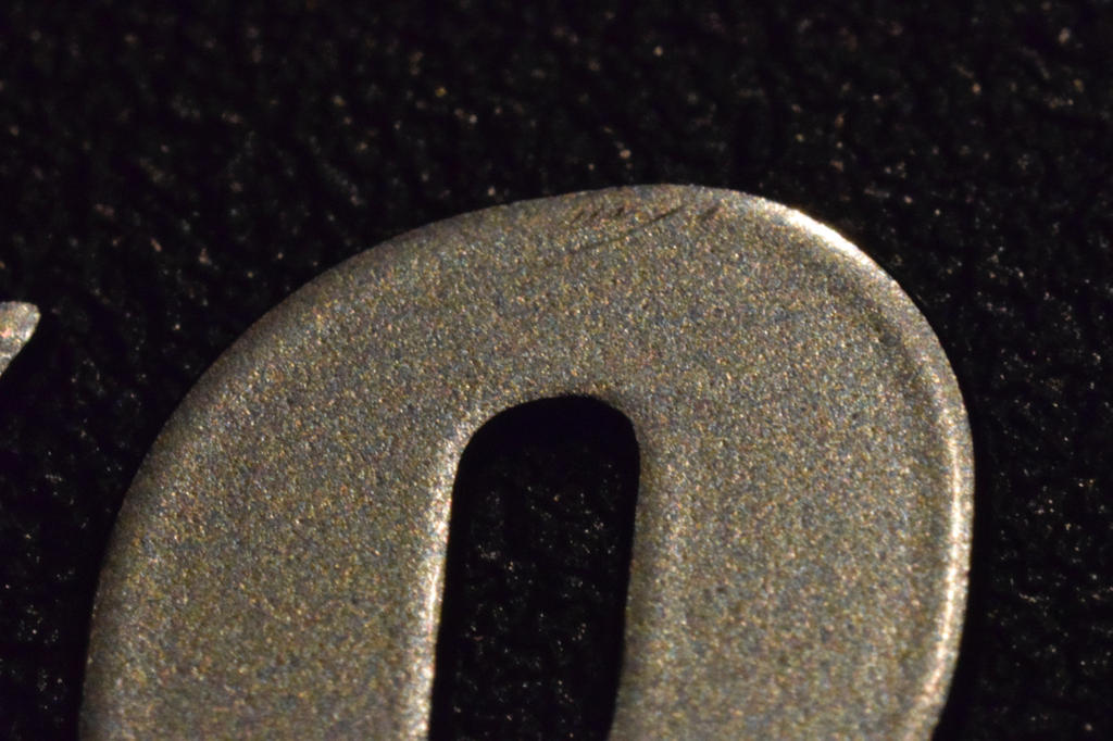

Made some amazing progress this evening with a little help from an article on coupling two lenses to get extreme closeups, viz. Coupled lenses in macro photography. So the big tip in this article is to mount a telephoto lens on the body, and a wide-angle lens in reverse on the telephoto using a coupling adapter. Well, I couldn't wait to get a coupling adapter to test the theory, so I used packing tape (pl. don't hate) to hold these old primes against each other. I tried the following combinations:
1. 28 f/3.5 reverse mounted on 200 f/4 (which in turn was mounted normally on D3300)
2. 50 f/1.8 E reverse mounted on 200 f/4
3. 28 f/3.5 reverse mounted on 105 f/2.5
To my surprise, I was actually able to get decent photos using these combos. The one thing I saw right off was darkening of the viewfinder image, suggesting a fair amount of light was being lost, possibly in part due to my makeshift coupling adapter. The other thing was I needed to be rather close to the subject in order to focus on it. This often cast a shadow on the subject, so I had to adjust the angle and use significant exposure compensation (+5EV) to get usable images. As regards focusing, rather than turn the focus wheel(s), I found it easier to move toward or away from the subject to bring it into focus. I read somewhere that it helps to have both coupled lenses focused at infinity, and that seemed to work. I also implemented the tip in the article to keep the telephoto wide open, and the reversed wide-angle stopped down to the min. In practice, stopping the wide-angle down to minimum aperture gave me dark images, so opened them back up some.
Image 1 is of the top of my Macbook, taken with lens Combo 2. Didn't realize anodized aluminum was so rough.
Image 2 is of my 200 f/4 taken with lens Combo 3.
Image 3 is of a quarter taken withe lens Combo 3.
Image 4 is of a Nikon lens cap taken with lens Combo 2.
