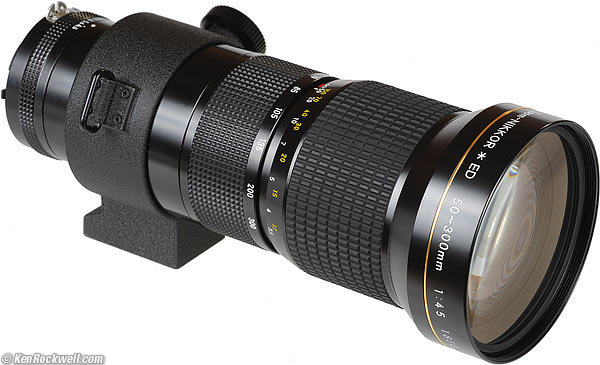

Is this what you have,picture credited to K Rockwell

Oh great catch Mike! I mistakenly thought it was a 55-300mm lens!

My lens is similar to yours in the picture, except the knurling on the zoom and focus rings is dissimilar. As the "No." (s/n) is not shown on your picture, it's difficult to know the lot to which it belongs. Major internal changes supposedly occurred at lens Nos. 740101 and 750101[SUP](1)[/SUP]for the 50-300, but I don't know any specifics.
