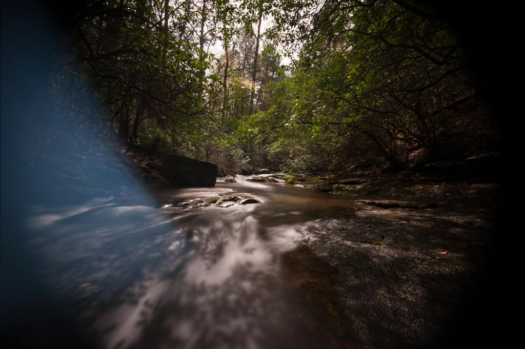

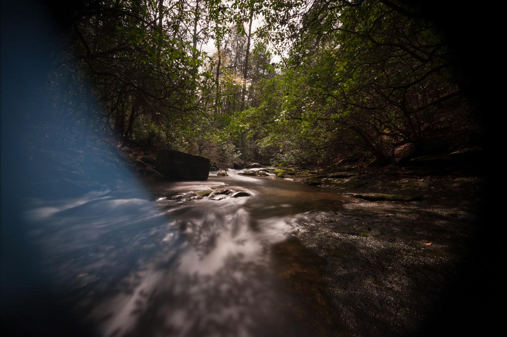

I recently went out and shot with a ND filter and got the results below (left corner) on many of my images. It's not lens flare. I'm wondering if it's the rear shutter curtain?
I included the full frame as evidence.
Any ideas?
Thanks!

Was this a variable ND filter or other? And you didn't stack the ND filter on top of a second filter?

I was thinking the same. Unless it's an applied effect, he also got some serious vignetting going on. I get that when I stack on a wide.
Light sneaking in through the viewfinder?
That was my thought as well, as flare coming through the ND wouldn't wash out quite that much, IMO. Were you in live-view? Was your back to the sun?
I have had the exact same thing happen when there was light behind me. Cover the viewfinder during long exposures. Nikon sends a little cover with new cameras just for this problem. That generally is the first thing we lose.

I think you are right Don. His D700 does have a built-in curtain for his view finder. Just need to use it.
