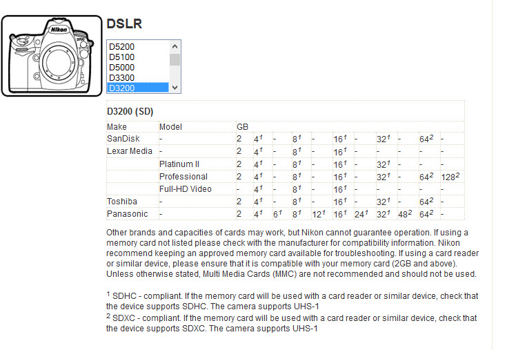

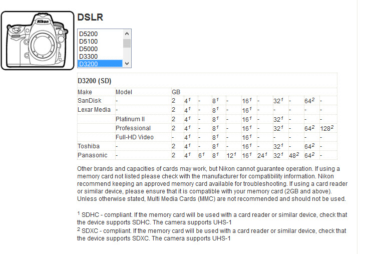

The second card I purchased is listed as supported for this Camera
https://support.nikonusa.com/app/answers/detail/a_id/18128/~/approved-memory-cards---d3200
2: When I got this new Lexar card I experienced the exact same issues, literally the exact same set of problems. The most frustrating part of all this was that I originally had a 32GB Samsung class 6 card that performed perfectly and still did. No issues whatsoever with the Samsung SDHC.
This led me to start comparing SDHC vs SDXC and this is where i found out what the problem is. The SDXC use exFAT and the SDHC don't. The SDHC works perfectly and the SDXC is nothing but problems so I decided to test a theory.
3: I downloaded this tool Verbatim FAT32 Tool and forced formatted my Lexar SDXC 128GB to use FAT32 instead of exFAT and put it back in the camera. It now works perfectly.
Conclusion: My firmware is C 1.03 / L 2.002 and this firmware does not perform properly with exFAT formated SDXC cards. My 128GB SDXC card work fine when formatted to FAT32.
My original SDHC works fine as either FAT32 or exFAT so I think perhaps it is a combination of exFAT and card sizes greater than 32GB.
Does anyone have any input, advice or help for me on this issue since I can only assume I need to rely on a firmware update that probably won't happen or use 32GB cards only.
Edit: or looking at this again: https://support.nikonusa.com/app/answers/detail/a_id/18128/~/approved-memory-cards---d3200 is that exactly what it implies when it lists the Lexar professional 128Gb as a compatible SDHC? Then why would the camera format it as exFAT, meh. Why is it not in the SDXC section?
