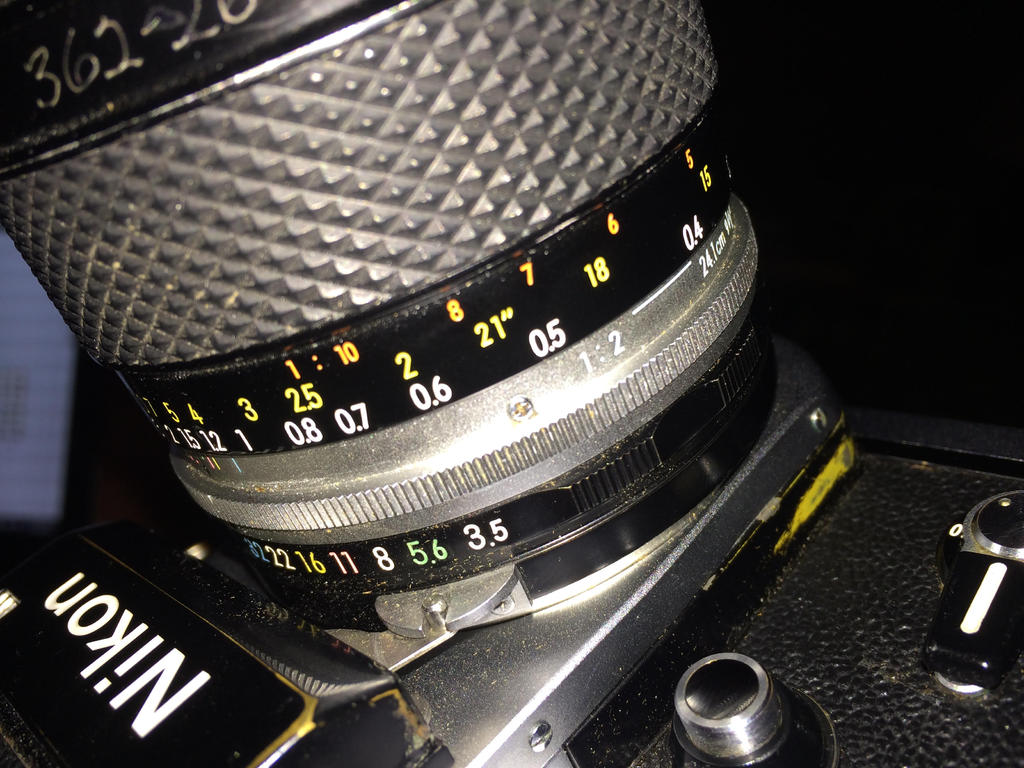

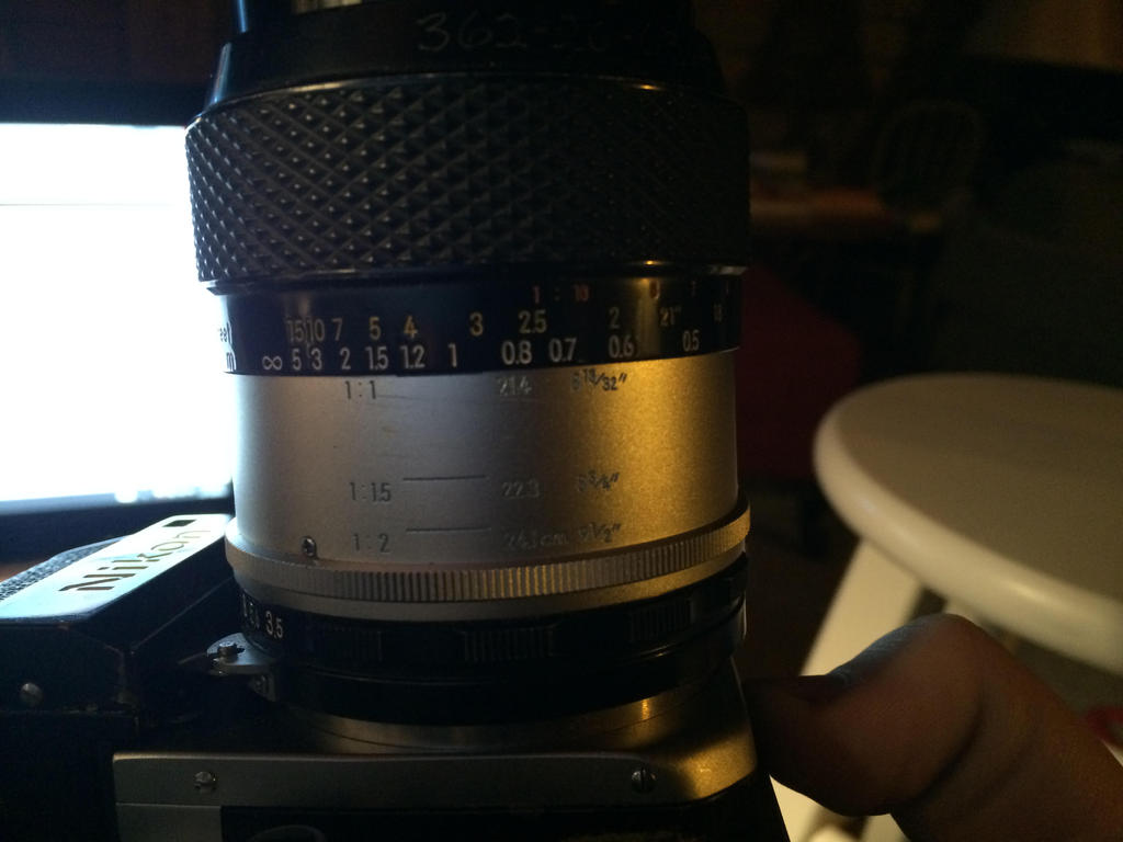

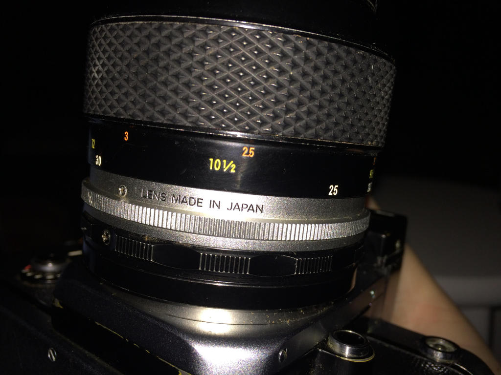

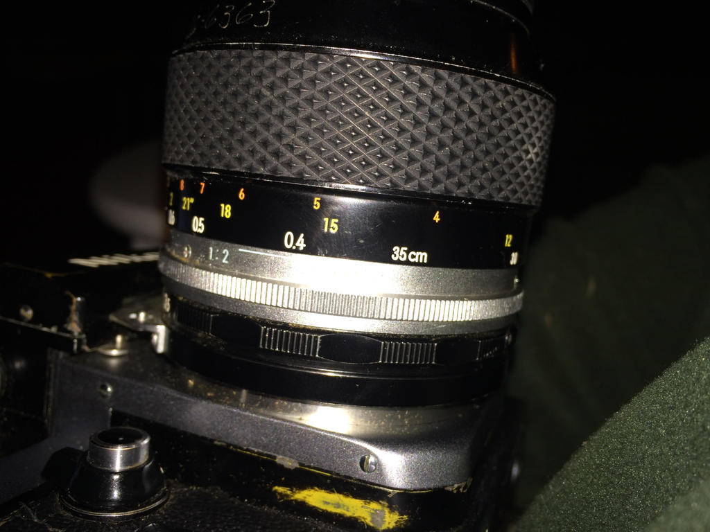

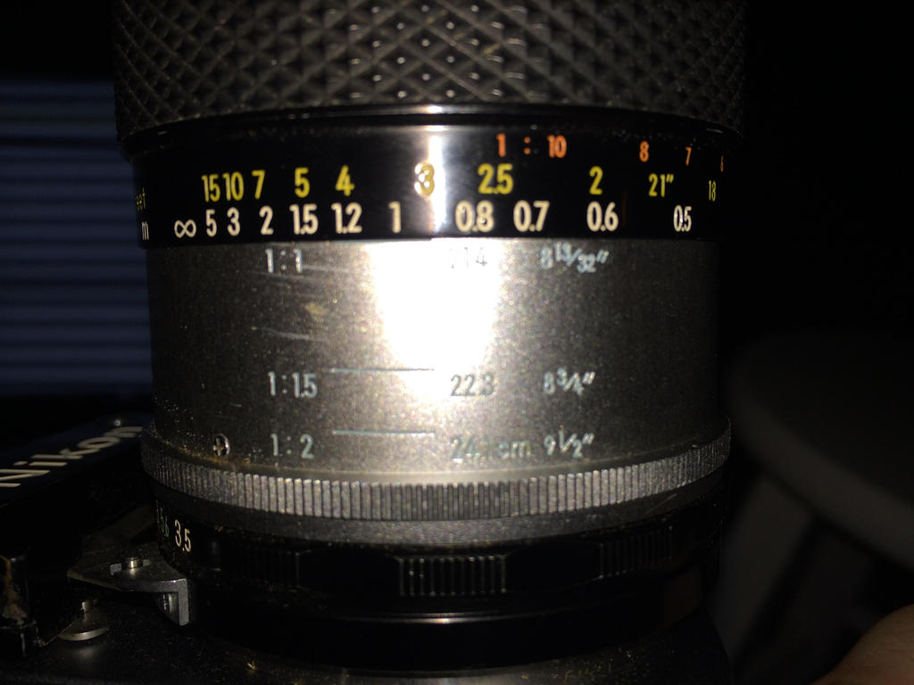

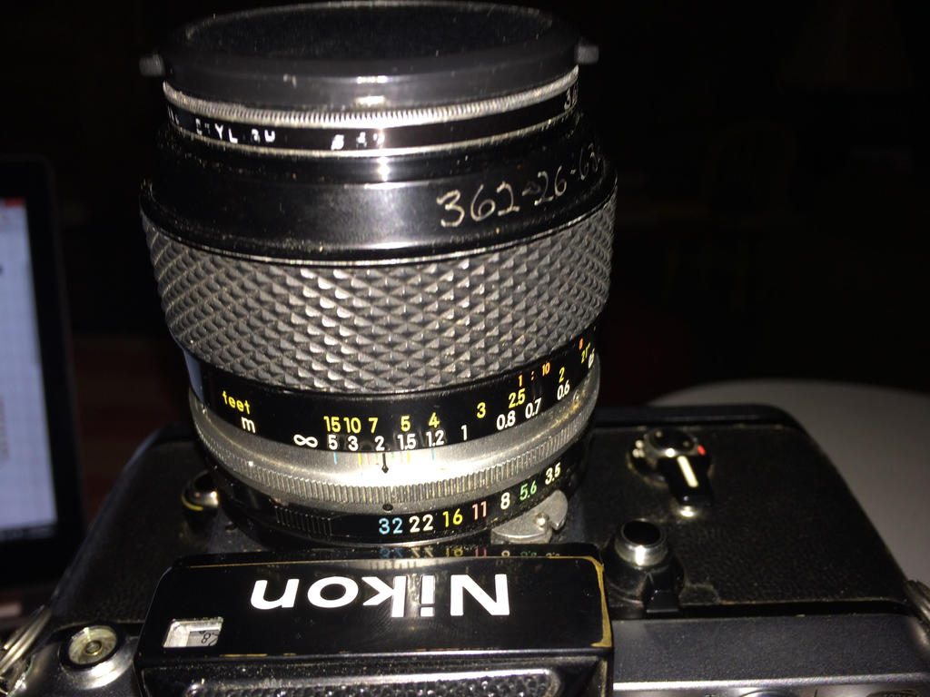

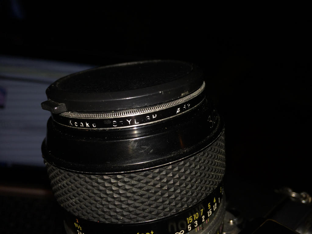

Sorry for this very amateur question, but i have an heirloom F2 and I am wondering what focal length the lens is. I think its a 50mm but I'm not sure. The aperture is f/3.5-f/32. Sorry, thanks
Eyelight
Any other markings on the lens?? If not maybe post a picture of it.
A rough idea could be had by comparing it to a known lens or using a zoom to match views.
f/3.5 would be pretty slow for a prime. Sounds like it might be a zoom. Either way there should be marking on the lens that will tell us exactly what you have. Read them and post them here. If you photograph it make sure you have all the markings shown
Michigandr
Haha, whoops. Its a 55mm. I knew I had known what it was.. It was hard to see in there with the filter/protector on there. Sorry for wasting ur time haha. Thanks. I want to get a fast wide lens. I looked on B&H but most things looked expensive. Could you recommend a place or certain lens that would be a good bet. I appreciate it
Michigandr
It is a 55mm f/3.5 Nikkor-P macro lens, pre-AI, about 1967. I have one, and every detail matches. It focuses to 1:2, and came with a M2 extension ring that takes it to 1:1.
The last lens on the page here
55mm f3.5 Micro-Nikkor-P Auto
Yup, thats it. It says it can be used for general photography as well. I dont have the extensions, would it still be used as a macro lens? What would it normally be used for without the extensions. thanks
