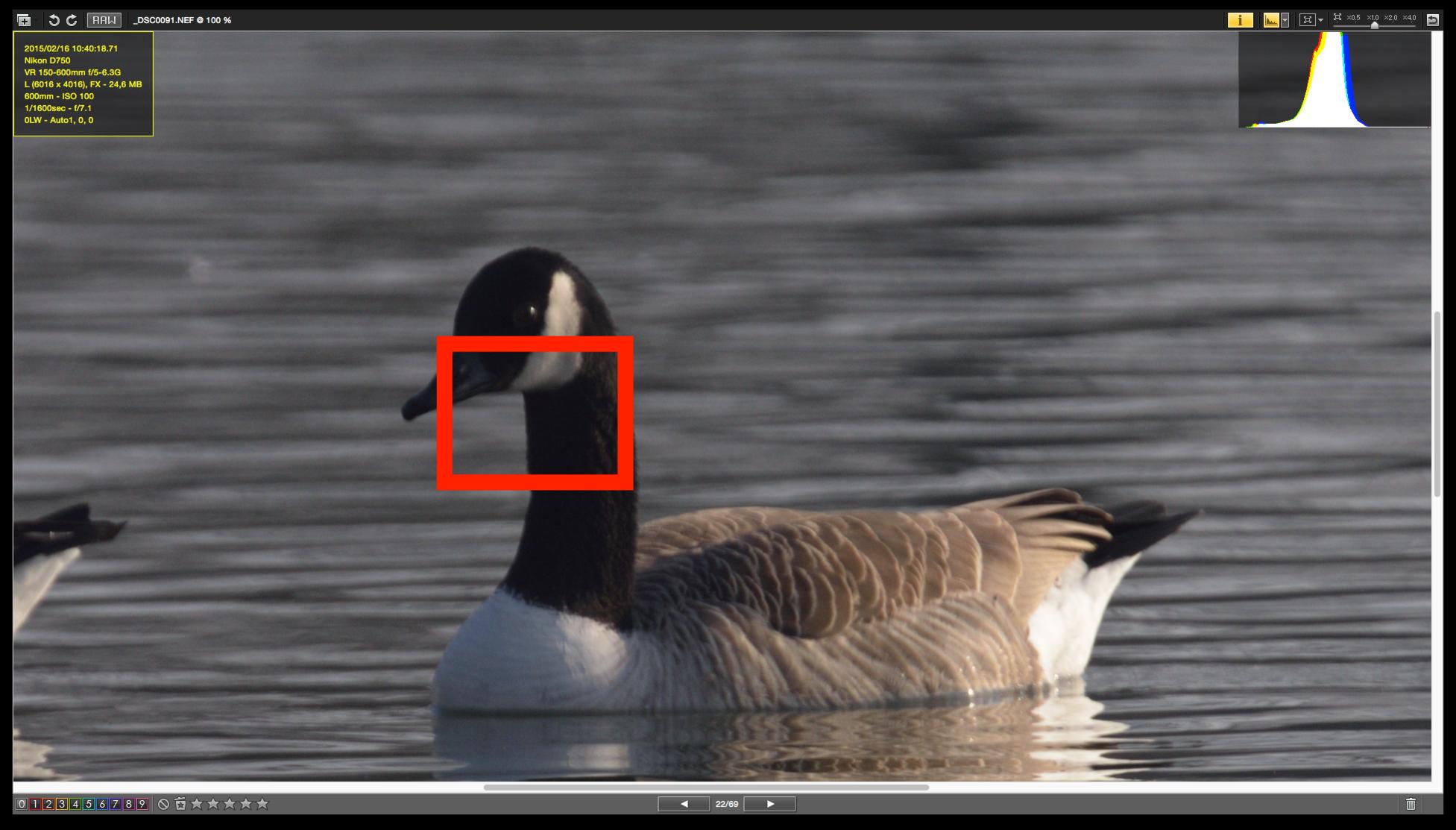

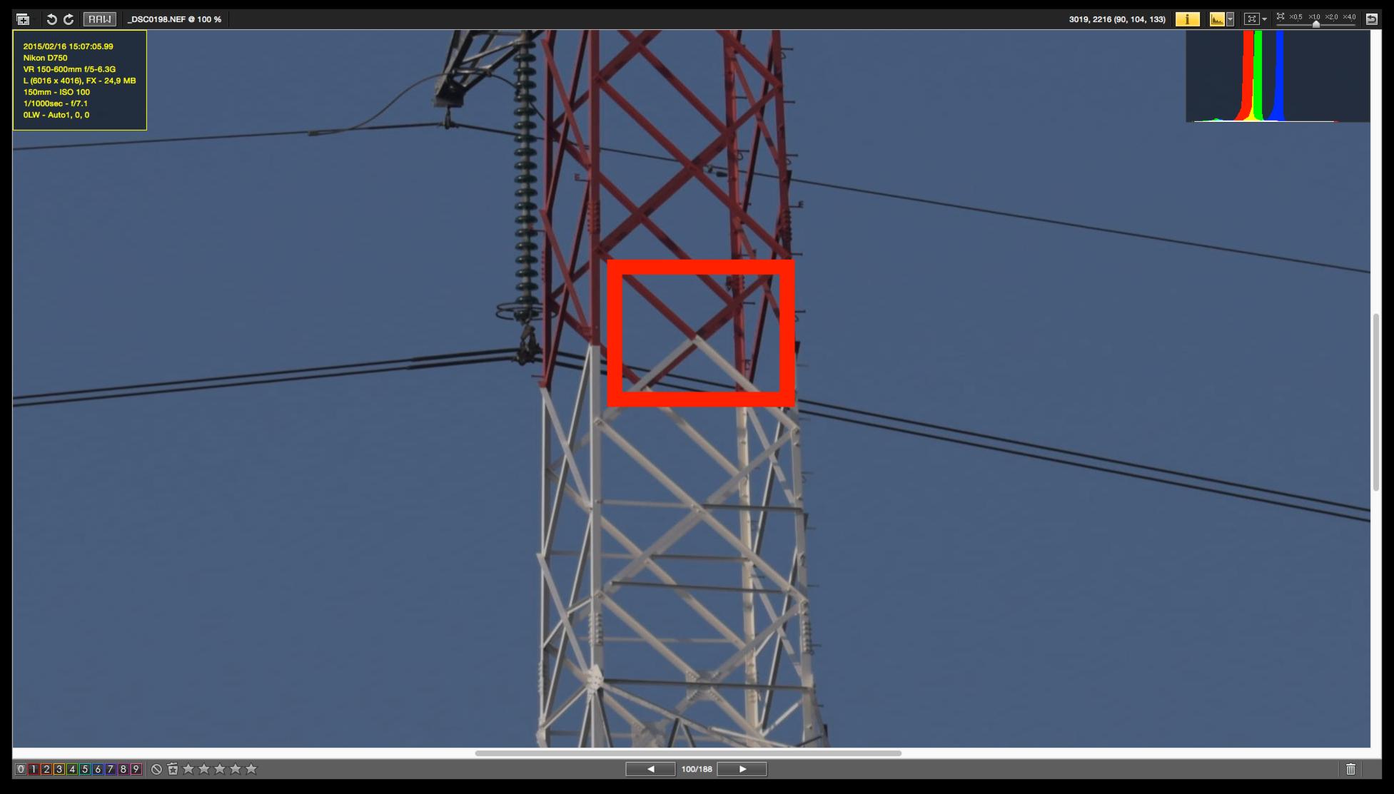

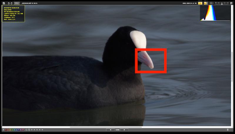

Sometimes for whatever reason it is as if the Tam forgot how to focus and hits it wrong very much. Today I lost too many shots because, when uploading and going through them, I noticed focus was hopeless. Slow shots could have suffered some blur but too many of my 1/1600s had the same issue.

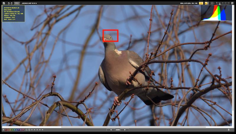

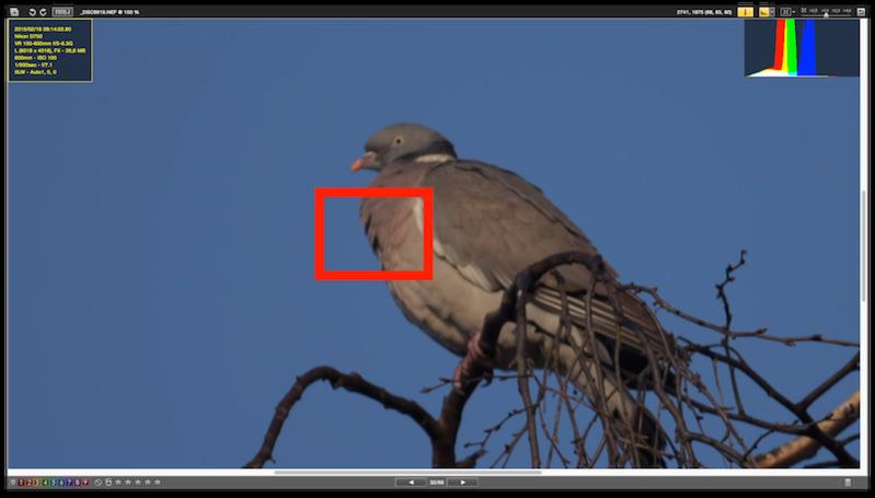

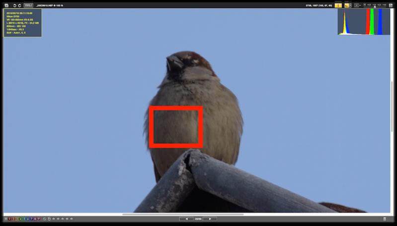

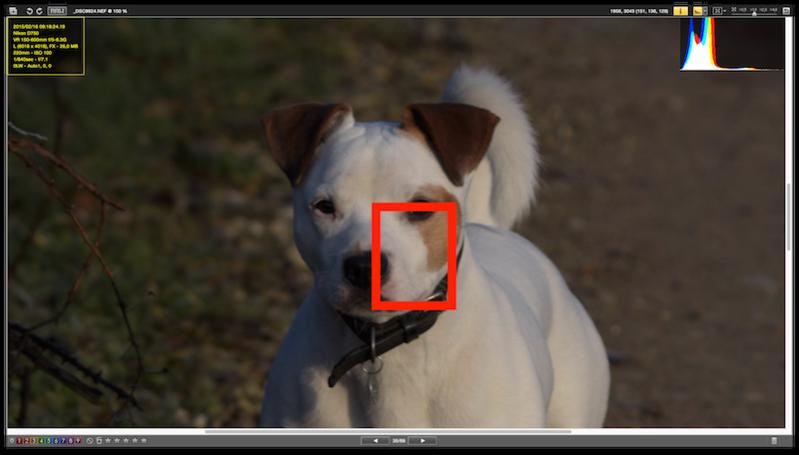

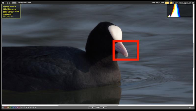

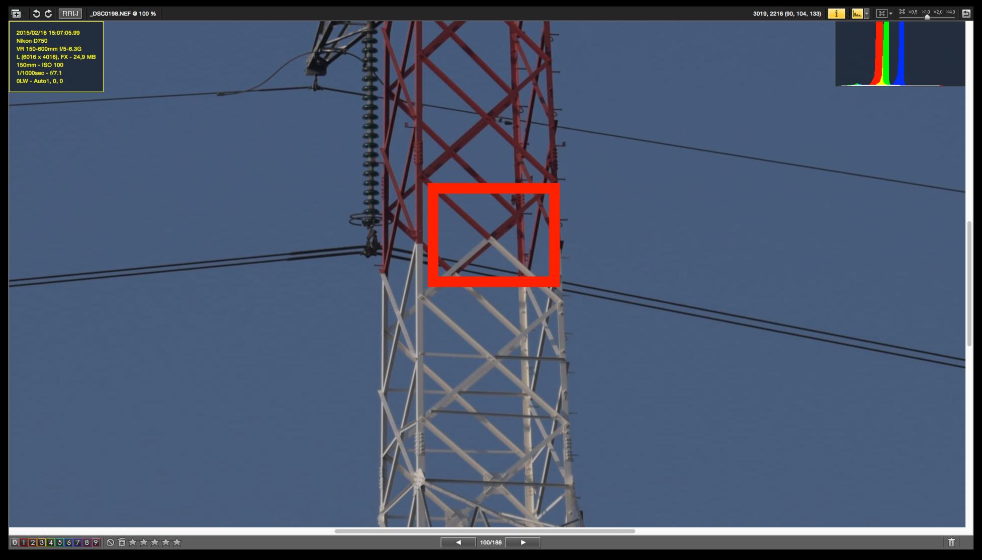

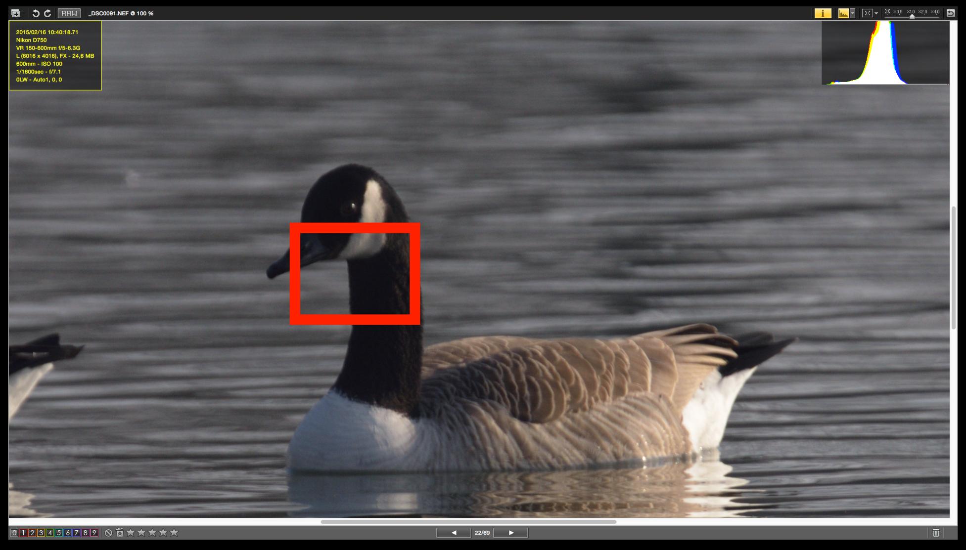

Here's some screen from View with the focus indicator.
I don't know how well it shows in these scaled shots but sharpness isn't anywhere it should be.

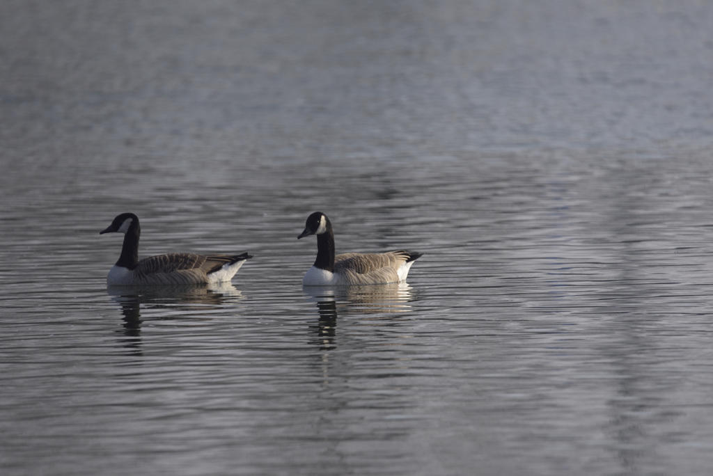

Can we have a higher quality copy of this one
You can have a print too but that'll cost you. ;)
I see where the focus is about in this one but I had plenty I couldn't even find something sharp.

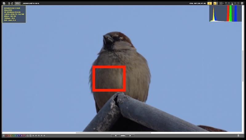

Here's one to rule out shake. There's plenty of contrast to focus at me thinks.
I took about 40 of these fellows since I rarely get them close. You know how many sharp shots I got?
Yeah, that many.
I almost wish it is a user error since that's easiest to solve.

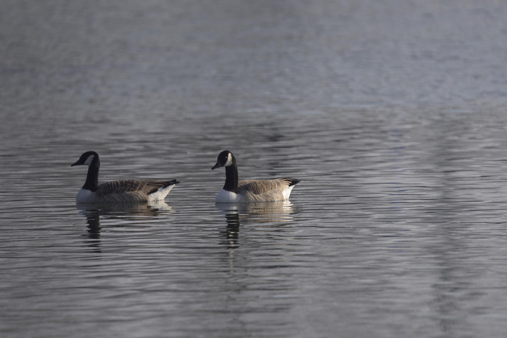

I'm just back from shooting and quickly ran through the shots and all is well again.
What changed? Nothing I can think of but the temperature outside.

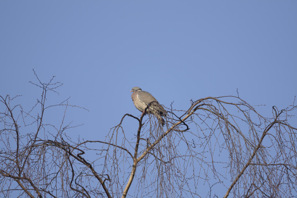

This is yesterday; http://nikonites.com/telephoto/24828-post-your-150-600-tamron-shots-46.html#post417239
This morning I could not get a sharp shot on distances I could throw the lens and hit the bird.
